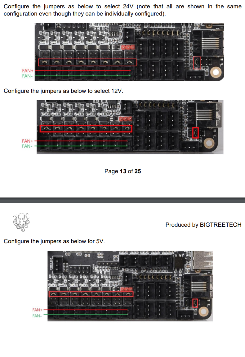

It is possible with the jumpers to differentiate the voltage for fans for example: Noctua 12 v. because I would like to put them on the bottom skirt and leave other 24 v fans, thus avoiding the use of a buck converter.
I was able to find this in the user guide for the Octopus. It looks like each fan can be configured individually for 5v, 12, or 24v. The pictures in the manual just show the fans all configured with the same voltage for ease of understanding. I think you should be good to go if you just move your fan's jumper in the right spot.
Edited by ahough
