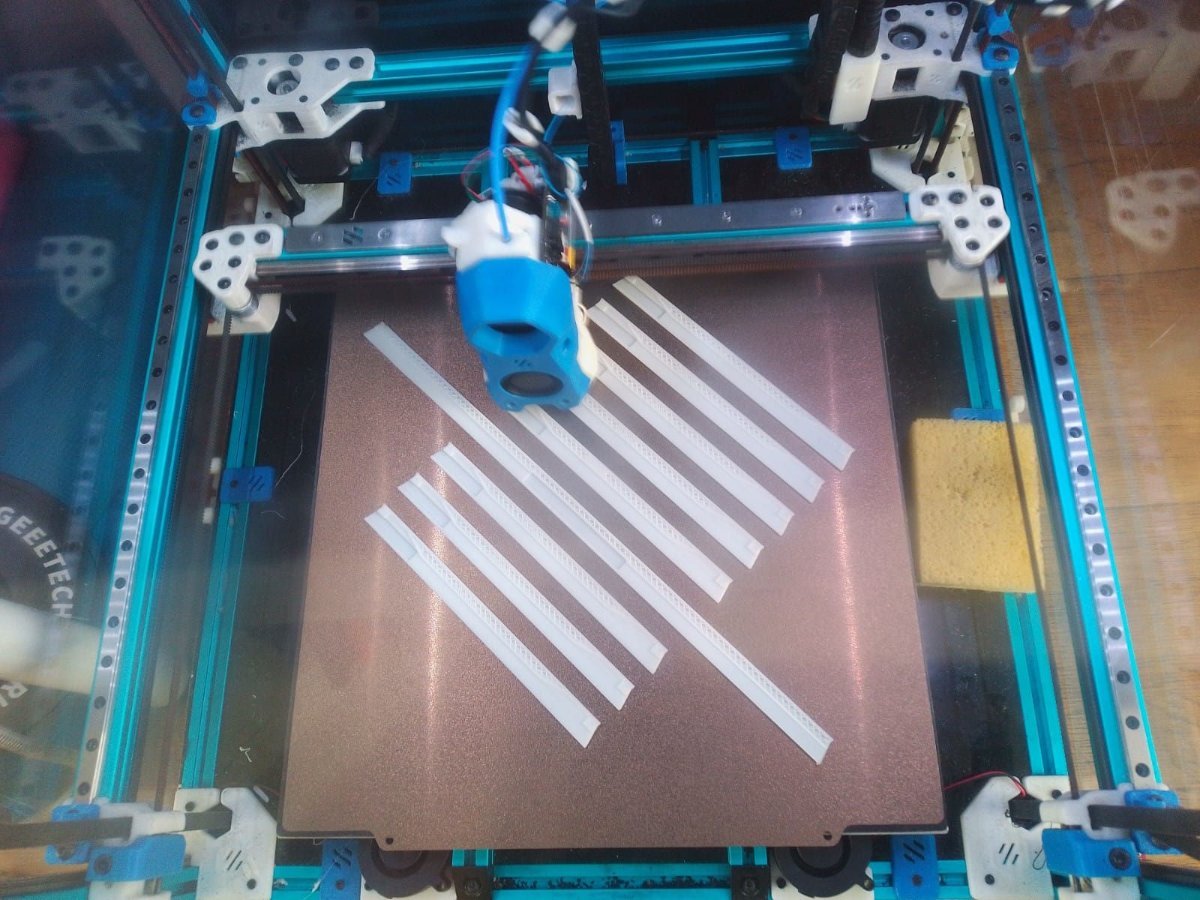

I used my Artillery Sidewinder X2, to print all my 2.4 parts for. I built a wooden box with a window for it before I put it in the garage for this purpose though... The Sidewinder X2 is a bed slinger and has a glass plate. The ABS I used would stick perfectly well and NOT warp by spraying the glass plate with a hairspray, cheapest brand I found in the local ACTION store (Dutch china-import cheap but ok stuff store, meanwhile all over Europe) before starting the print.
The hairspray caused corrosion at the cable connections / PCB at the Y extrusion on one side, which was kindly replaced by Artillery.
By printing PETG on that glass surface (without any adhesive), I have pulled off layers off the glass because of too much adhesion and not loosening after cooling.
PLA was never a problem on that glass sheet. It always stuck, as long as the plate was level.

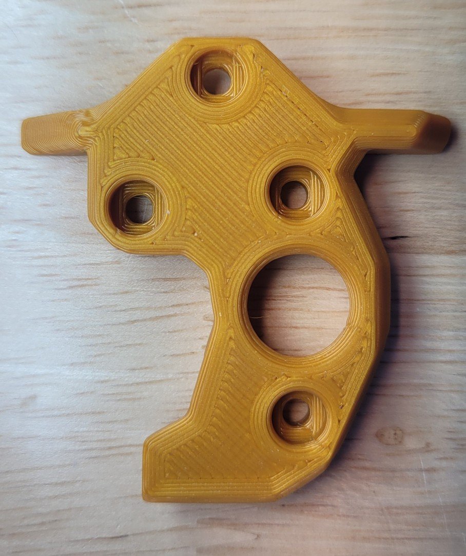

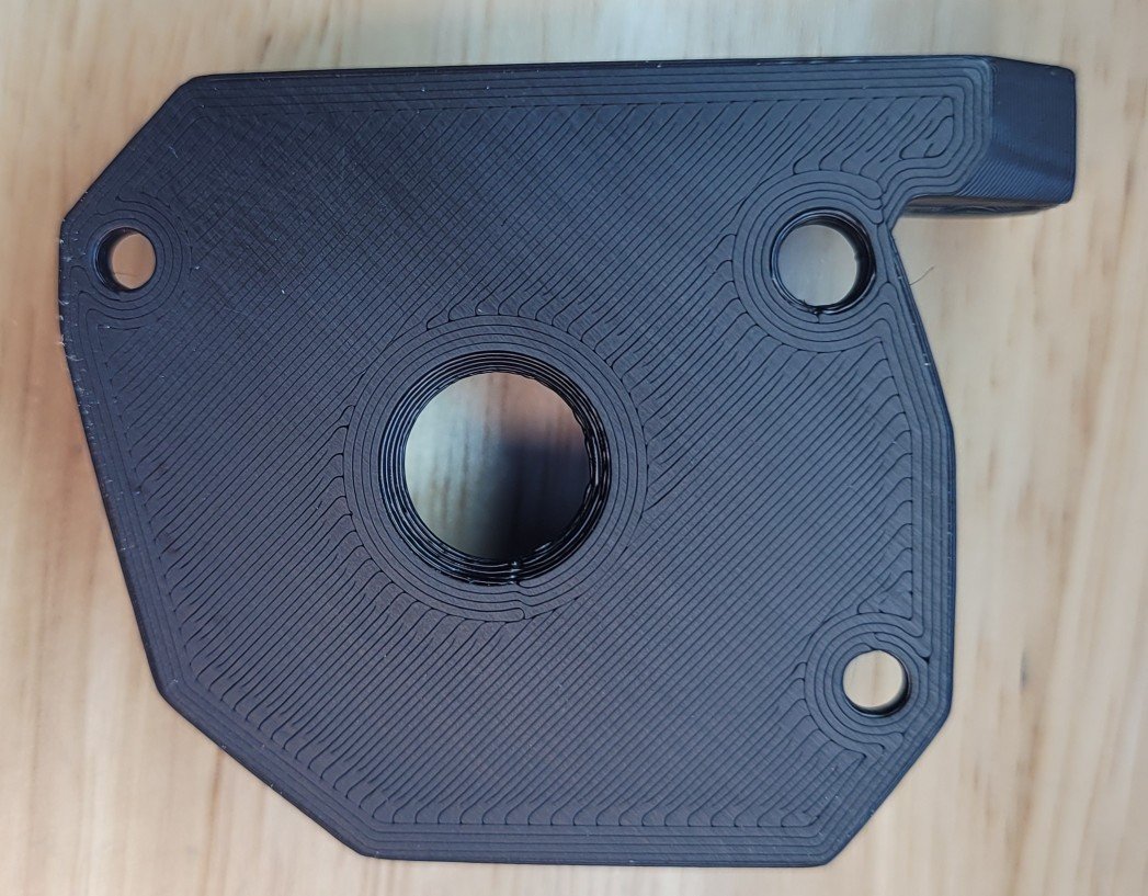

I have been using the standard PEI sheet that came with the Fysetc Kit. Actually I made so many scratches in it (a man has got to learn to adjust his z-offset) that I used it to glue a FR4 plate on top. I am saving that combination for the first time I am going to print Nylon.
I bought a 350x350 doubles sided textured PEI sheet from IdeaFormer (16 euros) and that one I have been using since last august. Since I have the backers in place, I have no adhesion problems. Except when I wanted to print larger pieces.
- Since I replaced TAP with Cartographer, I can print on the whole bed, without any adhesion problems, without the need for brims, rafts or any other goo stuff. Simply on the same PEI bed.
Once a while I wash my bed with dish-washing soap.
After every print I 'wipe' the surface with scotchbrite from LIDL (standard next to the bed).

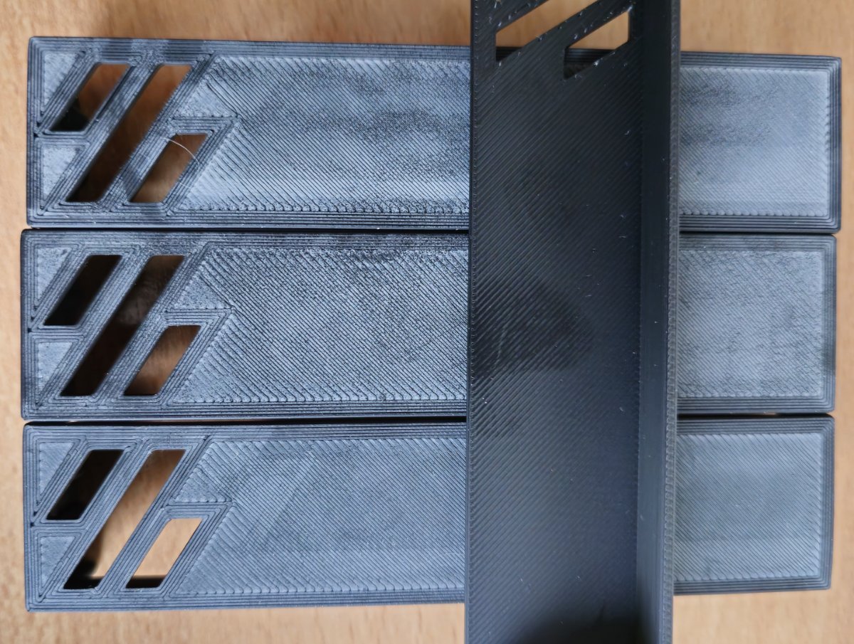

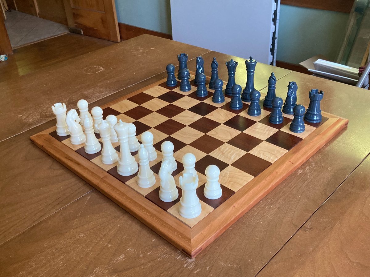

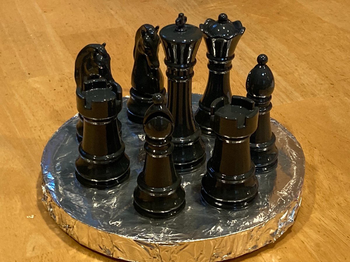

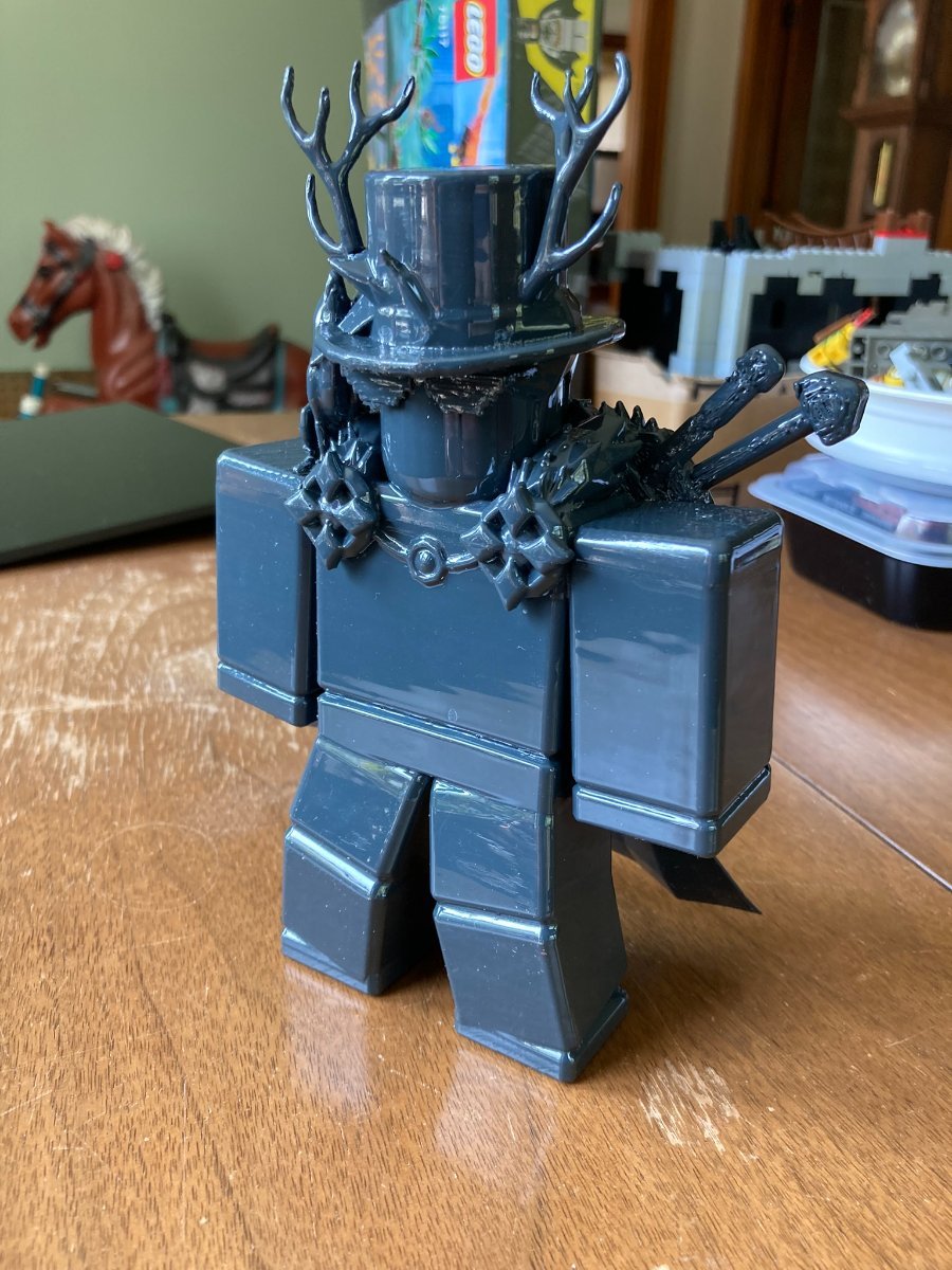

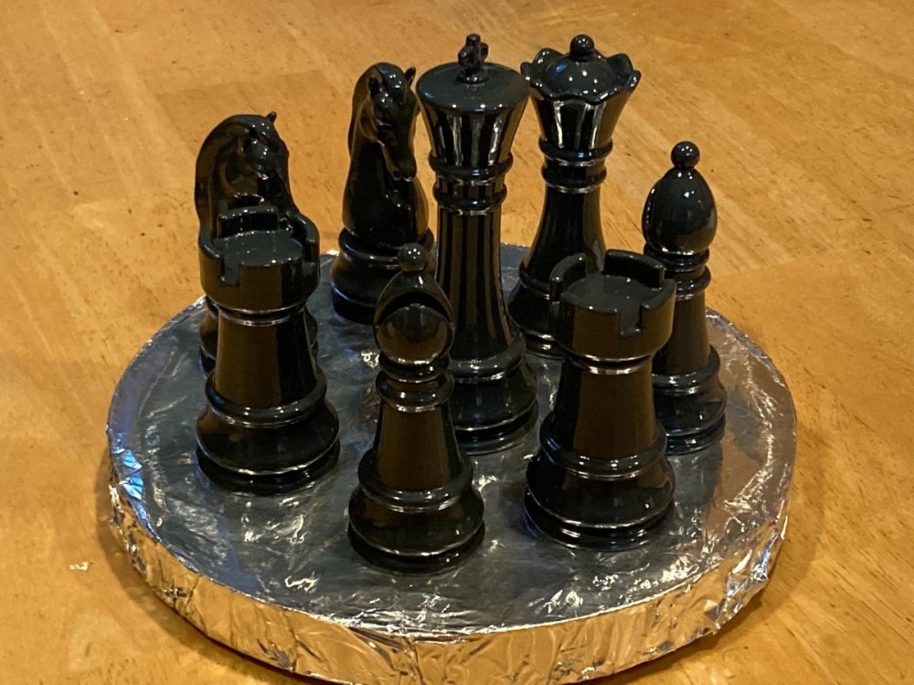

Acetone vapor smoothing works great with ABS. I made a chess set for my grandson using this method. The pieces look like glass. Also made a Roblox avatar for my other grandson using the smoothing method.

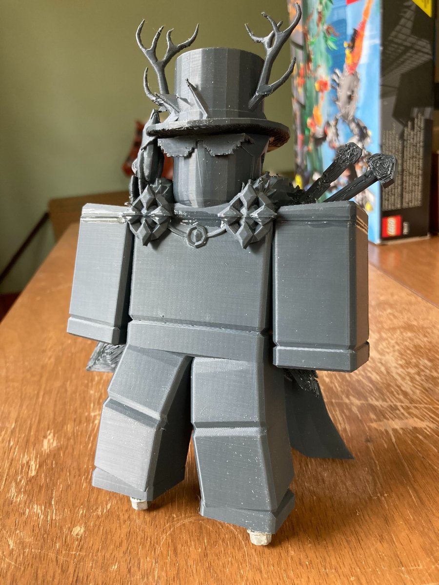

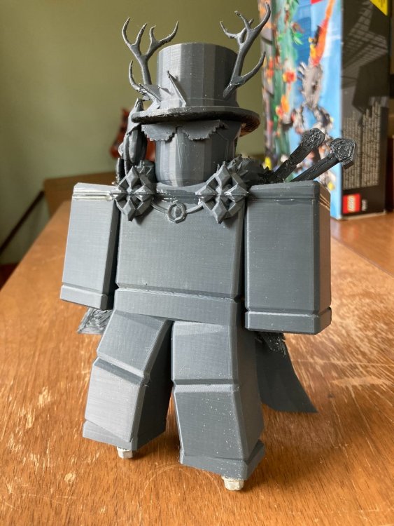

Print with 110 °C - no warping. Stuck very well. I attached a picture from the "grey" bottom. Black esun abs+

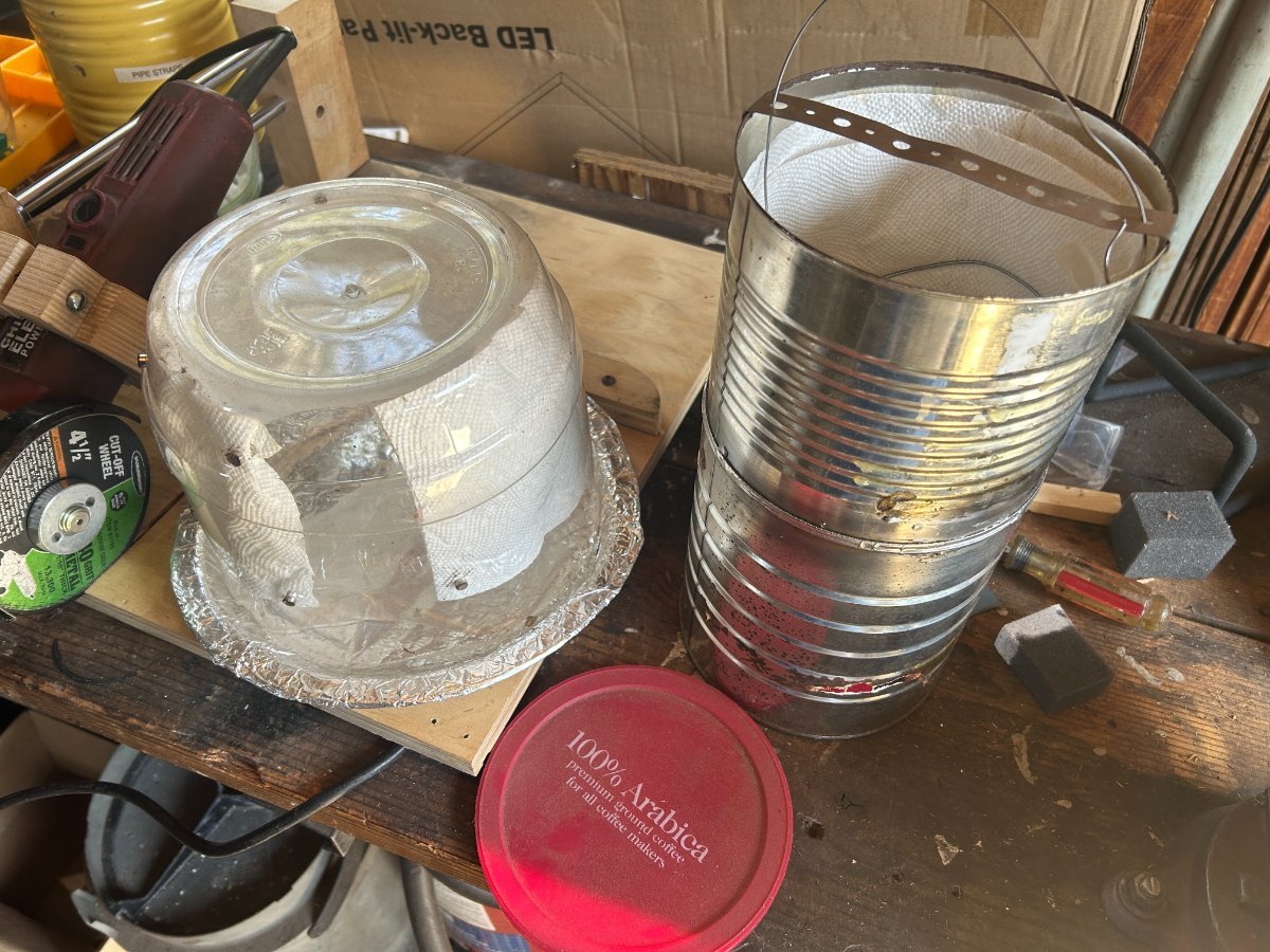

In the words of Pitch Meeting on YouTube, "Super easy, barely an inconvenience!" Find yourself an acetone-proof container that can be easily be sealed. Make a platform, or rig a way to suspend your part in the chamber. It's important that your part does not touch anything during this process. Line the sides of the inside of the container with a layer or two of paper towel - you can use magnets in a few spots to hold it to the sides.  If using a plastic container, use magnets inside and outside like a clamp to hold the towel in place. Soak the towel completely with acetone, and lower your part into the chamber and seal it. Wait about an hour - this is a trial and error sort of thing, bur I found an hour to be about right. When satisfied with the smoothness of your part, carefully remove it from the chamber and set aside to dry. Do not touch it until it's thoroughly dry. Voila! Smooth part!
My favorite chamber is a recycled pretzel container, because it's clear and you can see what's going on inside. I cut the bottmhalf off and use it like a bell. Also, I like to do this process outside, in my garage, with plenty of ventilation. I would not recommend doing this in the house.
