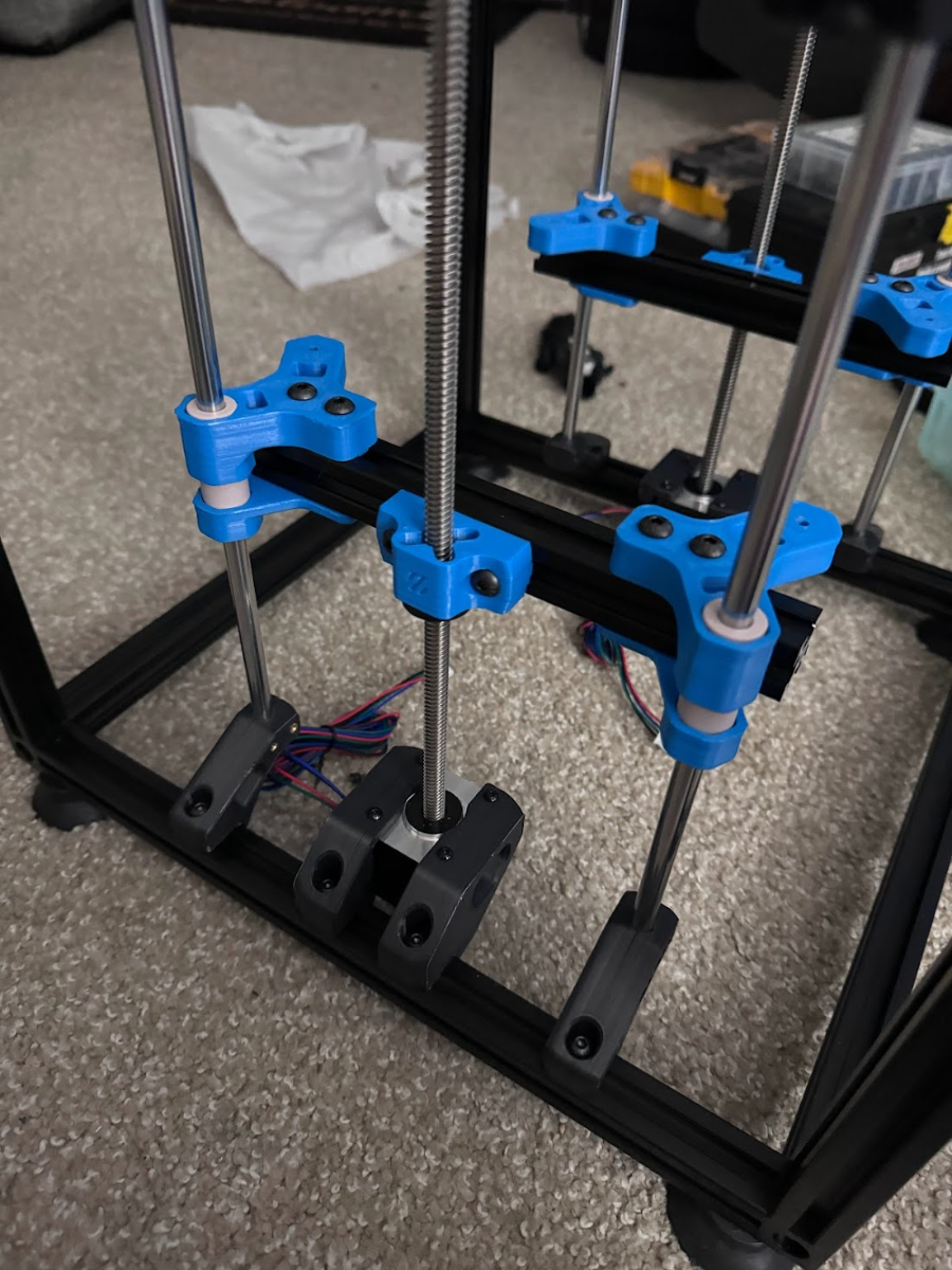

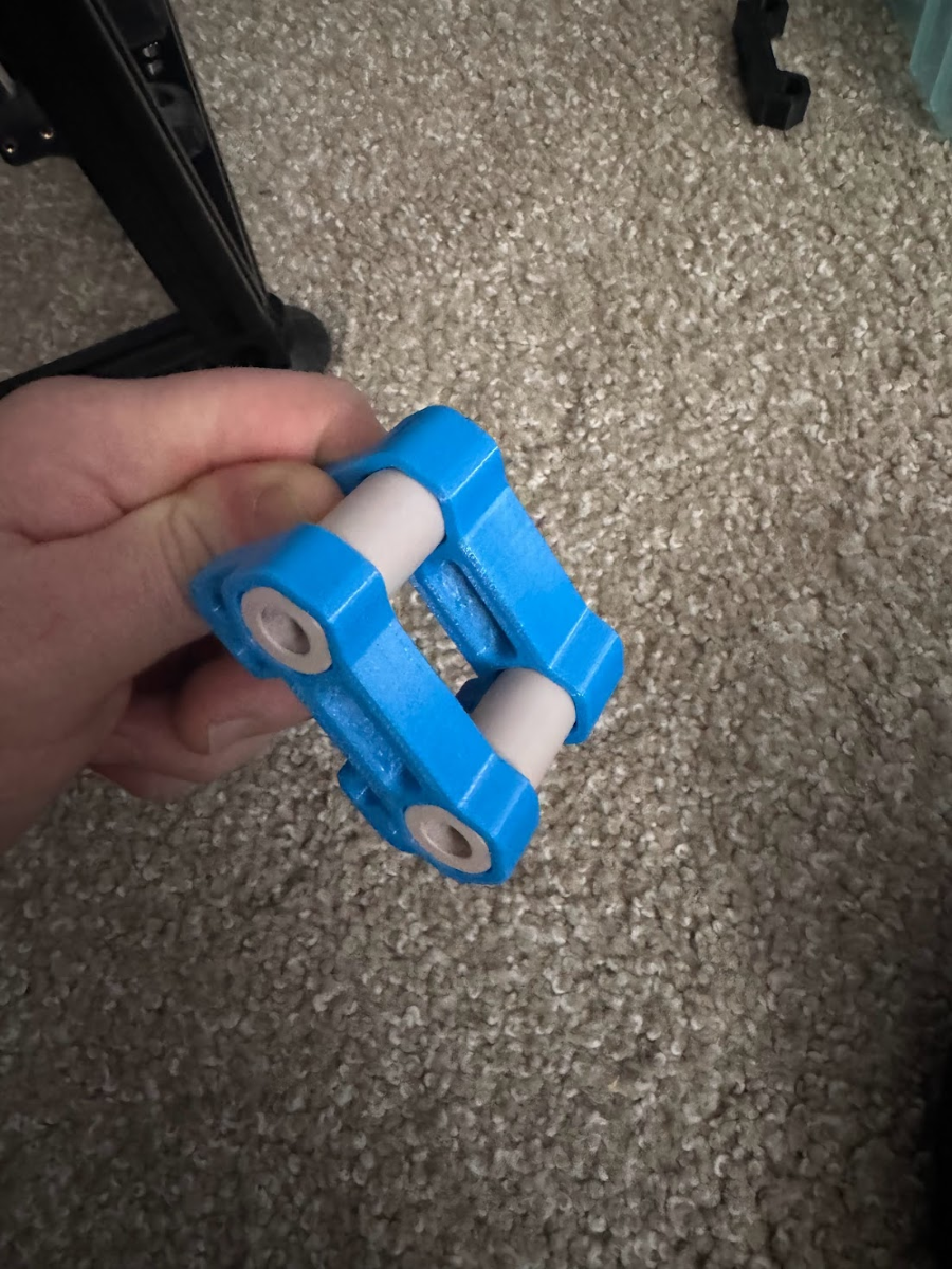

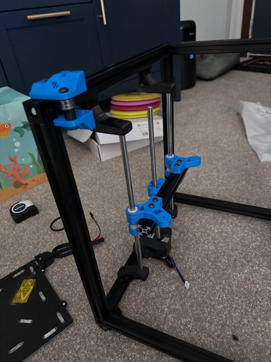

Joined up partway through my Voron Legacy build and will try to post to catch up to where I'm currently at.  Plan for the build is a 185mm^3 build volume using a Prusa mini build plate.  I chose to go with the Legacy to use old parts that I had, as well as the nostalgia of running linear rods.
Current build plan includes
  • Prusa Mini 24v Build Plate
  • Carbon Fiber Rod X axis with Vesconite bushings
  • LGX Mini Stealth from atrushing
  • FYSETC Cheetah V3.0
  • Orange Pi Zero 2W
image.thumb.png.ed931bb1882982885abfc6f59dc8a37d.pngimage.thumb.png.eb63dba0c2d4419cf7762c2296938103.pngimage.thumb.png.61f7d607d732e5925e213a39daa52158.png

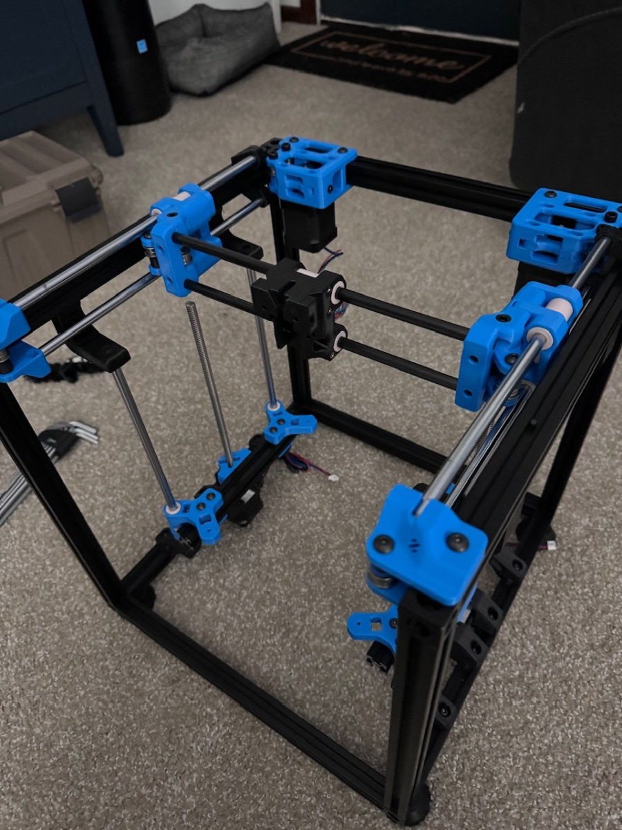

Made some more progress and got the X and Y axis assembled.  You can see my beer fueled mistake from this weekend in the picture…had the XY joints facing the wrong way at first.IMG_1603.thumb.jpeg.d745487c41beb3a7a88abdcc9cb7a014.jpeg

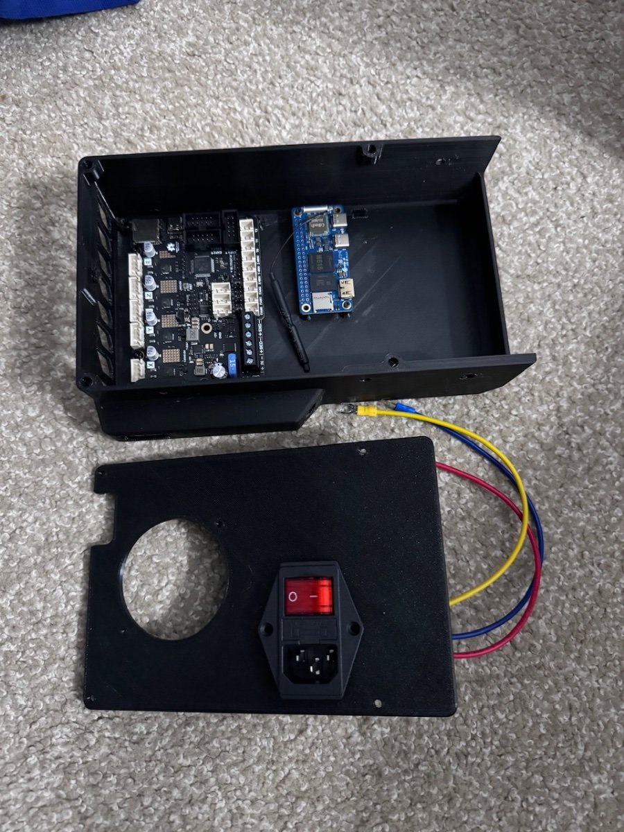

The Neptune 4 was busy printing the electronics enclosure overnight.  Cheetah and Orange Pi bolt right up!
