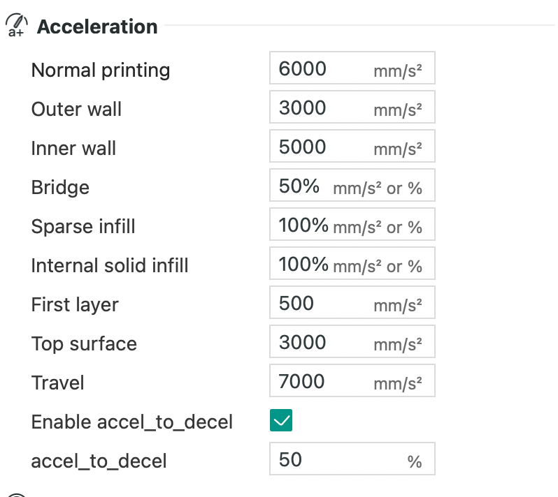

Wonder if this has something to do with it. This would be a setting in your slicer profile. Might be worthwhile disabling it and see what happens. In Orca slicer try  UNTICKing this box:

The "Unable to parse" is commonly a slicer error. Some G-Code that klipper cannot read. I may be wrong. But can also be due to the value being in the config file as @Penatr8tor eluded to.
