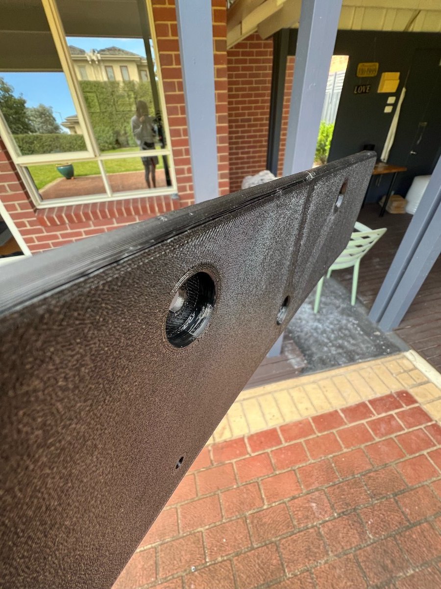

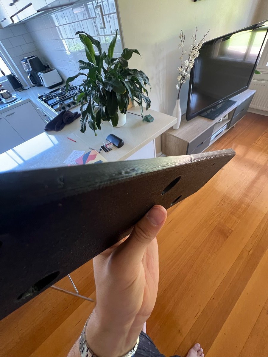

1. My first problem shown in the photos below is where I get the squiggly lines on the overhangs on a rounded edge with a radius of 4mm near the start of the overhang that's roughly the 2-5 layers. Would greatly appreciate any tips on how to get this better, I've fiddled with wall overlap percentage, overhang speed, fan settings and nozzle temperature but nothing seems to work. The first two attached photos correspond to this problem

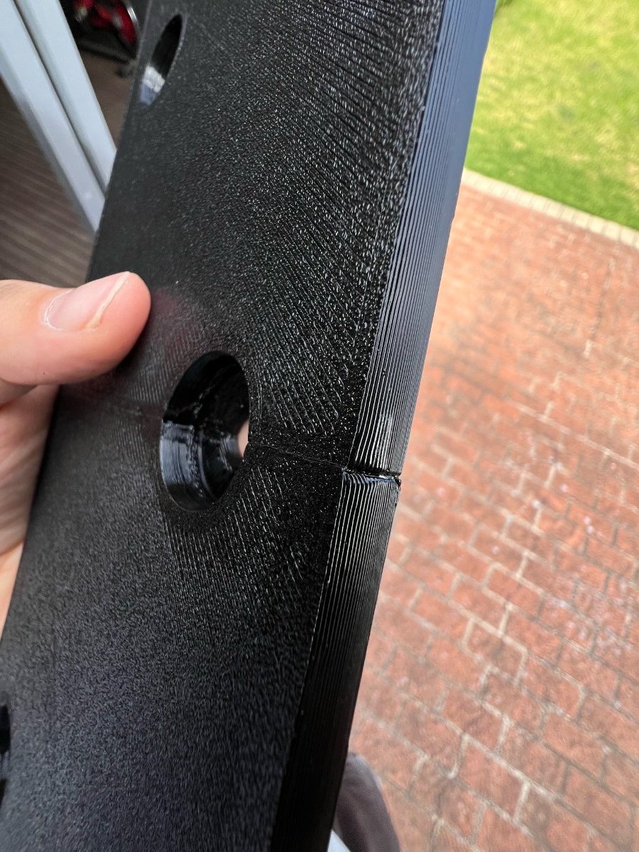

2. Secondly the corners of the cut in the print have really low quality, and when joined leave a gap. I've tried changing the material pressure advanced k value and speed. Any ideas on how to fix this would be great.

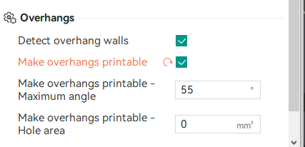

You my friend are running into the fillet wall. If you have CAD then remove the fillet and replace it with a chamfer. If you don't... and you're using Orca Slicer... you can click the "Make overhangs printable" box, under the "Quality" tab. This creates a little chamfer for you. If you don't have Orca... then look for something similar in your slicer.

Unfortunately the design needs to have a filler and not a chamfer. I’ve tried this setting but it ruins the design, so I was wondering if there are other remedies
