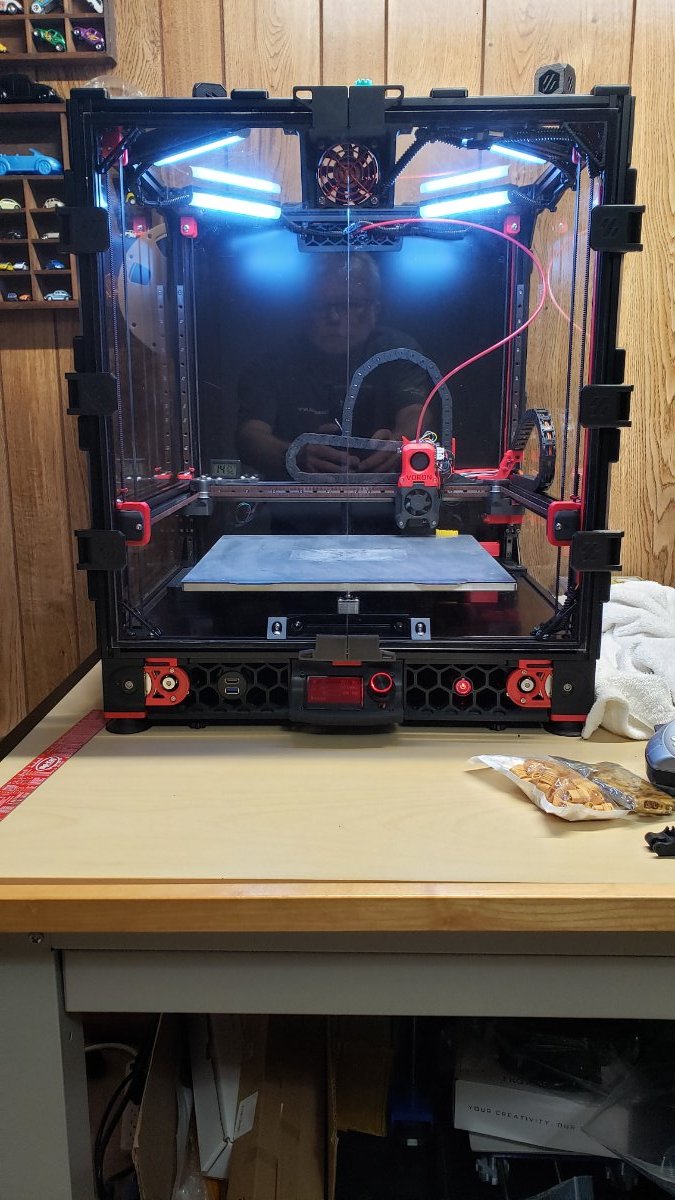

I've attached the file for my V2.4.  It's working really well but I've got a couple of things that are still under development (some of the test stuff might be in there). I've done numerous test prints to measure resonance and apply some input shaping so you'll see the results in there - still need to hit it with the accelerometer for the final tuning that gets away from my interpretation and goes with hard data from the printer.
All the tunings are going to be specific to your printer - there aren't really that many of them and as you follow the initial Voron startup instructions, you'll work them up as you go.  It sounds like you're putting down a solid base to understand what you're looking at when the time comes but you'll work up a lot of the offsets, PID values, etc. as you go through the process so don't get worried about that.
I've added a Nevermore filter, a chamber fan at the top of the front opening to circulate air in the chamber for more even heating and to roll air out when printing PLA with the doors open, I've got a nozzle brush with a purge tray (still need to finish the purging code), plus some RGB LED lighting, and numerous extra temp sensors including an electronics bay and a chamber temp sensor as well as collecting temps from the Raspberry Pi and Octopus Pro.  You'll see tidbits about that in the config file when you scroll through it.
I've done some bed meshing and this thing is laying down ABS like a boss.
It's not my first 3D printing rodeo but it is the best rodeo so far and I'm really happy.
I tell people it's a Voron and then have to tell them, it's not a company, it's not even a kit, it's a design and people build it to the general design and then customize from there and their heads explode - but they can dig the quality of what comes out.
printer.cfg
Here is a shot of what it currently looks like.
Visible mods including the chamber fan, reworked front skirts to include a power switch and an HDMI / USB connections to be able to get directly to the RPi without having to disassemble things.  One of the rear skirts has a panel mounted ethernet also going to the RPi.  The lighting I did myself using diffusers from some aluminum extrusion for LEDs I bought on Amazon.  There is a BTT Smart filament sensor in the rear which is wired but not yet configured.  It also uses the Mandala Rose kinetic mounts - super nice. For that reason my Nevermore sits sideways on the left side because it can't get out in front of the bed like the standard bed mounting strategy.
Mechanically corners are gusseted for rigidity and I need to re-tune my resonances after doing that.
There it is, V2.2874
