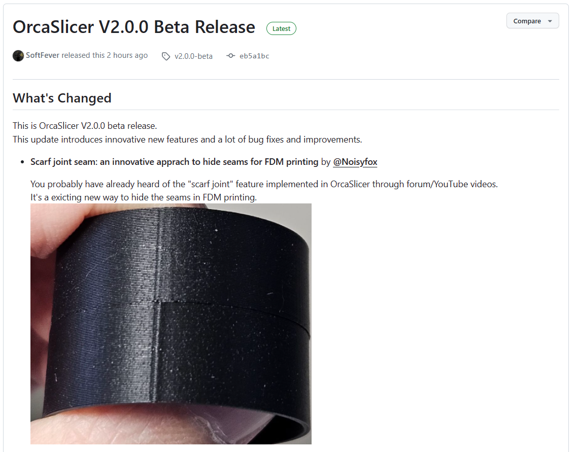

So, this is something I want to try. The Orca Slicer team is working on a feature called Scarf Seams that aims to eliminate seams by creating a scarf like joint.
It's still pretty early in the development cycle but looks really promising so far.

FWIW... this feature is still in beta testing and not available on the released version so bear that in mind when diving in. That said, there are still plenty of good reasons to give Orca Slicer a try.
FYI Everyone... It's now officially in BETA. There's also a bunch of new settings and fixed as well.

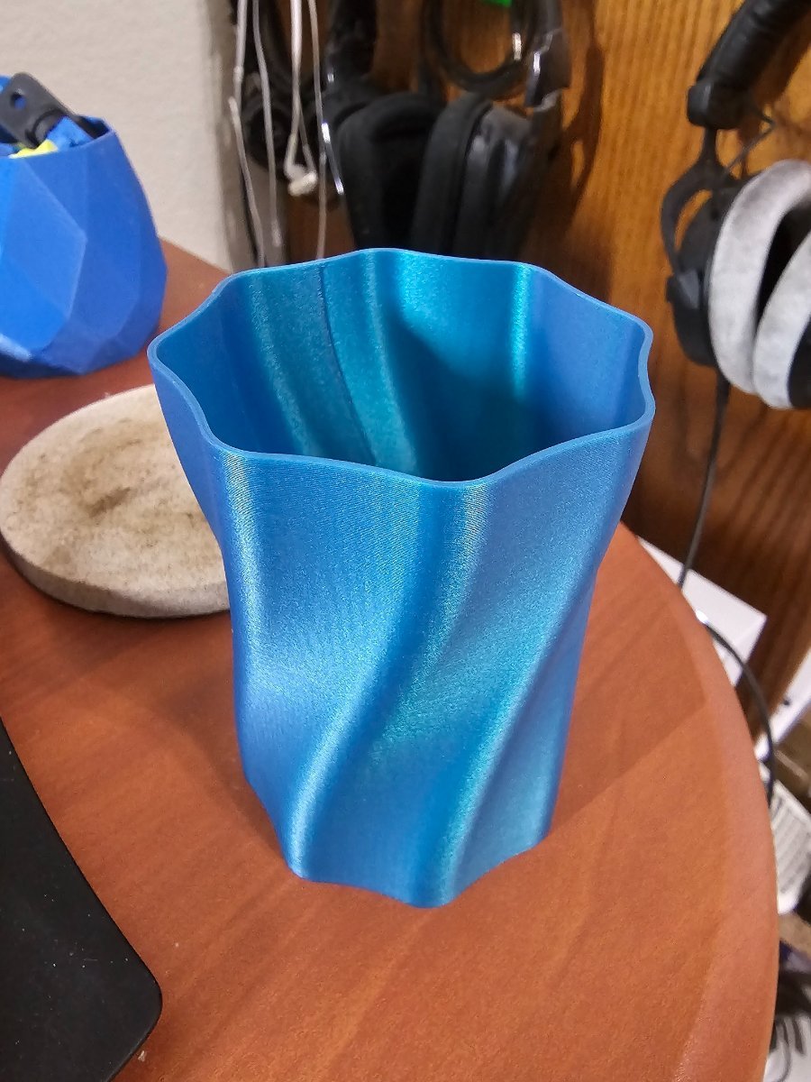

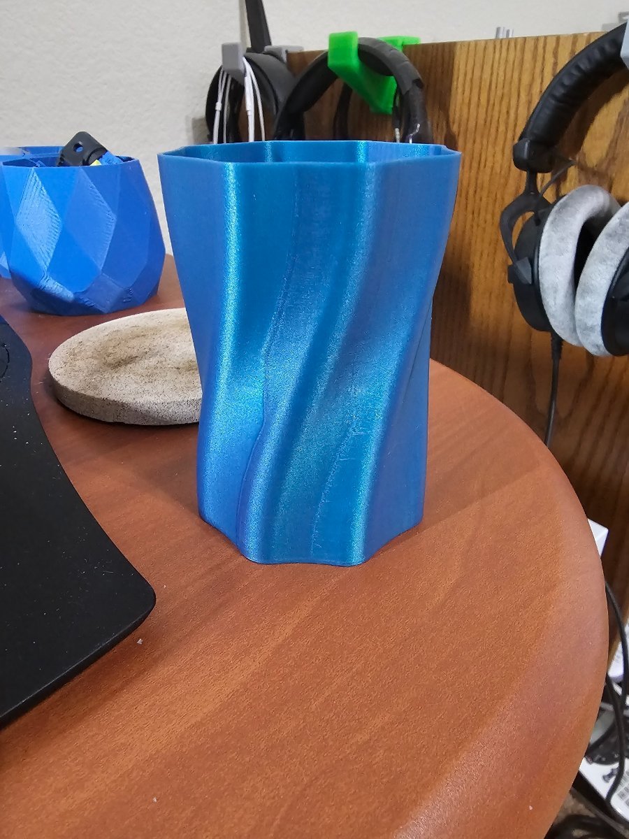

Thought I give the scarf joint feature a try.
I tested the feature on a cup shaped part with no sharp corners.
This is the scarf joint on the outside of the cup. You can definitely see where the joint overlap begins and ends. I believe the length was 80mm
Below you can see a normal seam on the inside.
It's not perfect but, given this material is pretty unforgiving... It's not bad IMO.
