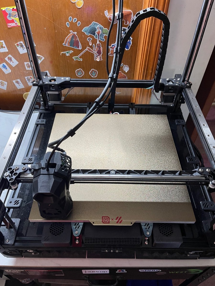

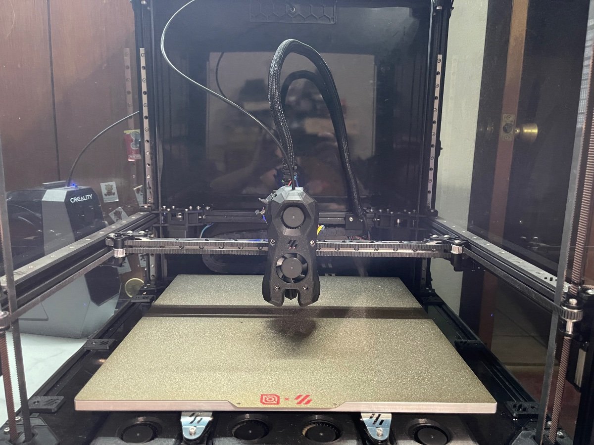

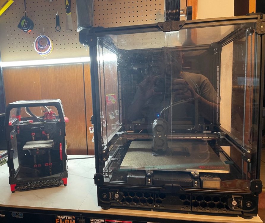

Few upgrades on my 350mm 2.4
Ran great mostly stock aside from Klicky for a long time. Printed all the parts for my VZ235, VZ330, RatRig 3.1 and Minion.
I decided to keep my 2.4 and 0.1 and sell all my other builds. My VZ builds, RatRig builds were never as reliable as the 2.4 and I just don’t have the time or more so didn’t wanna make the time anymore. May do a K3 and that’s about it.
I did go Tap and added a NiteHawk a bit ago along with the BFI and BZI mods. They have all been excellent additions. I have decided it is time to give a little more love to the 2.4.

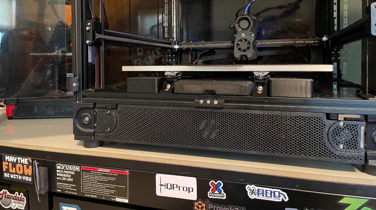

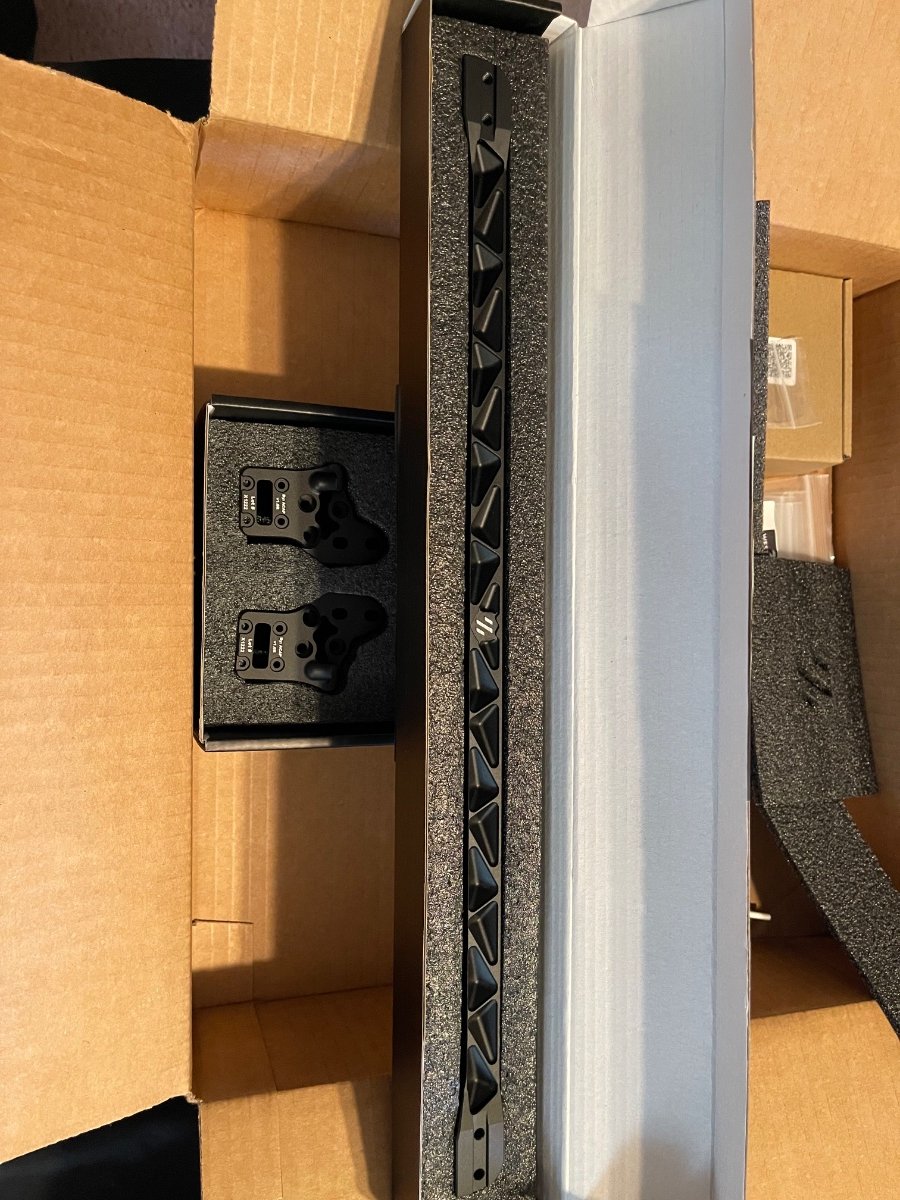

Elite Machined Ultralight X Beam with CNC XY Joints

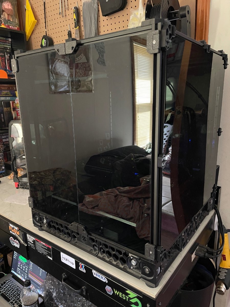

Mandala Rose Works Tinted Panels

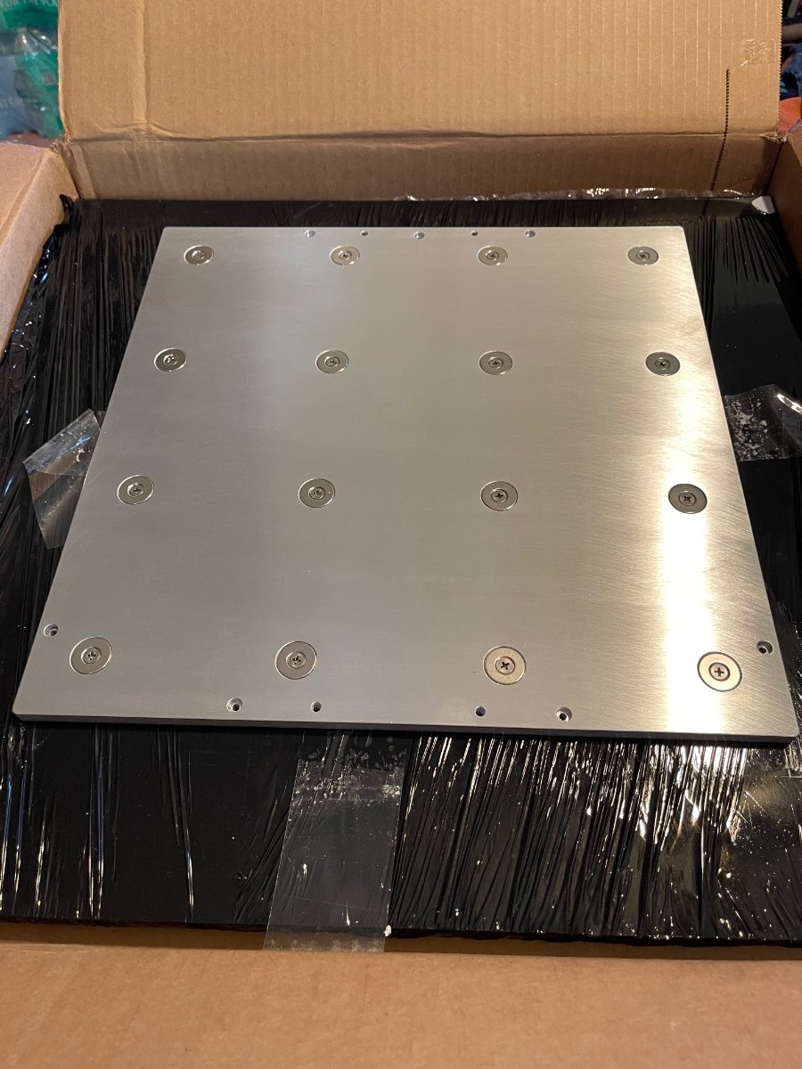

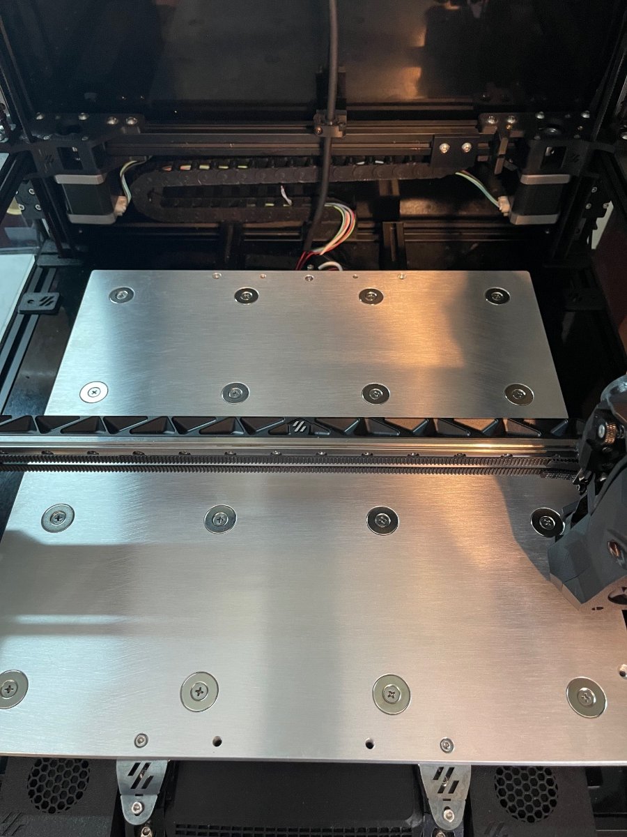

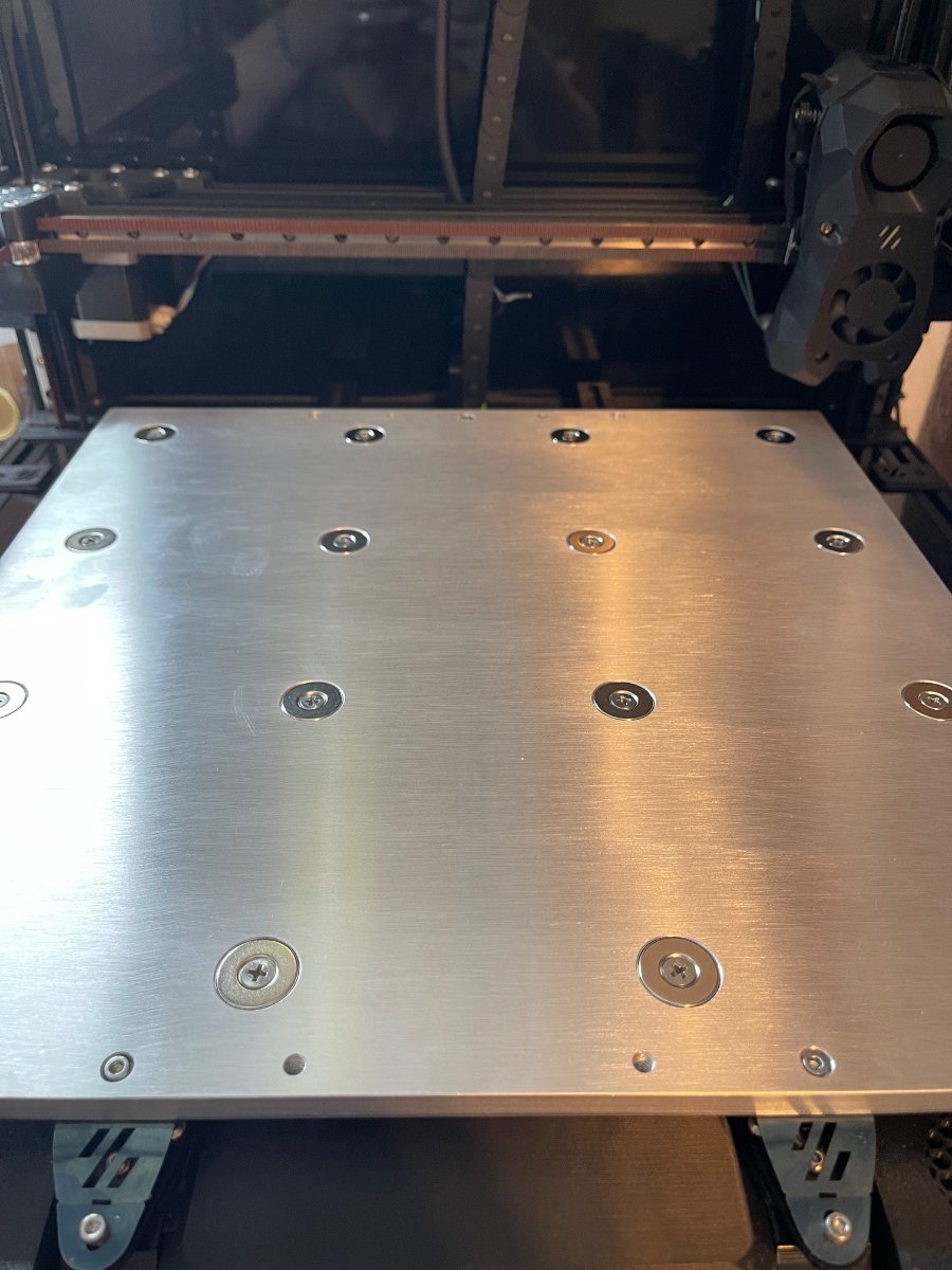

Mandala Rose Works MagBed

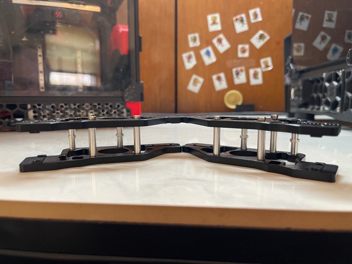

Aluminum A&B Motor Mounts

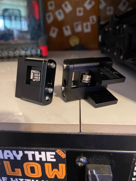

Aluminum BFI
Lots of miscellaneous for upkeep
LDO 2804
BTT 5160T Pro
AWD aluminum motor mounts
Galileo 2

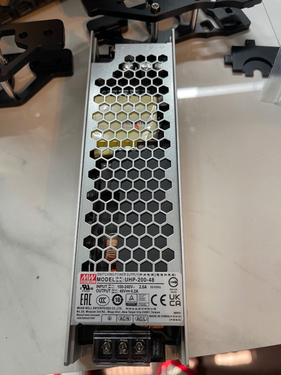

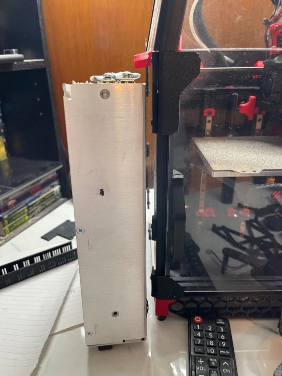

UHP-200-48
EBB36
LDO 2504
HoneyBadger Rails
Rapido 2 UHF

Still waiting for quite a few packages. I figure I only have time for one main hobby anymore. Anyone interested in buying some FPV drones. 😂 More on another wall with a ton of spares.

Ordered some Provok3d cnc motor mounts and then decided I wanna go AWD so I ordered an AWD motor mount kit from West3D, 48V PSU, four 5160T Pro and LDO 2804.

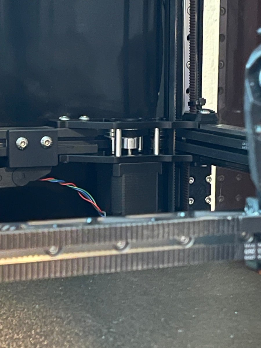

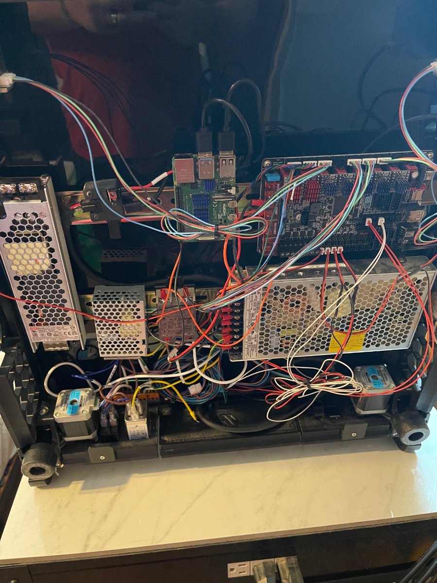

Gonna try 2wd with the 2804 on 48V first. So far speed and acceleration has increased quite a bit with no loss in quality. I really like the Aluminum motor mounts. Maybe I will get around to building my Galileo 2 this evening.

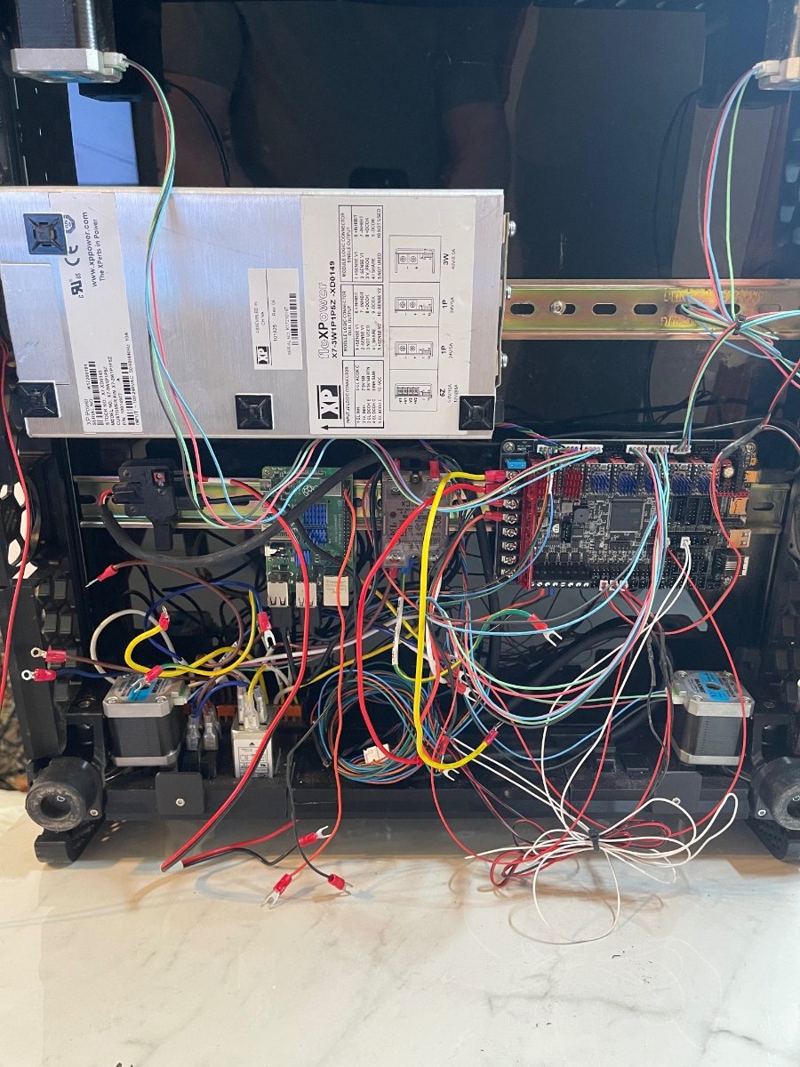

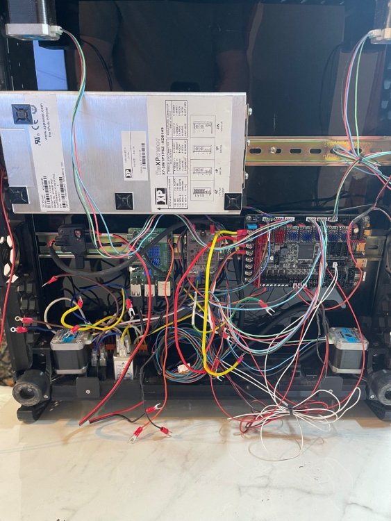

Ignore my wiring. 😂 I will get to it eventually.

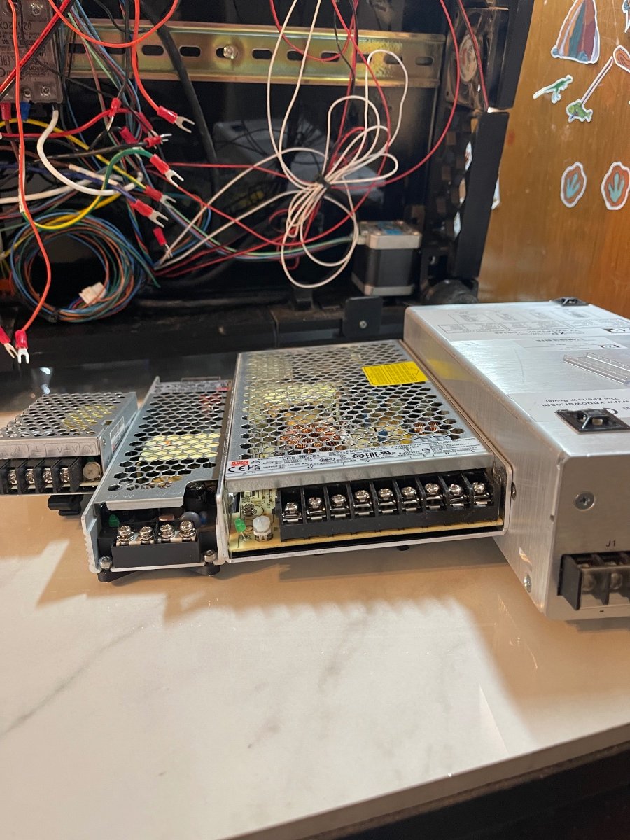

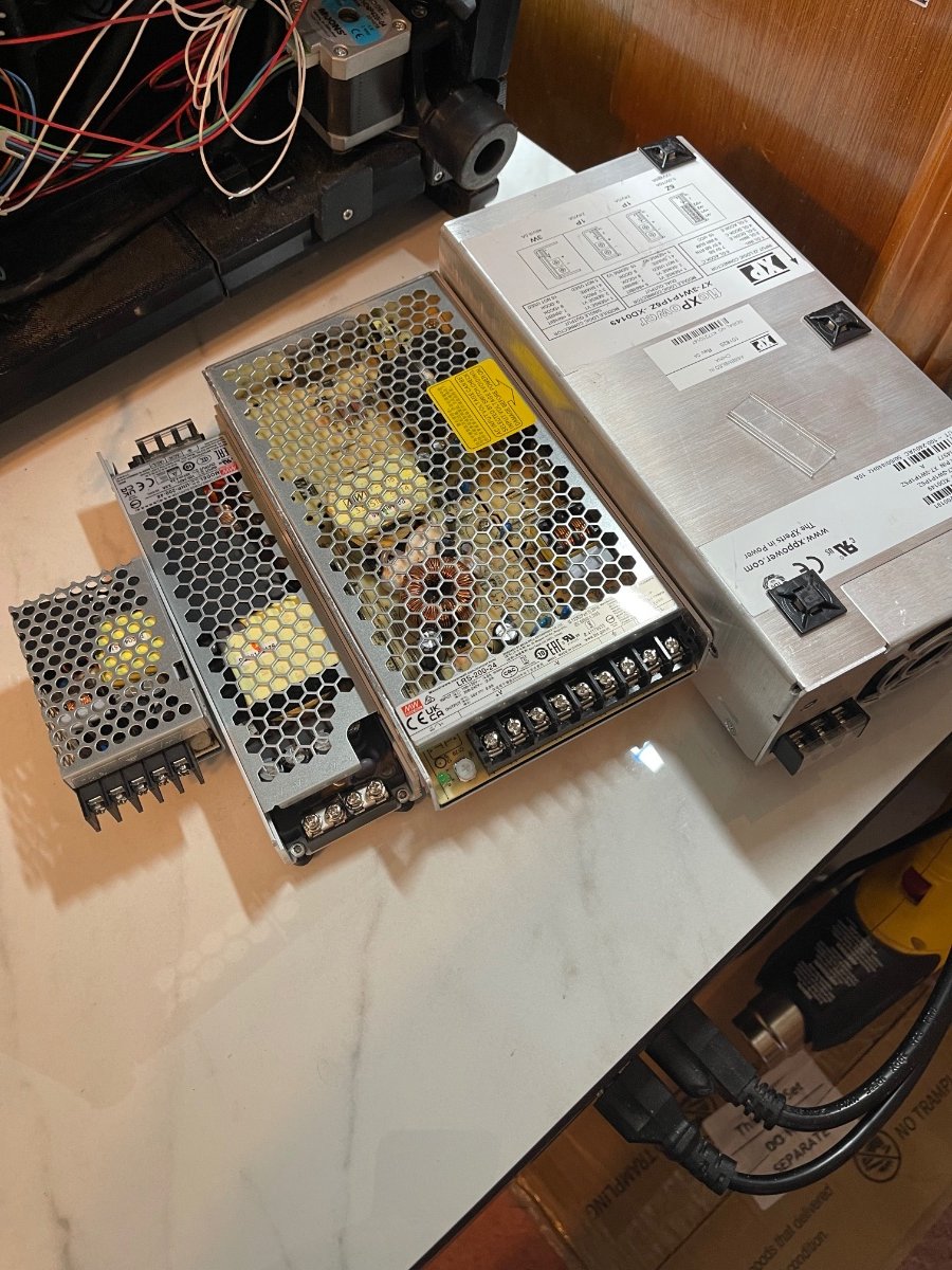

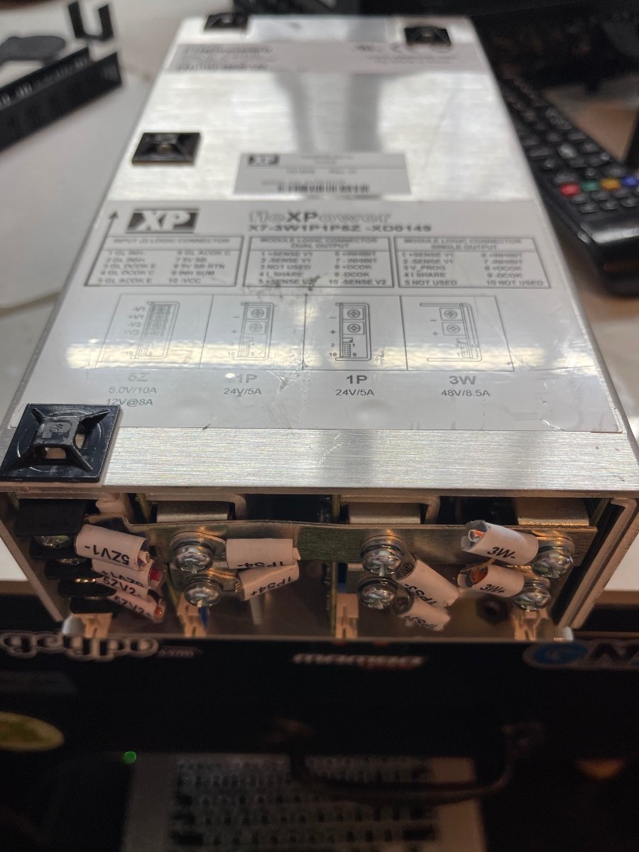

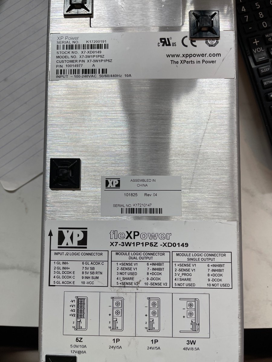

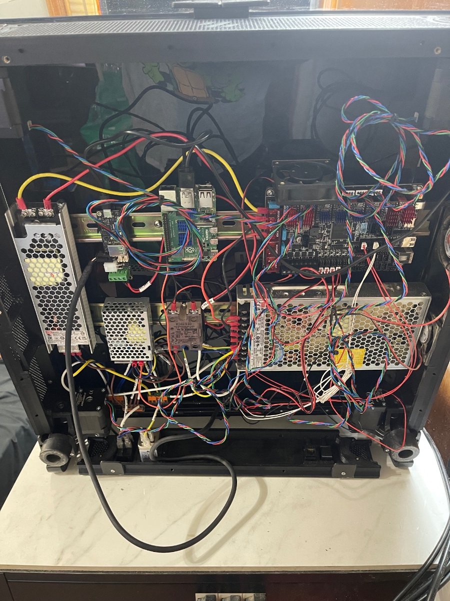

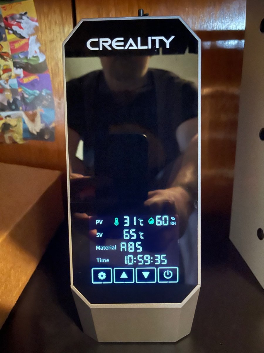

My aluminum BFI finally came in today. I got my UHP 200 mounted and wired. Finally on 48V. My new filament dryer showed up today.  Oh and I ordered a XP Power FLEXPOWER X7. May decide on one chunky power supply for everything.

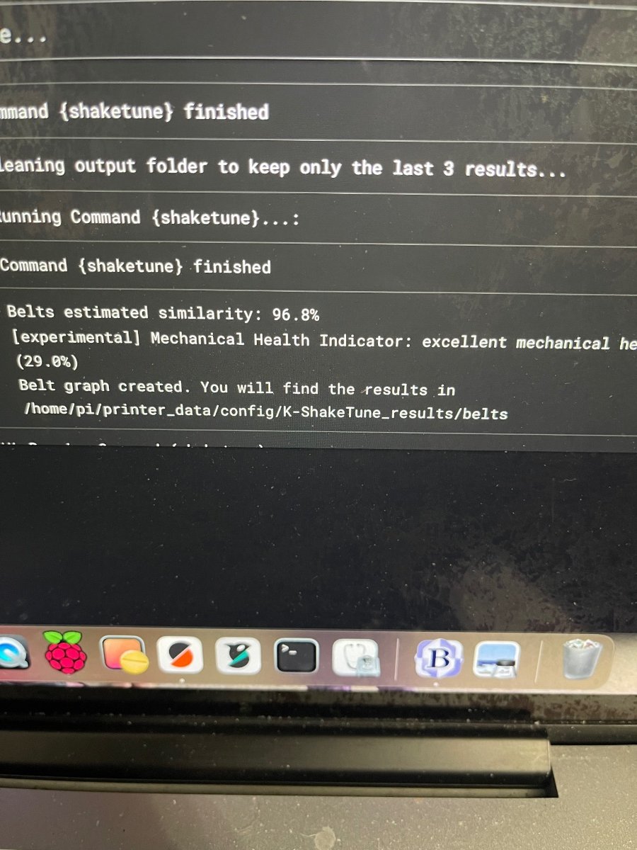

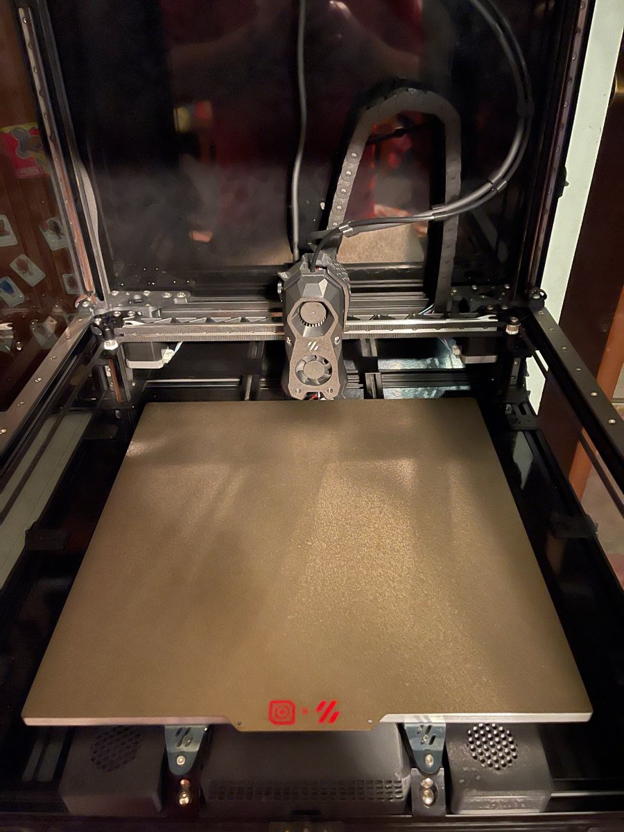

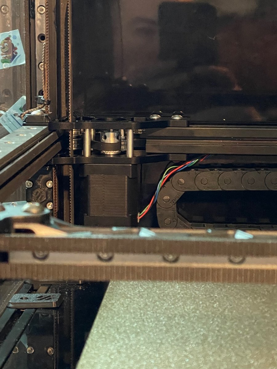

Hated the 2804 so I got four 2504 and put the four 2804 on Z. 😂 Waiting on some Molex from West3D before I do AWD with the 2504, I don’t wanna solder. The 2504 in 2wd were easier to get dialed for Sensorless and they make for much cleaner graphs.
Waiting on HoneyBadger Fans to finish my Rapid Burner, fans I have allowed heat creep. I went HoneyBadger X&Y rails as well, loving them.
I also ditched the NiteHawk for an EBB36. I just redid the ends on the NiteHawk cable for the EBB36.
I also added a Rapido 2 UHF a bit ago.
