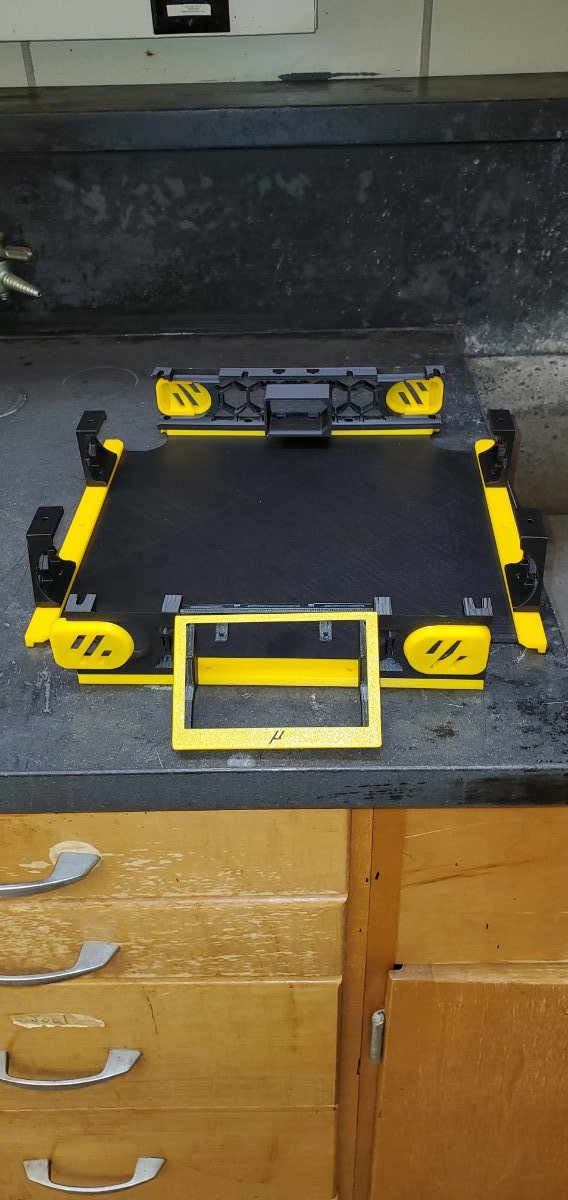

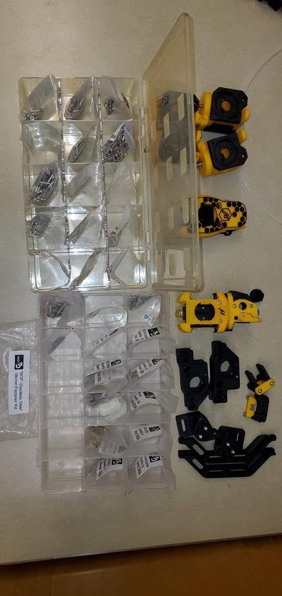

So I've started (and sort of finished) printing the parts already, as well as ordered a hardware kit from West3D since I needed heatsets and various screws for other prints anyway. Polymaker Yellow and Black ABS, planning on a red frame! BTW, at $35, the Micron+ hardware kit is an excellent variety hardware kit. I may get one for home as spare V0 screws. I printed Mini SB before thinking it would be cool to try Dragonburner, so I have both printed now. I also printed Boop, G2SA, and G2Z parts because why not. Also shown are top handles and Micron BZI. I printed R1 gantry parts that will need to be reprinted before I actually start building because HartK has updated about 5 times since I printed them. R1 gantry flips the z chain behind the rear gantry beam which prevents umbilical/chain tangles. Also includes customized BFI which is very cool.

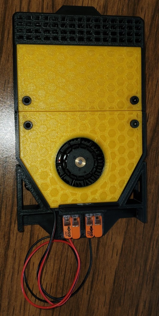

3DPF Filter is basically a nevermore for Micron.
