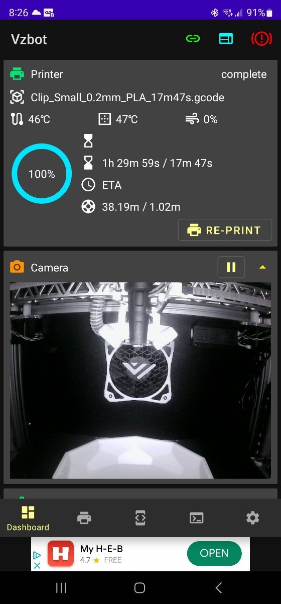

@mvdveer Time to get a Luke's Lab camera. Right now they're out of stock but I suspect they will have some soon. If they don't ship to you... let me know and I can be your go between.
Luke's Lab Camera
Thanks have bookmarked the page and will keep checking. Will let you know about shipping - thanks for th offer - appreciate it.

Two totally different cameras from what I have read. I do have plenty raspi pi cameras and they can be a pain to set up with crows nest, and I hate the ribbon cable. That’s why I went USB. Lukes Lab Camera is a is a plug and play USB camera, with IR and looks like motion detection.

Night Vision...

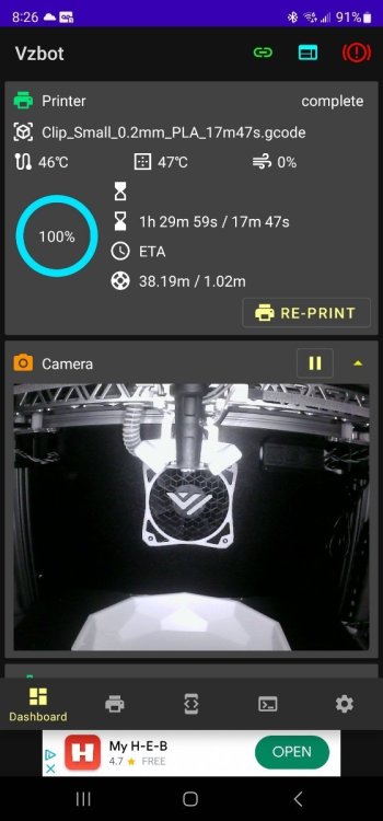

The Luke's Lab camera uses infra-red LEDs as it's light source for night vision, just like trail cams do. As far as I know, humans can't see in infra-red.
FWIW... I had to turn off the room and printer lights in order to get the night vision screen grab and I can confirm that it was dark.
