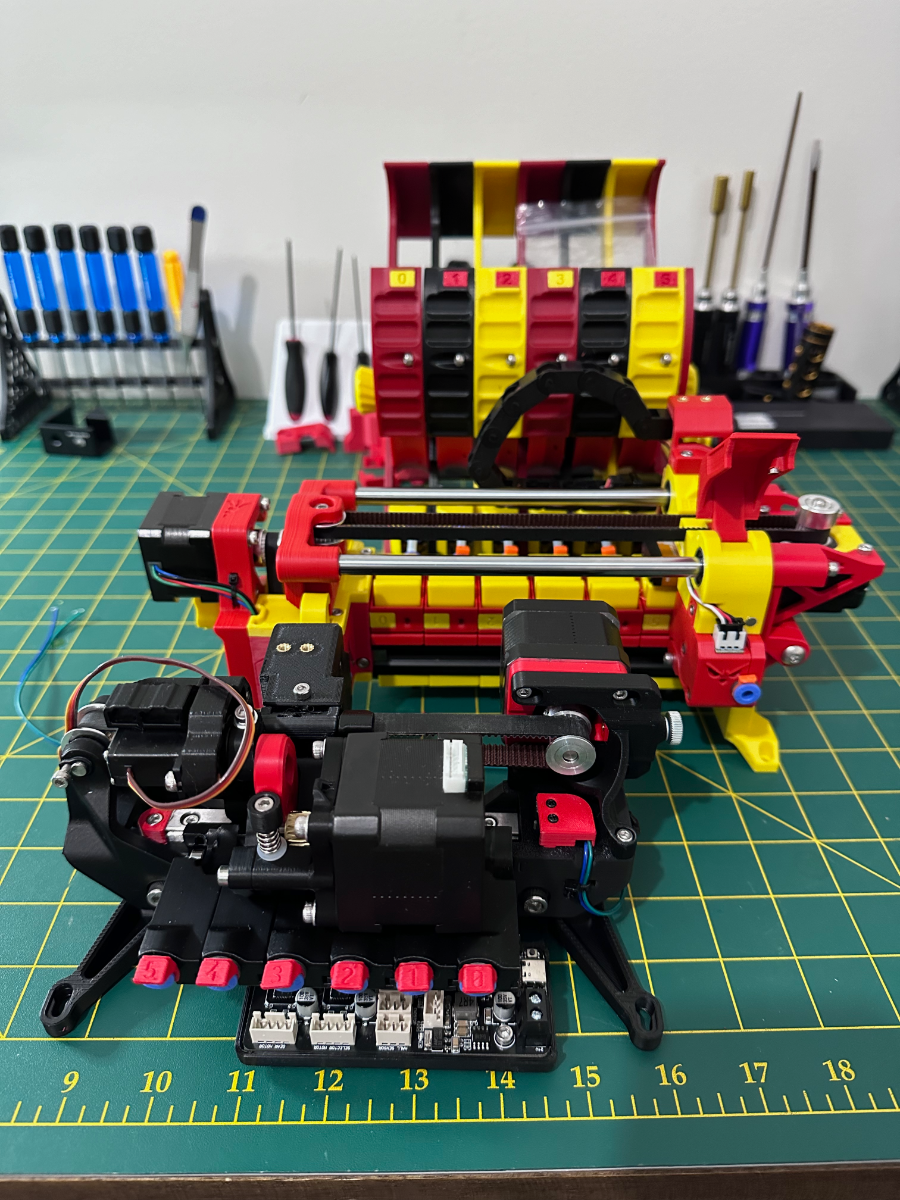

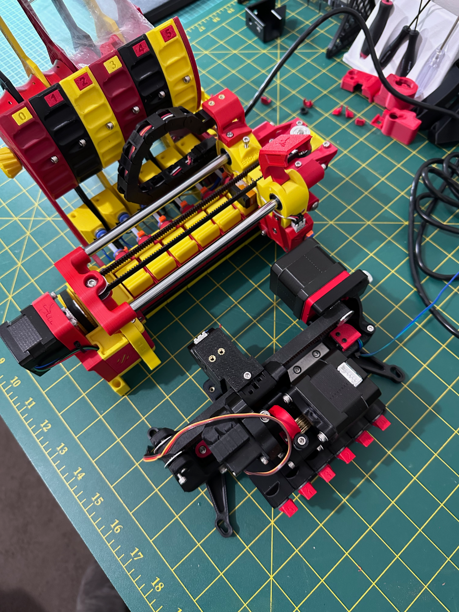

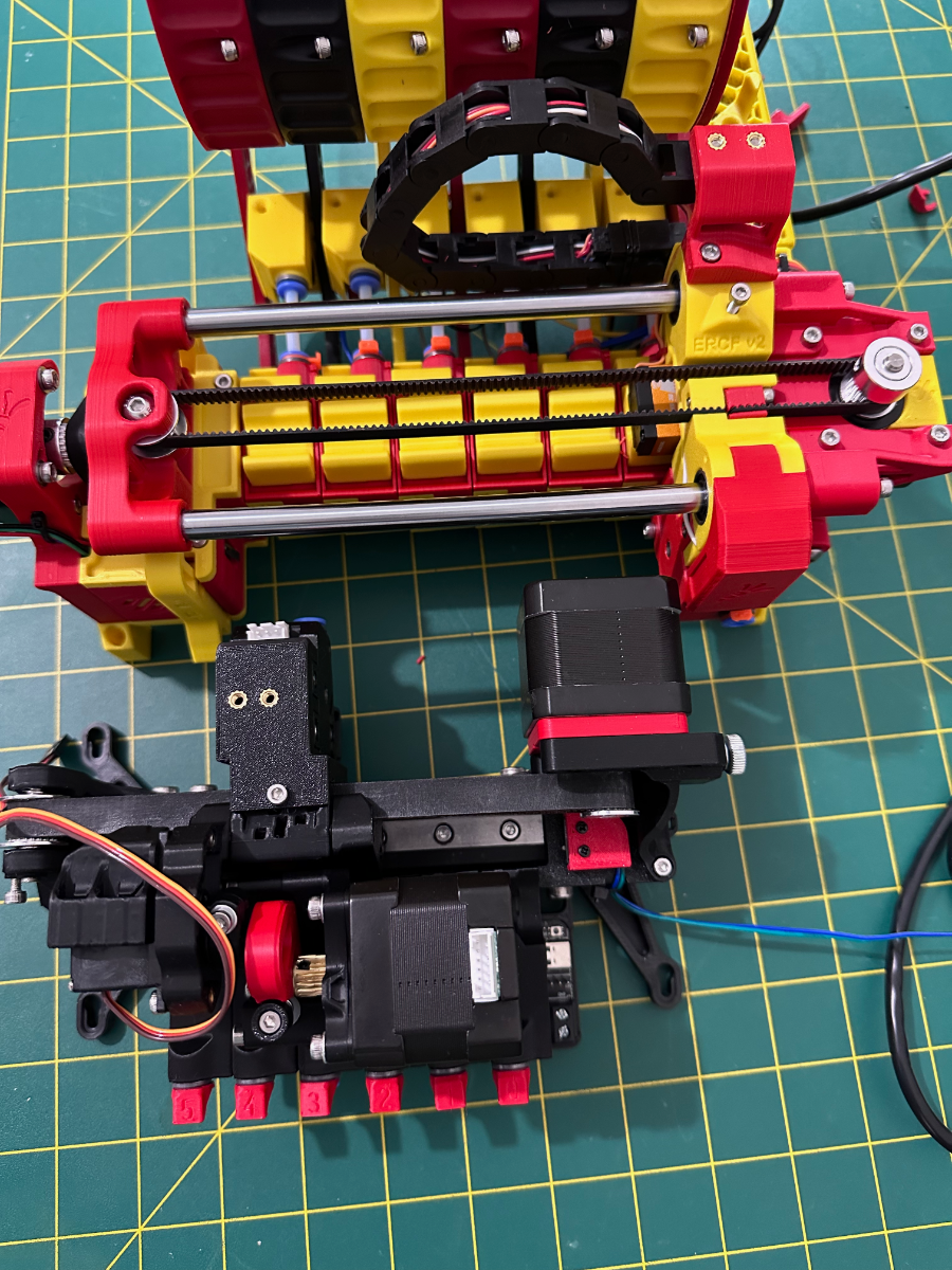

Though I would post this to show the size difference between the TradRack and the ERCF v2. Both are 6 lanes. The footprint of the tradrack (with binky mod) is about 1/2 to 2/3 the size of the ERCF. The photos don't really do it justice, as the eRCF also has the buffer mounted.
Build wise the tradrack is 100% easier to build - less parts, less complicated.

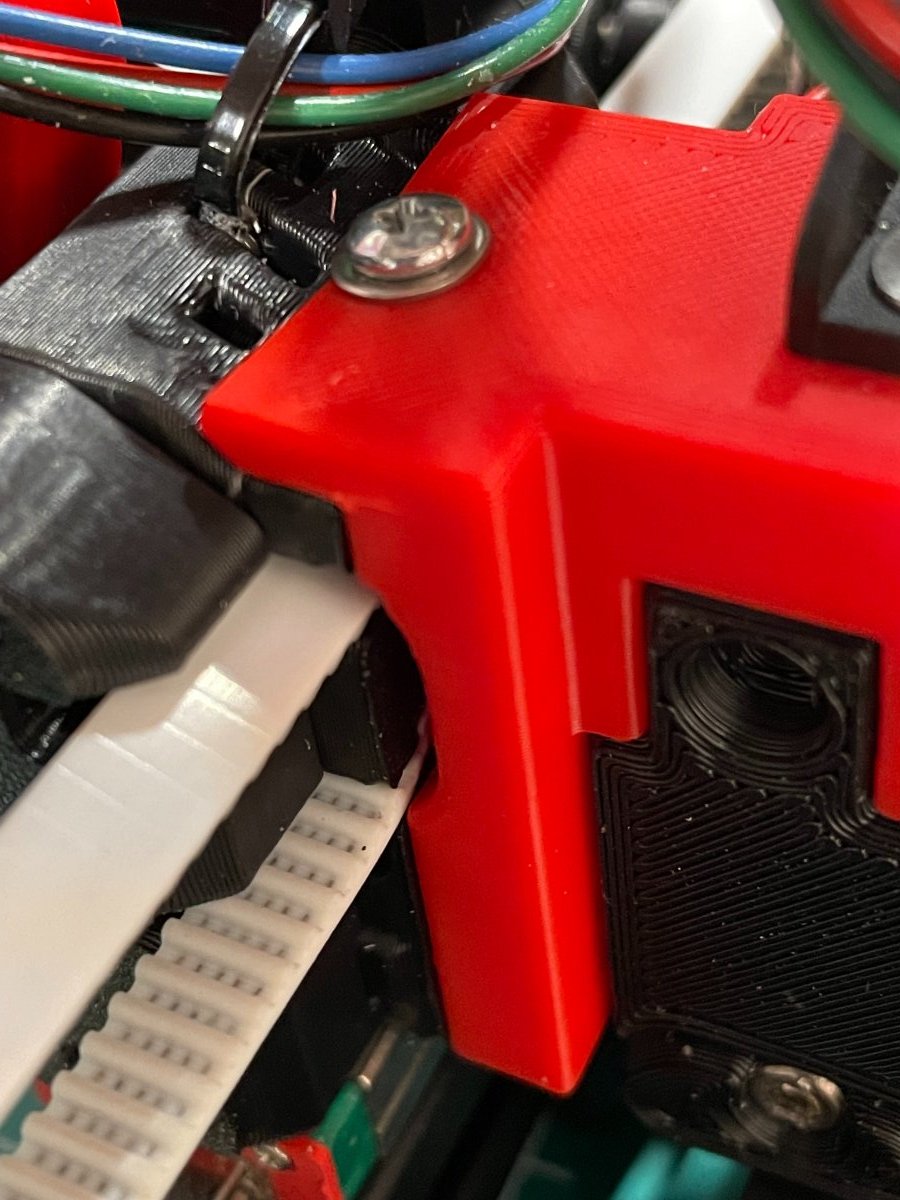

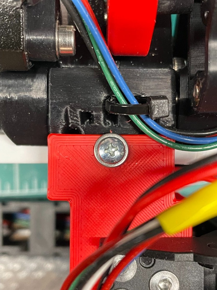

Talking to myself over here - I had too many failed prints due to a crappy filament path and a clogged print head, plus some underextrusion. I paid the pain and figured out what was needed to get the Binky encoder mounted on the 6mm belt carriage, and the short answer is - use a self tapper for the top screw. No need to replace the carriage at all, especially if you want to belt-and-suspenders a limit switch and an encoder. Then, I added the Annex Belay sensor to help with extruder syncing. The whole mess looks like this now:
