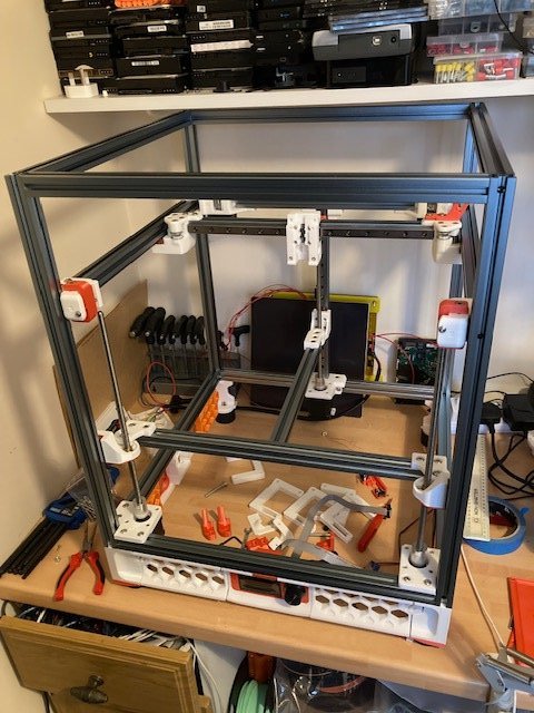

Built a pretty basic CoreXY last year but had several issues with bed levelling, build size etc. etc. so decided to bite the bullet and go for a Voron Trident build using many of the old CoreXY parts.
I've been printing off parts on my Delta and Ender 3 and bought a LDO frame kit for a 300 as many of the old 2020 extrusions were too short.
Been going well and put together a StealthBurner using my old Orbiter V2 using the mods from this site (thank you). Having so many wires coming from the head I thought I might try Can Bus with this build.
What a minefield! My old board is a BTT Manta M8P with a CB1 module fitted but it's a version 1.0 which I discovered has not got CAN support. This means, I think, I have to fit a U2C board as well to interface between the EBB 36 CAN and the Manta M8P?
Am I just asking for trouble with this approach or is there a better way?

Thanks for your comments and help. I'm going to battle on with CAN as I do like the idea of not dragging so many wires around. I did look at the 2-piece PCB setup but again still too many wires. Ordered the boards from BTT so it will be about 3 weeks before I see them in England 😪 Still more time to get my head around CAN.
I've still got my Delta and Ender 3 so not short of machines!
