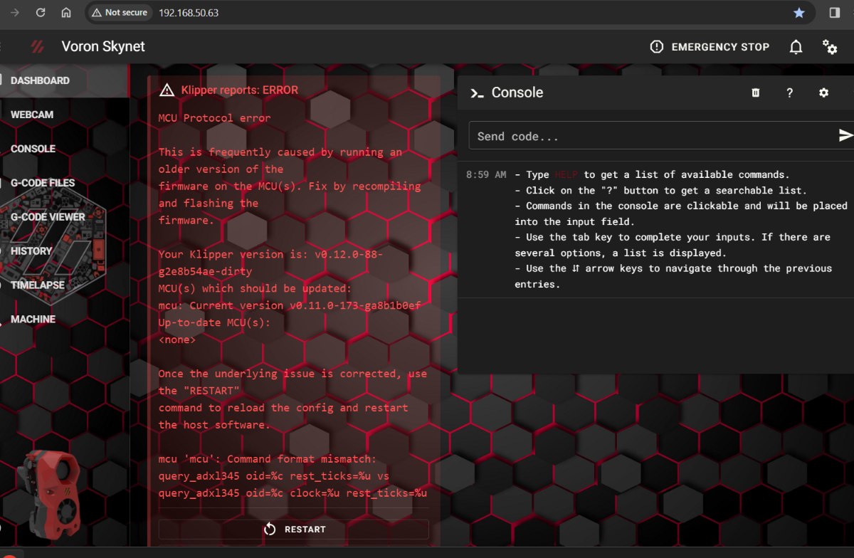

I don't have a CANBUS, just a HartK PCB,  but im getting a similar error after updating this morning.
If I comment out the input shaper info in my printer.cfg,  it starts fine with no errors.
Otherwise, it looks like this:
My MCU is an Octopus V1.1
Edited by ken226

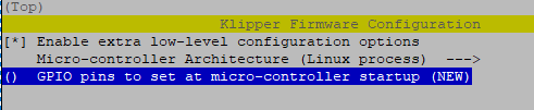

11 minutes ago, YaaJ said:
@ken226 Just build the "linux firmware" (Linux process in make menuconfig) and "flash" it on the Pi. Then, you can uncomment the ADXL settings in printer.cfg. Not an issue, just a version change ; main board with Klipper 0.11, and 0.12 on the Pi.
 I don't know what any of that means.
Is it a command you run in Putty, after SSh'ing into the pi?  In KIAUH?
Edited by ken226
