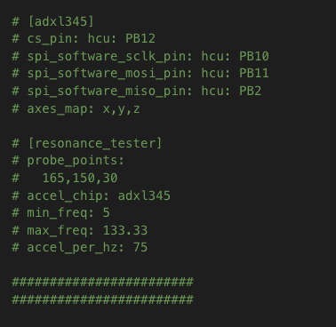

If you have an EBB36, which I have several... all you need to do is comment out the ADXL config and this goes away. Has happened on both my Voron 2.4 and my VZ-Trident
Mine was alread commented out.

Glad you got yours sorted more easily... I had my EBB ADXL enabled, updated every component that runs Klipper, including my RPi, and was still getting the version error and message concerning the EBB's ADXL. I at that point knew all my components had the same version and decided to disable the ADXL, which got things going again.
That was on the first one... the second printer, I commented out the ADXL, updated Klipper and everything continued working.
