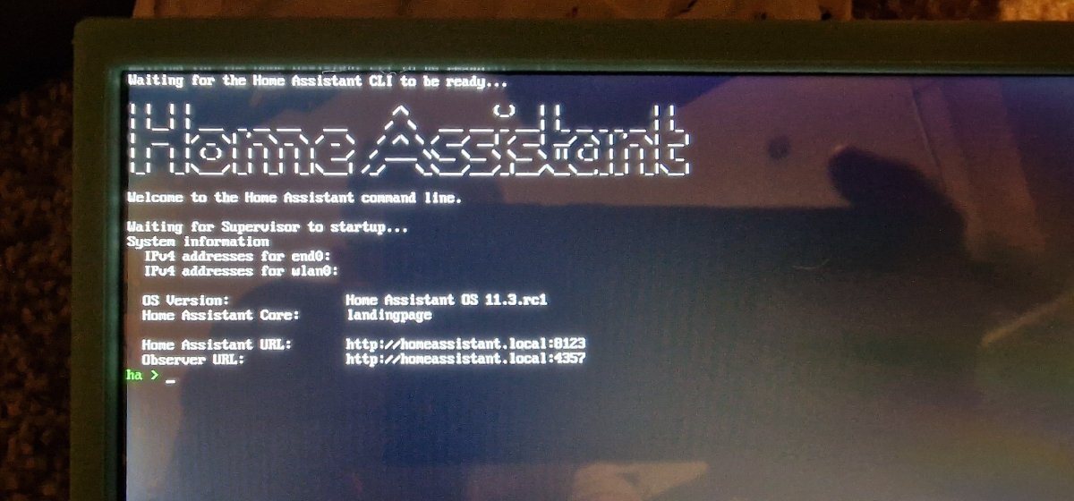

HA OS doesn't like the fact I'm using the GPIO pins for power when booting from SSD, I have to press the power button to bypass.. need to power through the USB-C or change the config to bypass the check, but I don't want power issues... looks like I'm cutting up a cable 😬 but wires will be very thin no doubt 🙄
PS I'm using a 5V 75W PSU..
😮 You're running HA on the RPi5 installed in the printer?! I was under the impression you were going to move it to a stand-alone setup. That would be my recommendation.
I would personally set up the Pi5 in a nice, standalone case with a proper power supply (the official one is now 27W!) and set up HAOS on it. Then stick a Pi 3 or 4 in the printer. Once each of those are set up, install HACs on HA and install the Moonraker integration; that will connect your printer to HA.

I've managed to get HA working but only by using a network cable, won't work over WiFi, time sync is still an issue and failing on boot, so purchased an RTC..
I think you are right, I'm going to have to put the RPI5 in a purpose built enclosure with the proper power supply (i really do need to stop changing my mind and throwing money down the drain 😂)
My RPi power supply and RTC came yesterday, printed a stand alone enclosure, connected, plugged in and boom all working as it should!

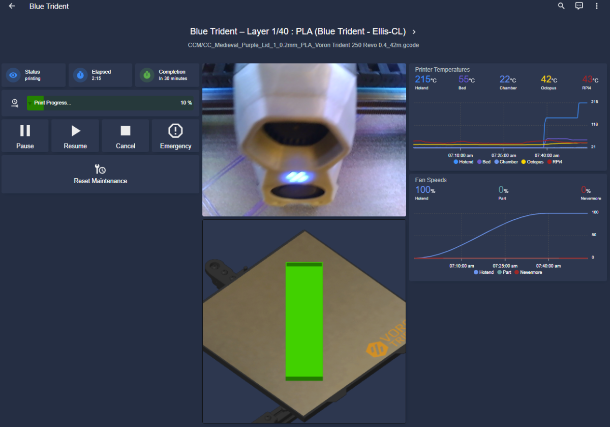

I have looked again at the Moonraker dashboard outside my own wifi and it does come up & show the current printer status--and the webcam on the Trident. So that part works and I'm not going to mess with Obico any more.

Any webcam that you can hook up to Klipper will work fine. As Nero has pointed out a few times, you don't need HD on these cameras--they are really for checking if the print is going ok. Is the part still stuck to the bed? Am I building a spaghetti or blob monster? Is the printer on fire?
The Moonraker integration in HA will pick up the Klipper video feed as an entity that you can stick in an image card. Easy Peasy.
