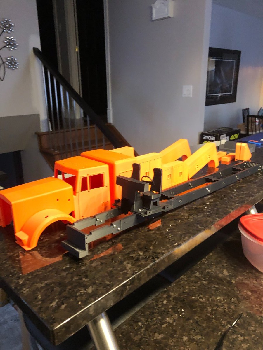

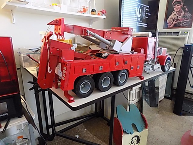

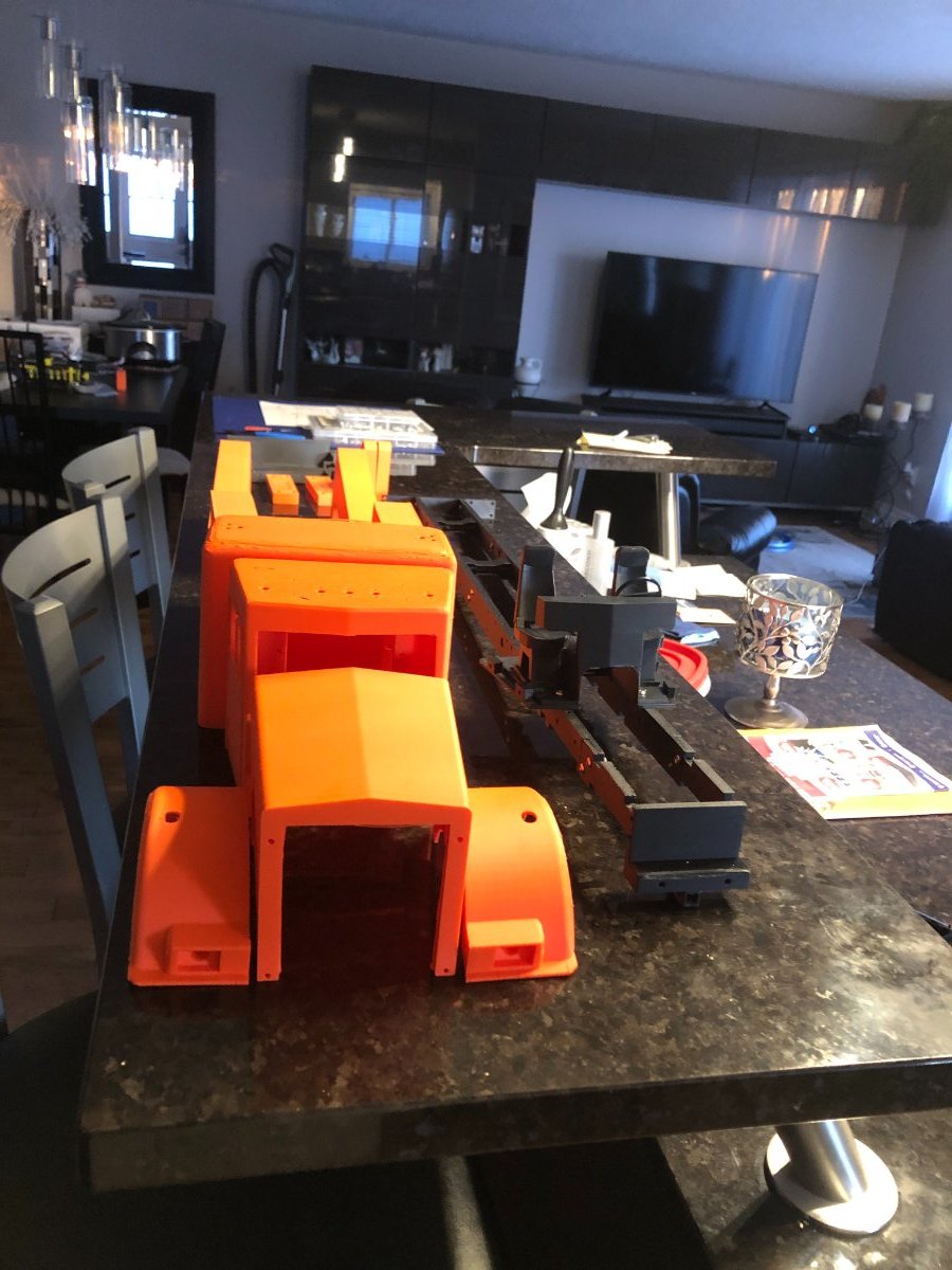

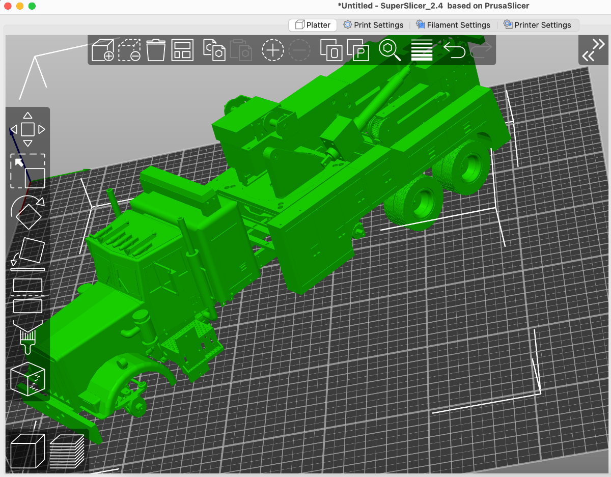

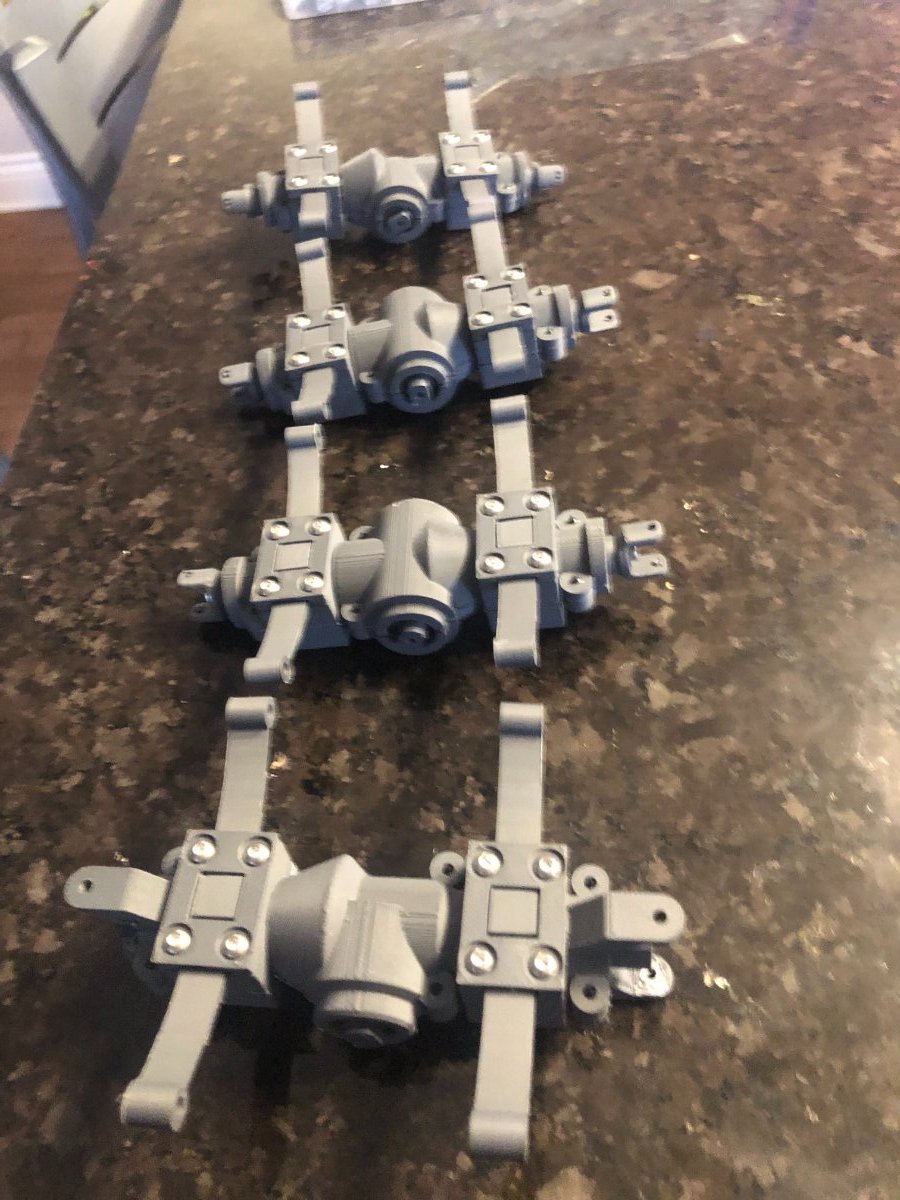

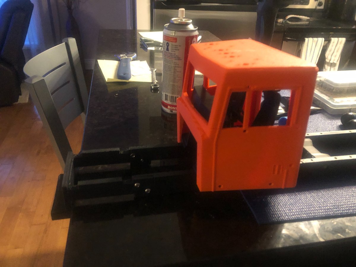

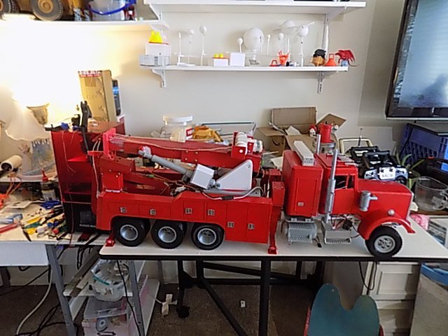

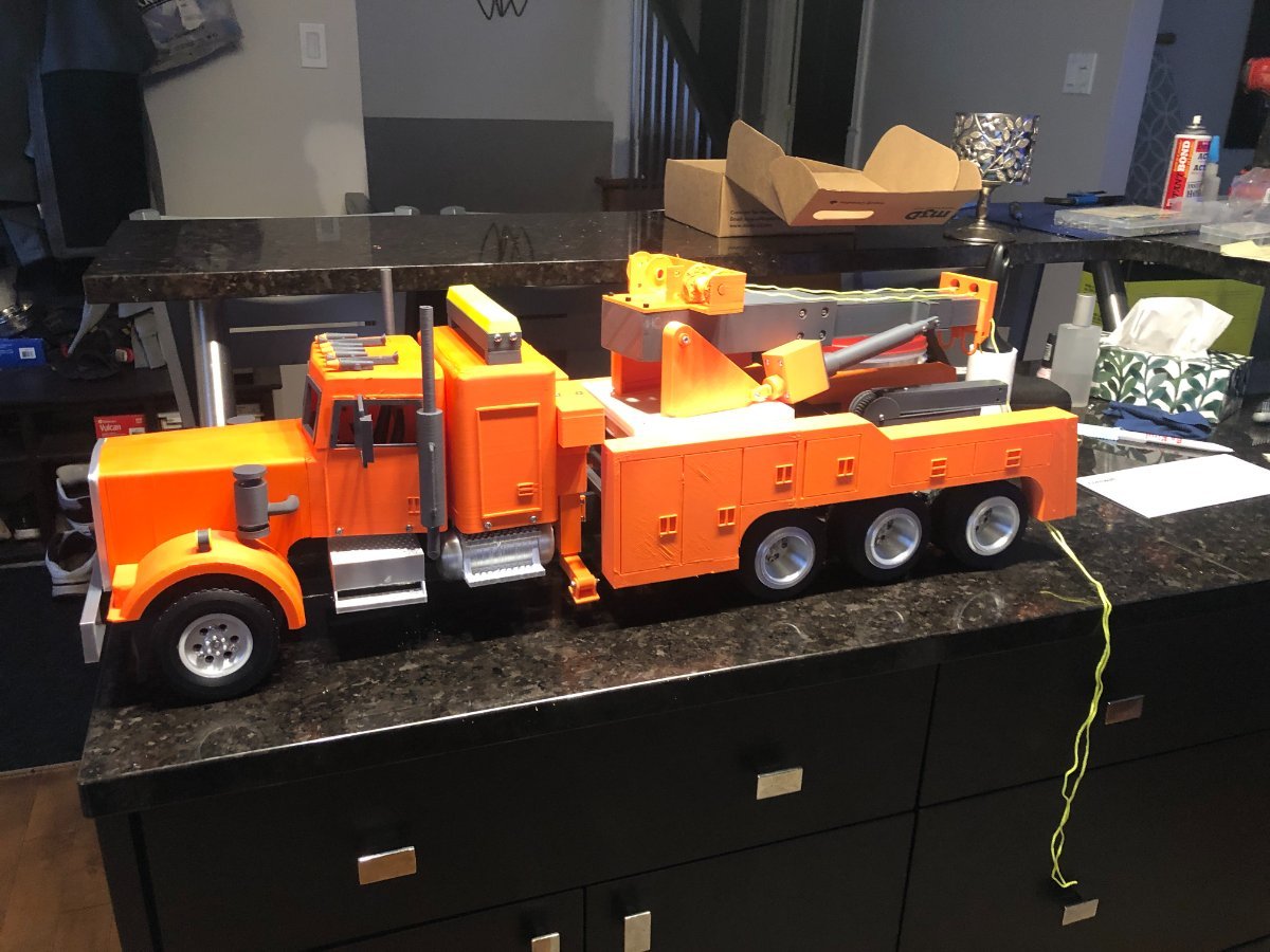

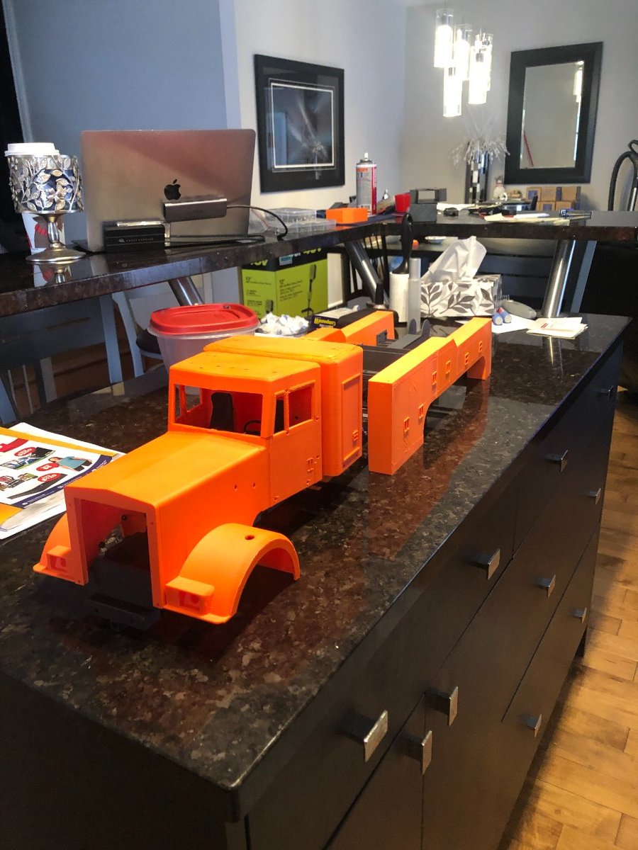

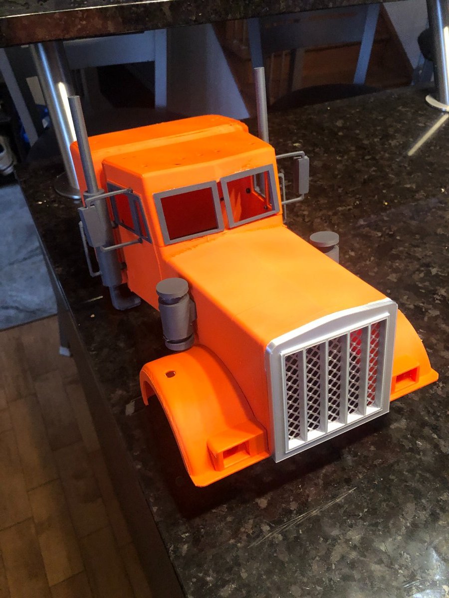

Is anyone in here into printing RC models? Found the Heavy wrecker model though I'd give it a go. Assembly going to be like putting a puzzle together with little to no direction on how to assemble it. I like puzzles LOL.
https://www.thingiverse.com/thing:4581519
This will be my go-to for assembly

😮 That thing is a monster! I look forward to updates.

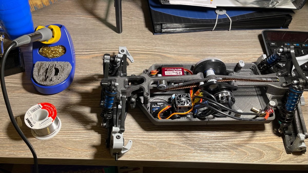

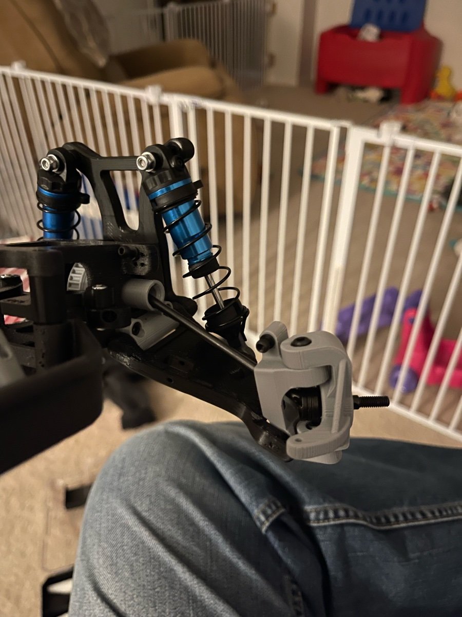

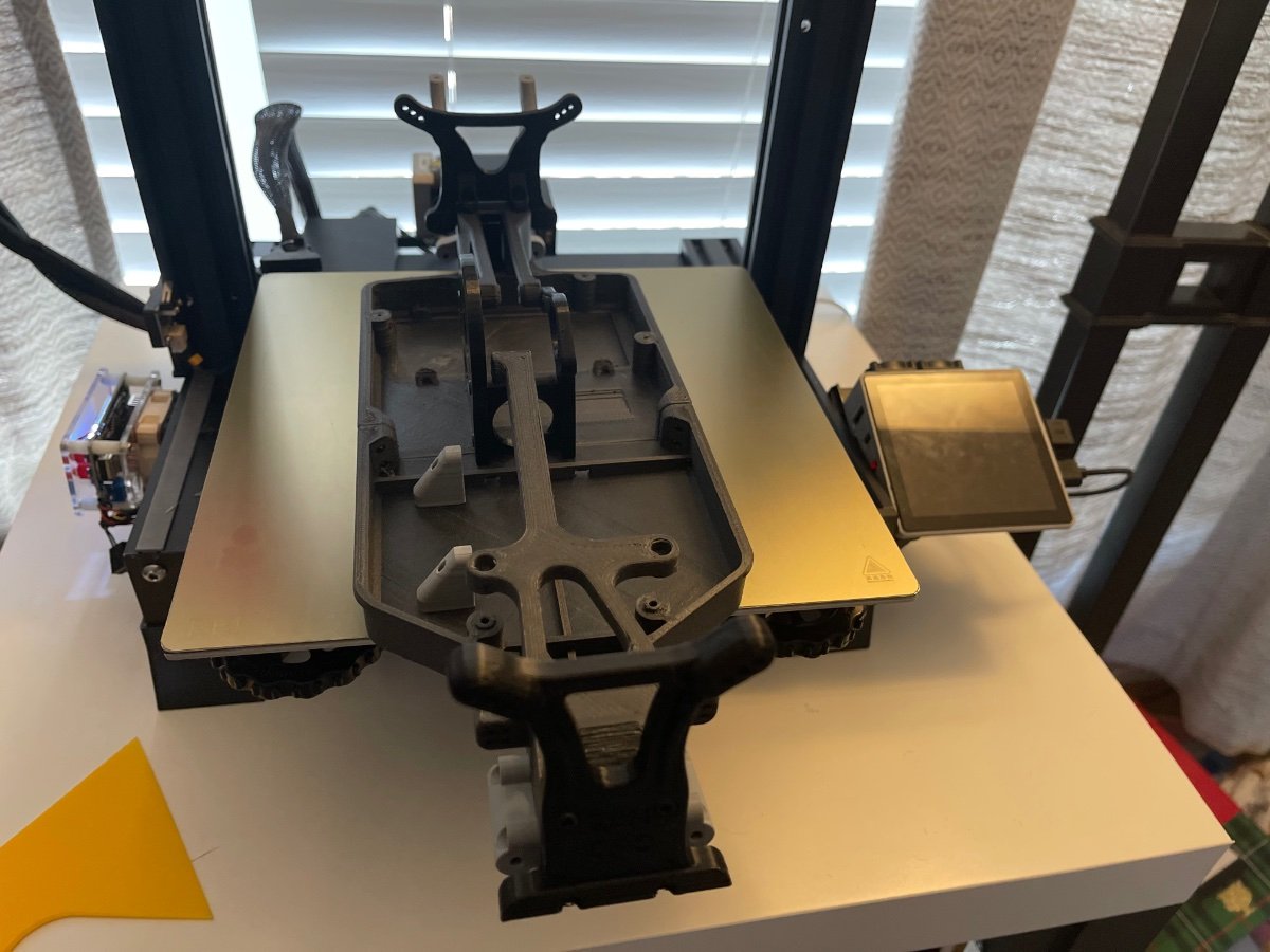

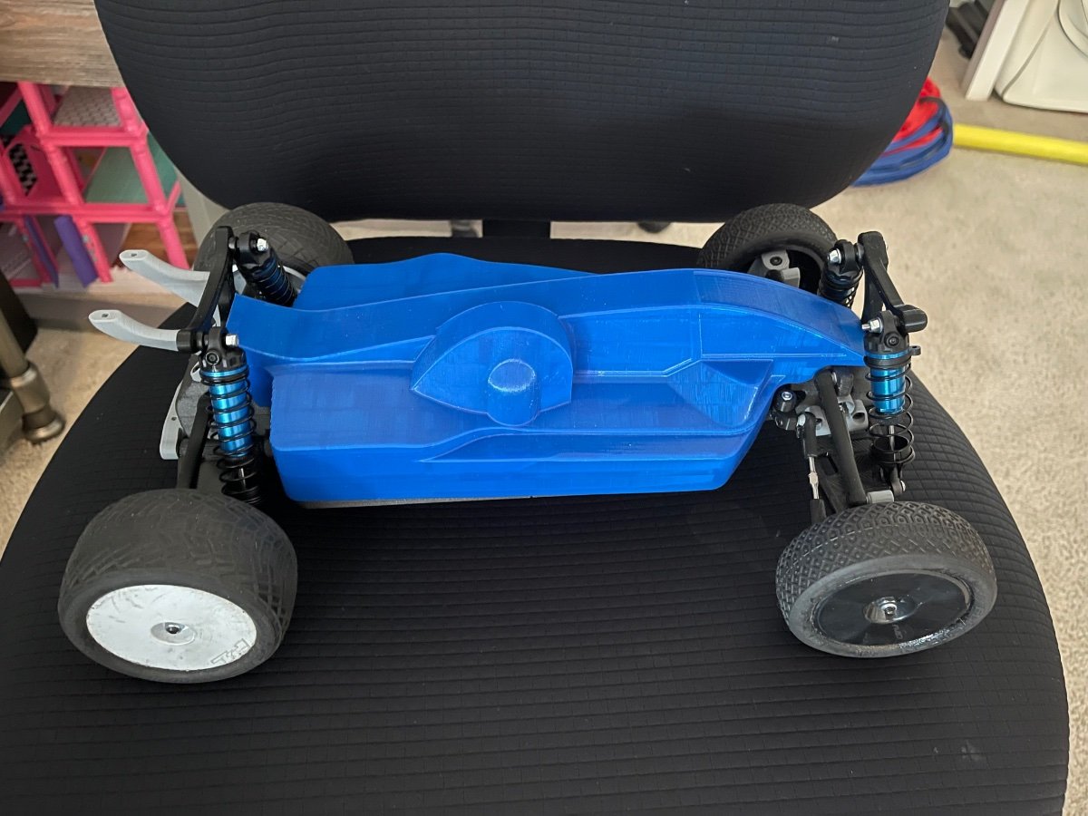

I have built a couple of 3D Printed RC. My son and I built a pair of OpenRC F1 cars; I kind of want to go back and reprint to the newest spec. I also built a Tarmo4 truggy. I think I have a couple old threads around here somewhere on those.

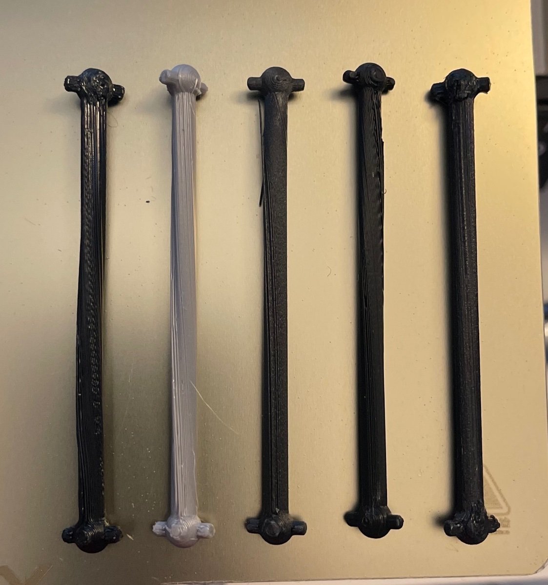

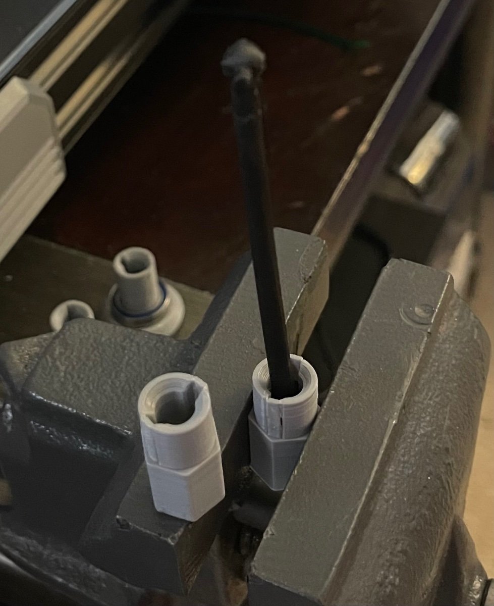

They need to be beefier. The Tarmo4 ones are probably 2-3x as thick as those; it also uses big TPU intermediate shafts from the gearbox to the diffs. IIRC, that model is intended to use metal ones. The main thing I keep killing--aside from crash damage--is indeed gears; both on the OpenRC F1 and the Tarmo. I have learned to print up a bunch to have spares handy.

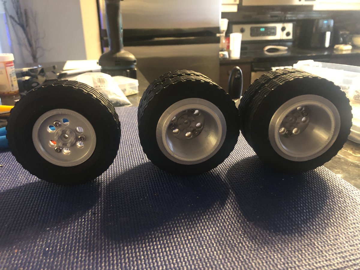

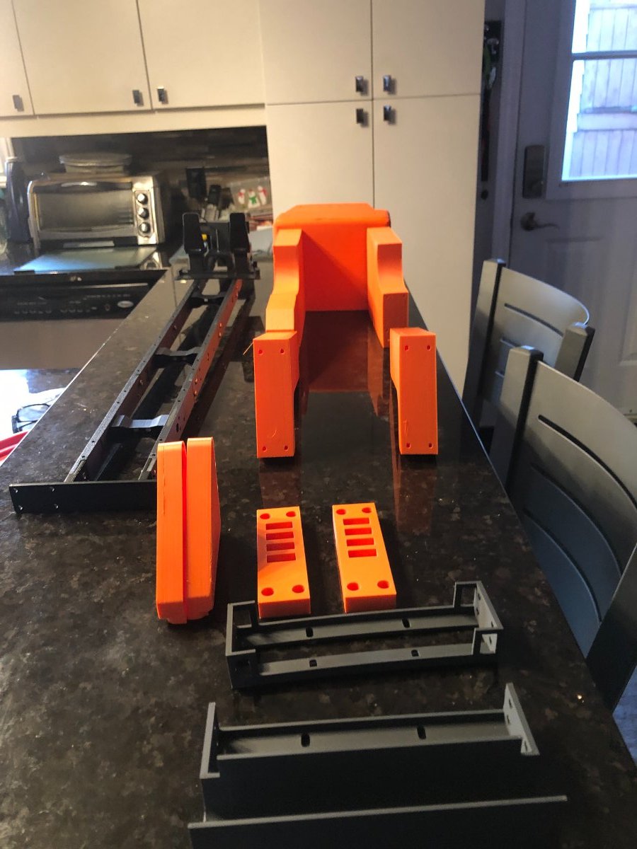

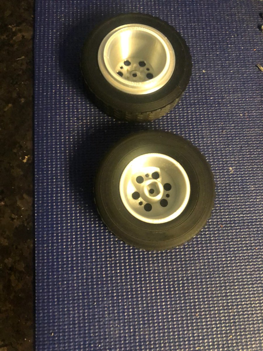

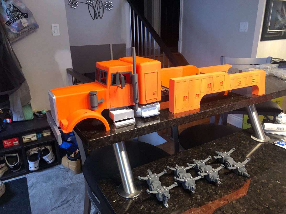

More parts printed, when the Trident is complete it will assist in printing parts for this project (a lot of parts). Need to order more M3 nuts and M3X8 screws. Got some Esun Silk silver PLA for the chrome parts. It going to be a fun project putting it all together. Esun ASA black, Esun ABS Orange, Matter3D ABS Dark Grey.
