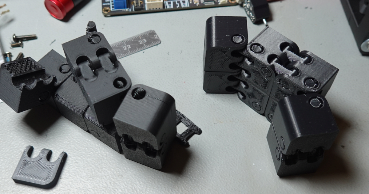

Printed two Kobayashi's (very old print-in-place fidget) ; the daughter wanted her 7 years old one replaced (PLA)
https://www.thingiverse.com/thing:1790624
Voron 0.2 ; two materials.
On the left : eSun ABS+ ; it didn't fall apart after removing it from the builplate. It felt apart while printing !
On the right, the cheapest ABS from Amazon ; didn't even have to break it in. Beautyful.
LA is calibrated for ABS+, didn't change for the plain ABS (bulges a bit on corners). 250/100°C, 0.2mm layers (0.14 recommanded)
(of course, being ABS, and printing outside to inside, with thick layers, overhangs are not the best, but it is perfectly functional, works smoothly, and will not fall apart.
