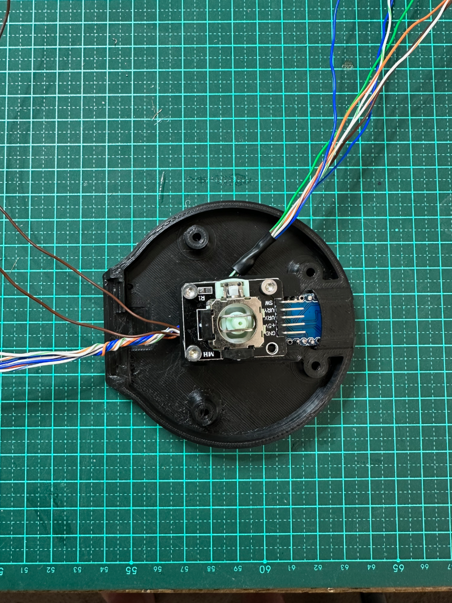

Used an old CAT5 ethernet cable that I stripped down for the wiring.
Joystick assembled:

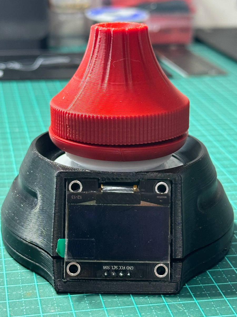

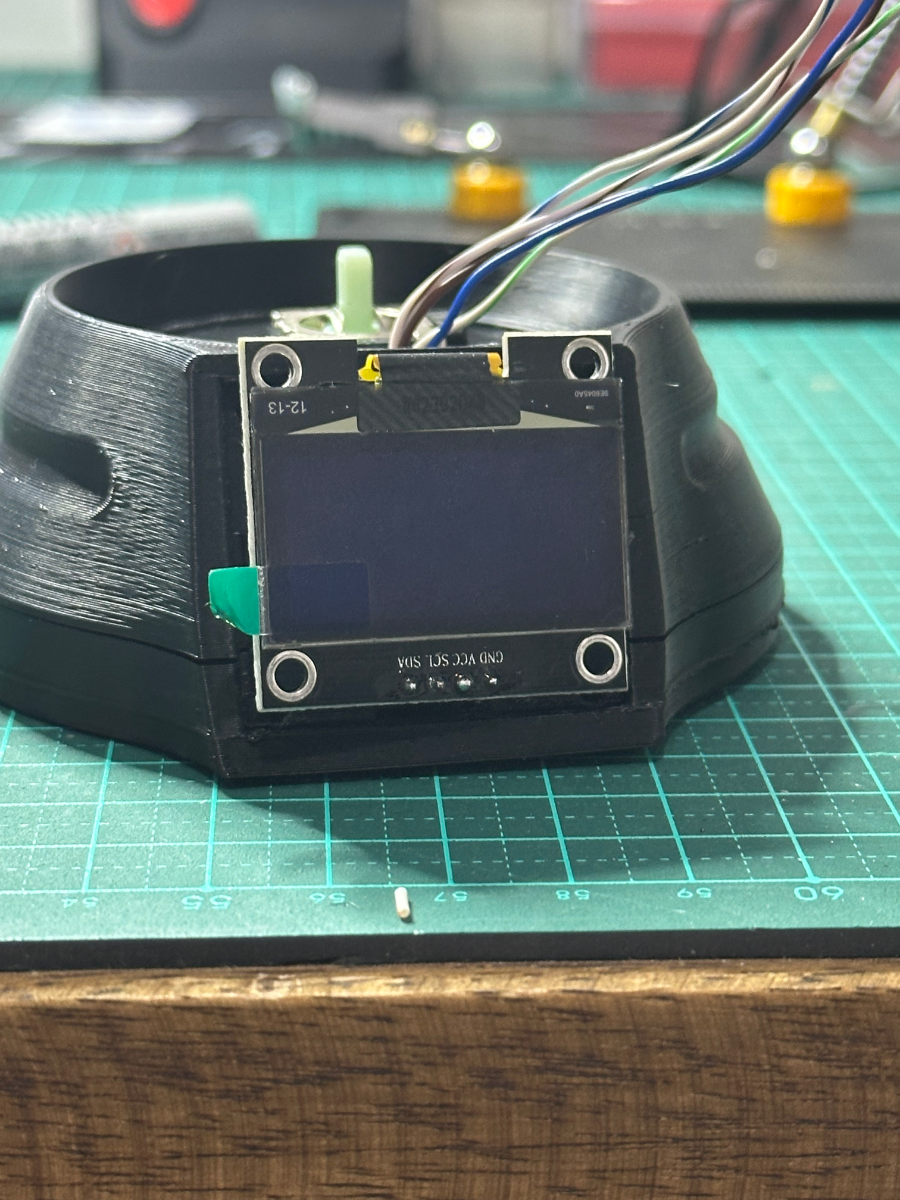

Screen fitted and wired

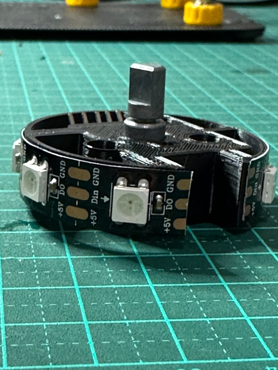

LED's fitted -- oops - this is for Version 2.5, but this is build 2.2 ?????? Why are they listed in the BOM????.
Not going to be wired or used.

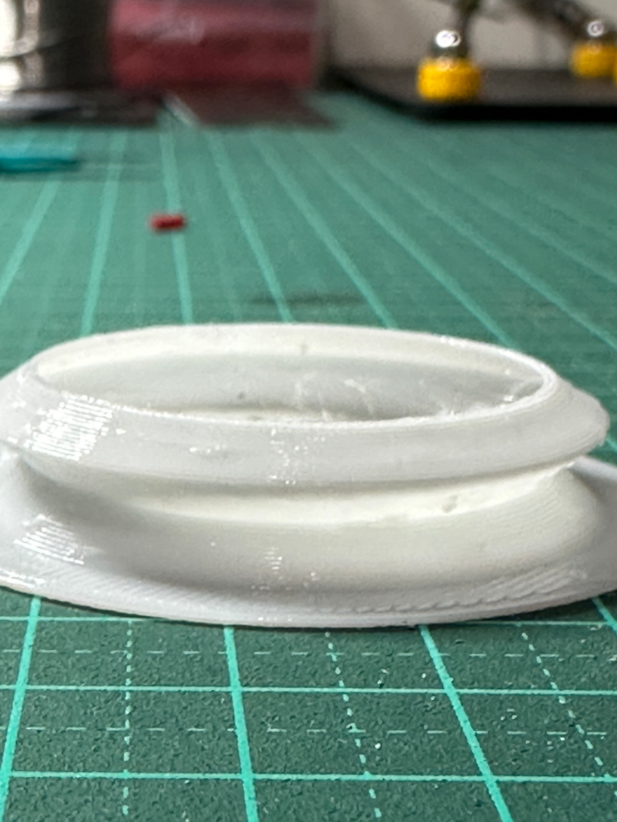

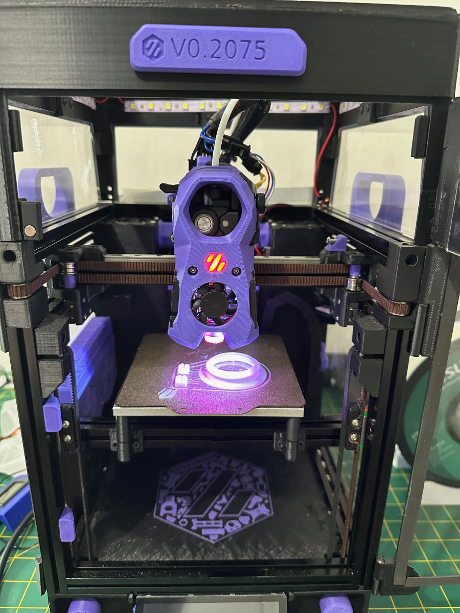

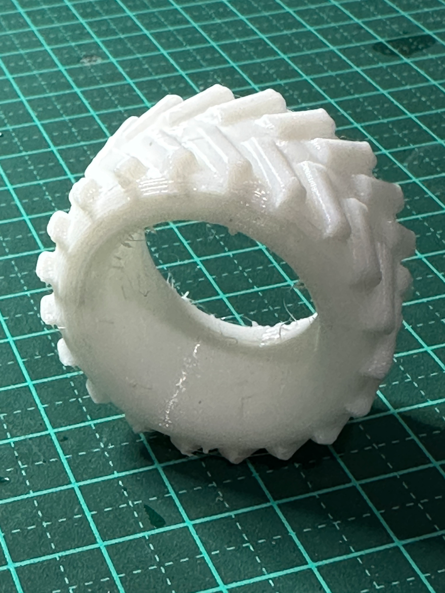

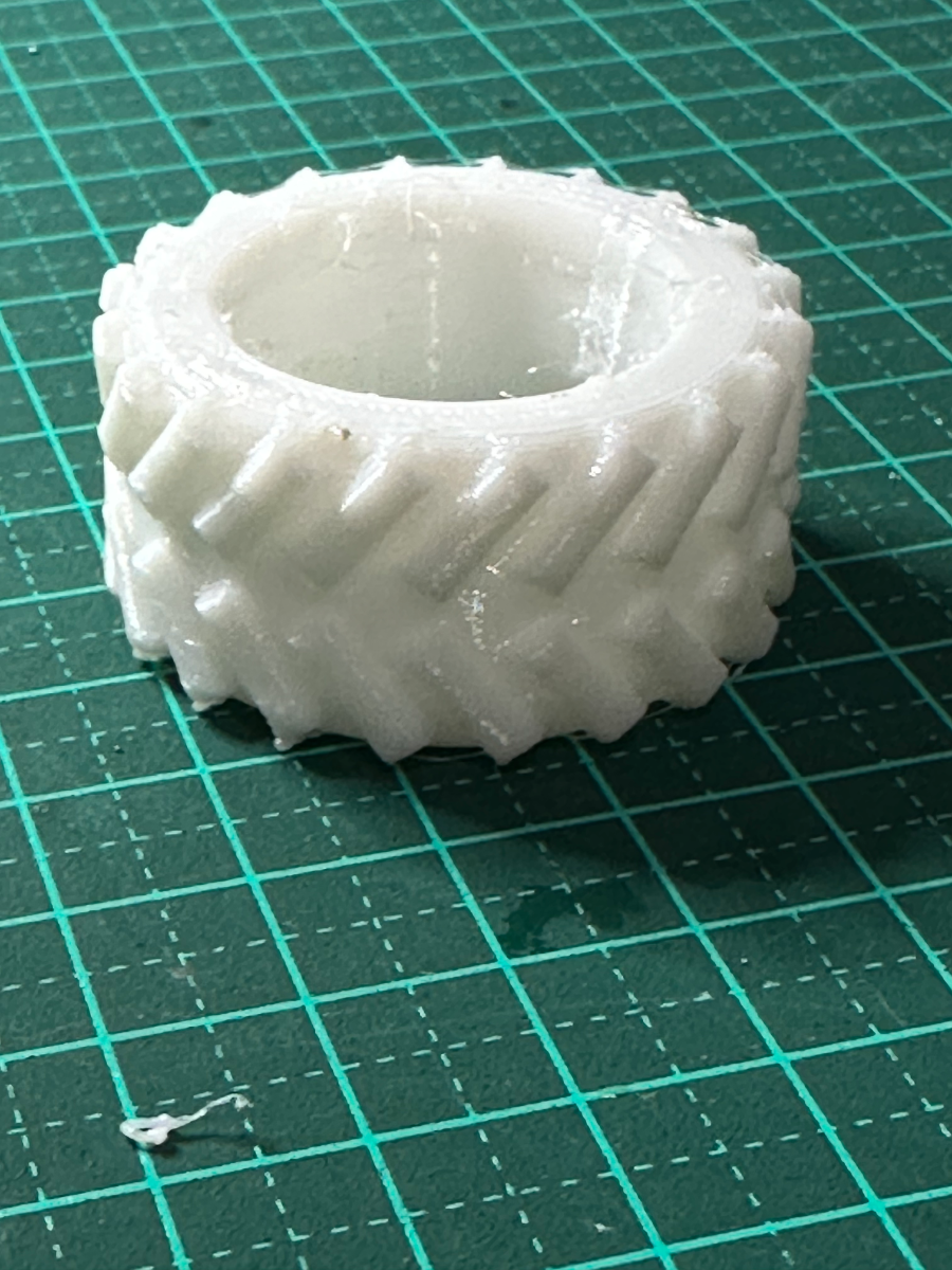

Had to print some parts in TPU - First time ever using TPU (Have a roll of E-Sun e-TPU- 95A). Fired up the Trizero, adjusted the tension - set up a slicer profile and away we go. Very happy with the results - functional to say the least.

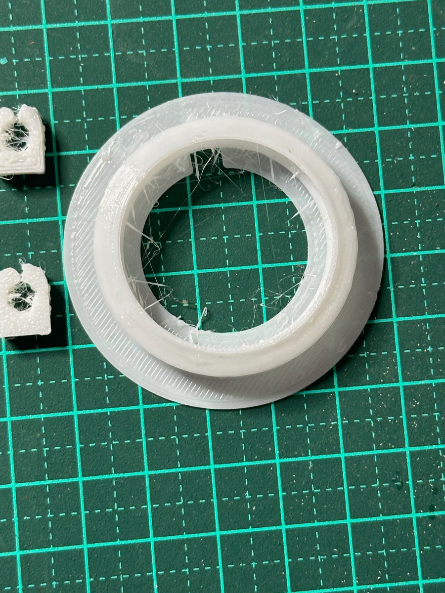

IMG_5415.thumb.png.0f7f54d45472ede75e72917d613d113a.png IMG_5417.thumb.png.ea1ddeec35a697470df1d5734d896024.pngIMG_5416.thumb.png.185c7d0704db4d5594d5524c2c5c4ce4.png
Wow - there is a lot of stringing ! - Will have to tune that.
Just for good measure, I printed a tyre as well 😂 - I'm having fun alright!

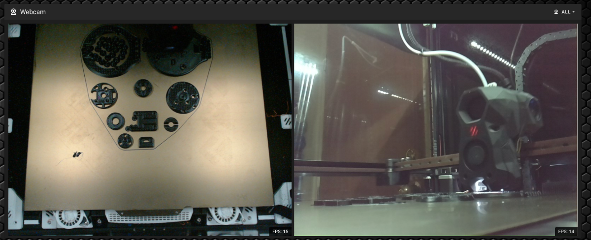

Eventually found the stl's for the current version 2.5 - printing those now on the 2.4 350mm build:.

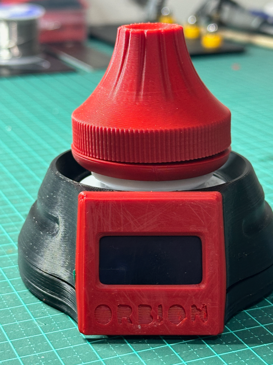

Fitted all together and came out pretty good. Slight gap between the knob and the carriage - may have to look at the printer tolerances.
IMG_5411.thumb.png.0d21de0efec44312d04b35e8b18f56f9.png IMG_5413.thumb.png.263661c4c4641a6596ff3d611da7298d.png
Plugged it in to the iMac and recognised by the Mac. Now on to programming it.
Nice little Saturday Project!
I had fun - thought I 'd share

TPU has been extremely difficult for me to print. I can get functional parts, but they aren't pretty and if you thought PETG was bad for stringing, boy oh boy.
