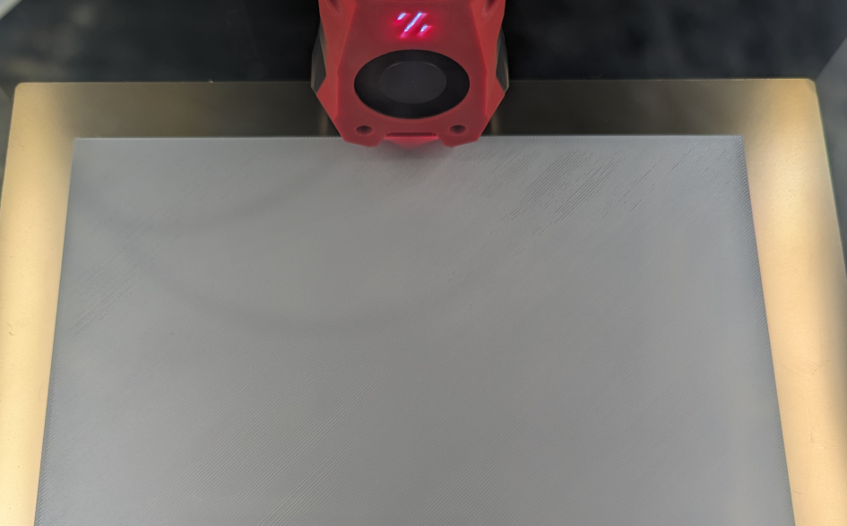

This is a 200x200x0.2 @ 0.2 layer height cube I print to check my first layer.
Under normal circumstances, it looks normal, well, no anymore. See those gaps only at the very end??

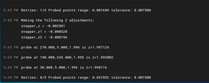

My z-tilt looks correct

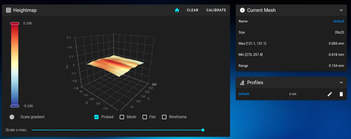

The mesh for that sheet looks "alright"

Would a damaged POM nuts cause that?? I can see the Z-axis turning during the print to counter-adjust ( z-tilt) so it is working but I wonder if the POM for some reason went bad.
