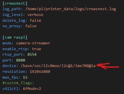

What I found eventually to be the problem to getting this working is having “Legacy” camera support enabled and/or not using the Bullseye version of Pi OS on the Raspi SBC.  In my case this is a Raspberry Pi 3A and a Raspberry Pi 3B+ between my two printers.  Once on Bullseye OS with camera support disabled the Pi V2 and V3 cameras work very well using the webrtc service producing a very smooth 1920x1080 video.  You need to use "sudo raspi-config" then "Interface Options" to disable the camera support of the Raspi SBC if previously enabled.  One other thing if using the V3 Pi camera to get auto focus working I had to add the following in crowsnest.conf file:
V4l2ctl: AfMode=2

I believe the basic problem is that crowsnest needs the camera to have a 'Libcamera' Device ID (such as above). With Legacy support enabled when a Pi cam V1, V2 or V3 is detected it shows up as 'Raspicam' device --> /dev/video0 (or 1 or 2 if multi cam setup).  With Legacy support disabled the Pi cam is detected as 'Libcamera'  device --> /base/soc (then as above for device:) in my case a Pi V3 cam.

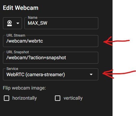

Once the Pi cam is sorted and crowsnest.conf has the info it's looking for, for me it's onto Mainsail to "Edit Webcam" and change to the above setting to get the real-time webrtc stream working (I believe) via the "rtsp" server which was enabled in crowsnest.conf above.  At this point my video stream is on port 8554 (the rtsp port) not 8080.  If I wanted to watch mine via VLC the url is rtsp://192.xxx.x.xxx:8554/stream.h264.  Which brings up another thing the video format is actually H264 (MP4).  For more detailed info regarding the format it's way out of my wheelhouse and you're on your own.  It is a "reach" to say I barely understand what I've done up to now...LOL
