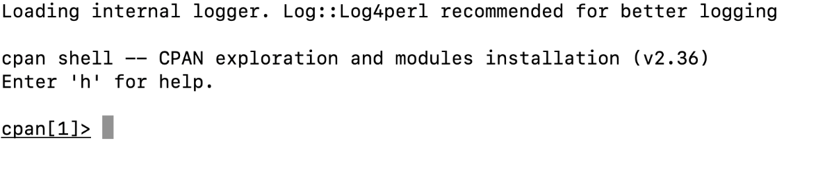

Next, in the terminal type
cpan
This will open a different shell:
You will need to install a whole lot of modules - read the subsequent messages from cpan as you go
First install the default download mechanism for cpan
o conf init pushy_https
This defaults to true which uses the latest install method.
Now commit these changes
 o conf commit
Next install the modules, one at a time:
install CPAN::DistnameInfo
install Term::ReadLine::Perl
install Mac::SystemDirectory
install File::HomeDir
install Path::Class
install Path::Tiny
install String::Escape
install Term::Choose
install Text::SimpleTable
Those were the modules I needed, there may be others
