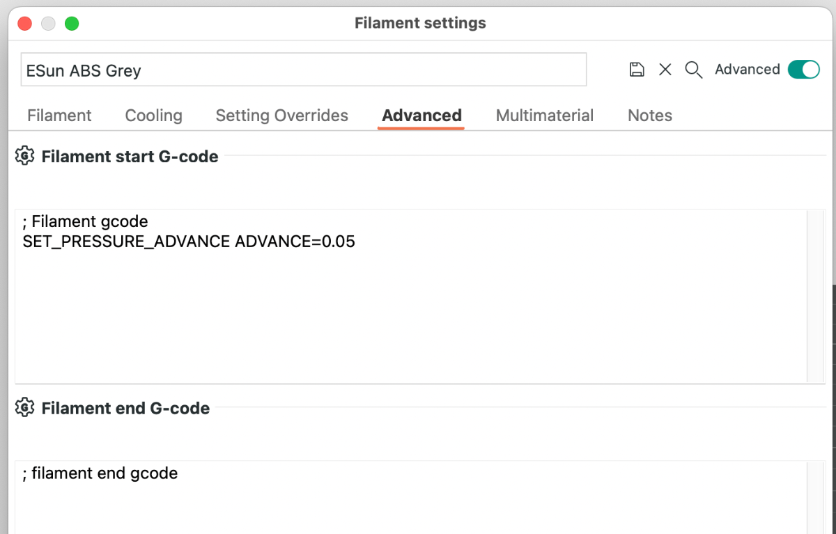

I have all the parameters set up in the slicer. I mainly use SuperSlicer, but used Prusa in the past and am playing with Orca. Most of the settings affect the generated gcode, there are a few settings like temperatures that can be passed as parameters to print_start. You can also set up custom gcode in the filament definitions (for example, I se pressure advance there). From there, you set up your print_start macro to adjust to the parameters it receives. I never touch my config files when changing filament types.

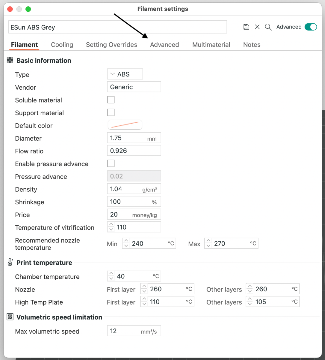

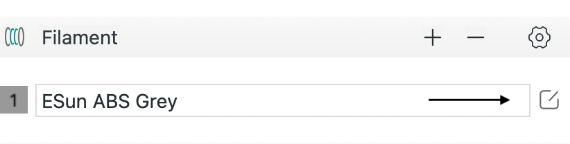

No  as @claudermilk said - only one printer.cfg file but multiple filament profiles set up in the slicer with custom gcode for each filament. (Temperature, cooling, pressure advance, etc.
In Orcaslicer this is setup here:

@mvdveer why don’t you use the pressure advance option in the filament tab?
I do have it in my filament settings (see above post - I am in the advanced tab of the filament settings to enter the code). I do a pressure advance and temperature tower for each new roll of filament I open, before starting to print parts.
Thanks, that's what I was looking for.
