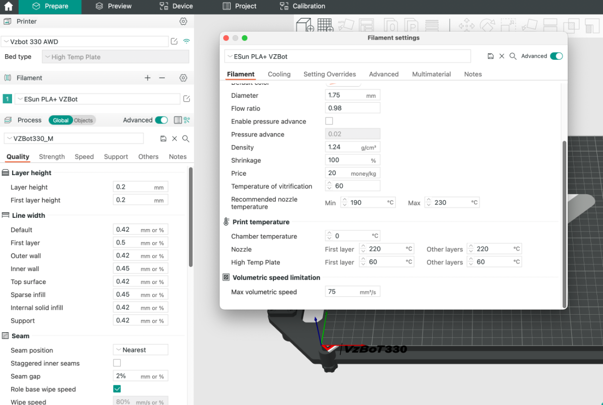

I'm trying it right now and I can't find the option to set the printing temperature.
On top there are 4 tabs.
Under the Prepare tab are all the settings concentrated on the left side.
As you read down the left from the top you see
1. Printer: Same as the printer setting son SS click the square with / icon on the left to edit
2. Filament: Set your temps by clicking the same icon as the print settings. Again, all the filament settings just like SS only in a different spot.
3. Process: Below that is all the speed, layer, etc, settings like SS.

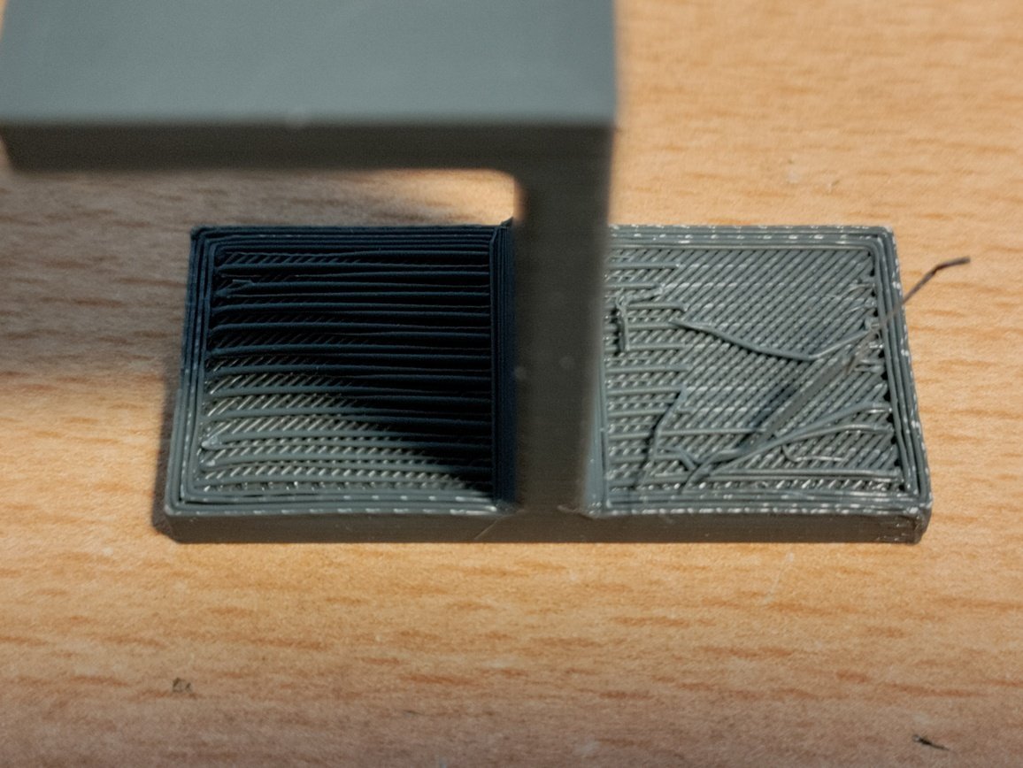

But the supports are insufferable.
Orca slicer has better supports. I just found tree supports with PLA was a bit tricky to remove - but boy do they do the job well!

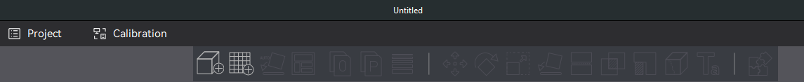

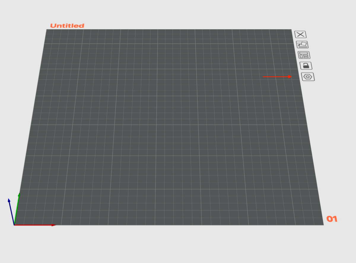

I don't think the UI is that bad, I'm already getting used to it. But there are grey areas as well. I don't understand what's the use of being able to give your build plate a name. Or why the window is always called "untitled". I've tried everything to give it a name but to no avail. The missing search functionality is a shame.

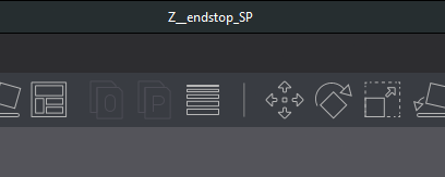

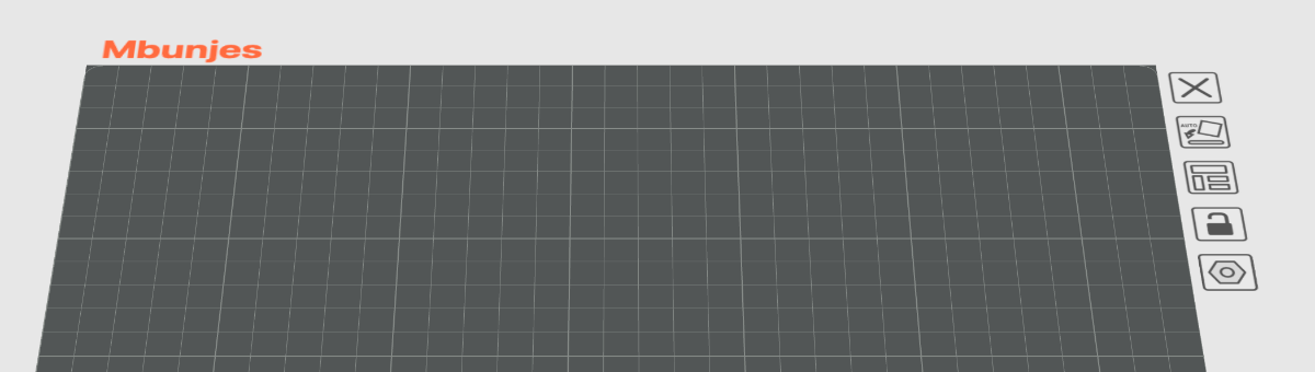

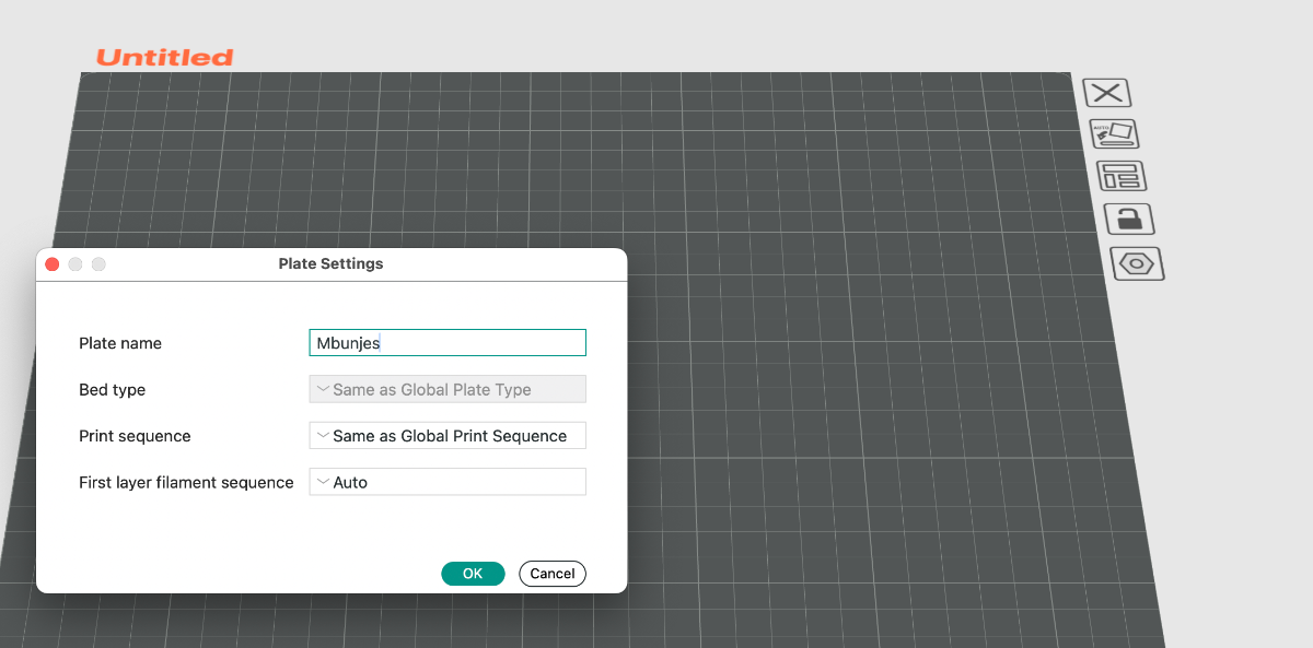

To change the name of the plate do the following:
Click in the bottom icon on the right:
Enter the plate name you want:
And Whala - there it is
You can do this for multiple plates - Name them so when it is saved you know what is on the plate.  That way you can just load a plate in future e.g Stealthburner, V2,4 Accents 1, Trident motor drives, etc

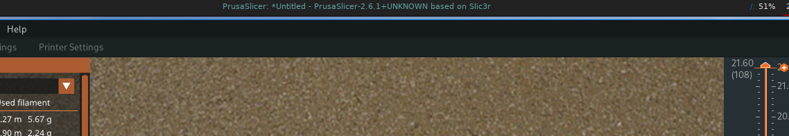

Prusa Slicer seems similar. I have a custom script that uses xdotool and xprop to display more details. If I save the current plate as a .3mf file then it will use that name in place of "* Untitled".
