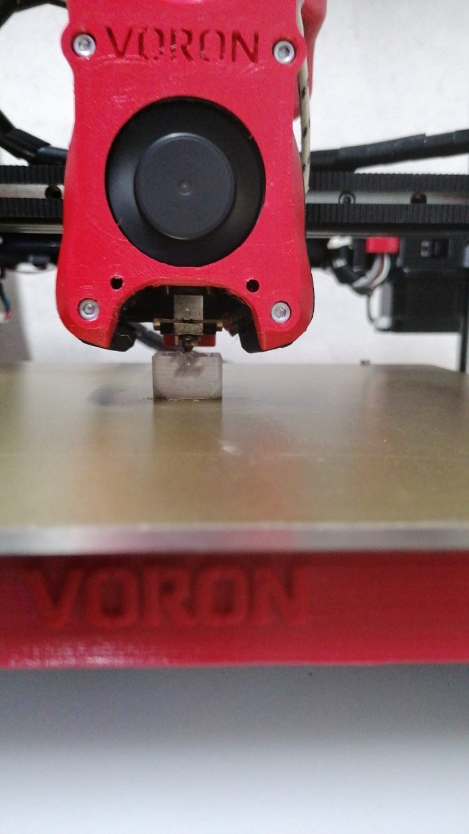

After a couple of hours (Read nearly a month) its printing.
1243211894_WhatsAppImage2022-02-21at20_19_21.thumb.jpeg.55ec0d43e14f39a02c310a2a09dec3d6.jpeg

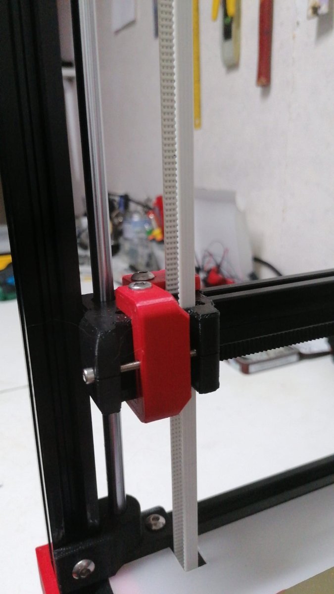

With some own mods .... just 8mm axis for the Z axis
184277765_WhatsAppImage2022-02-21at20_18_54.thumb.jpeg.fc05fbb797f8c442d091ff322e9e7ab6.jpeg

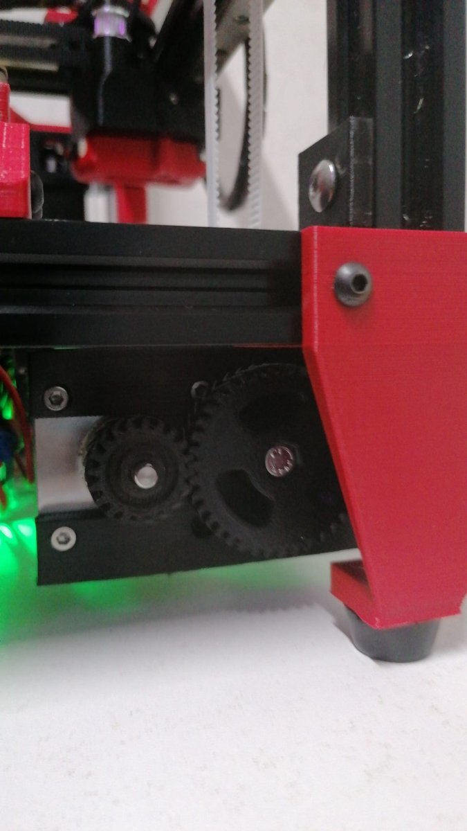

And instead of GT2 Motor im using Gears
2109166298_WhatsAppImage2022-02-21at20_18_41.thumb.jpeg.99e188db4381587839d974e5571039e8.jpeg
