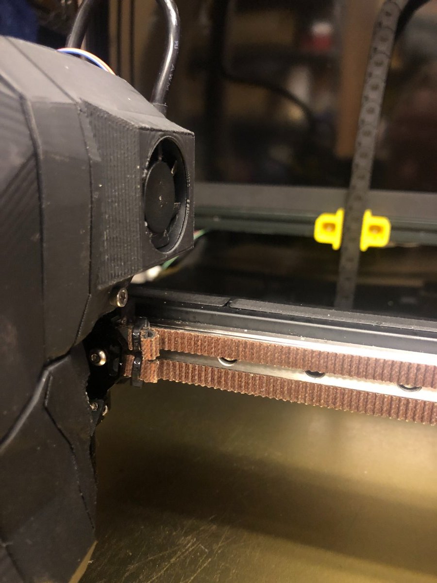

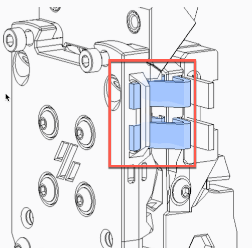

I'm curious about the excess belt ends that normally are tidied with the part of the Tap that moves vertically. On the Tap I'm using, which is printed, I've removed the belt from the two tidies on the edge, as it seems to interfere with the vertical movement, which is the point of this design. As highlighted in this pic from the manual.
I can see on this CNC version, that the belt tidies appear to be on the actual fixed part attached to the X-Axis. This seems more sensible and wouldn't restrict the front's movement I'm guessing.
Or (from other tap users) this belt through these tidies on the printed version isn't really an issue?
