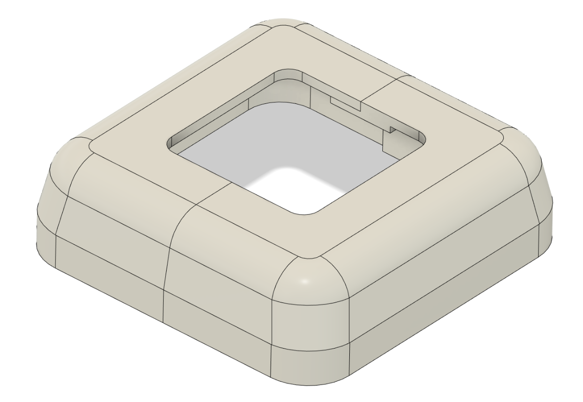

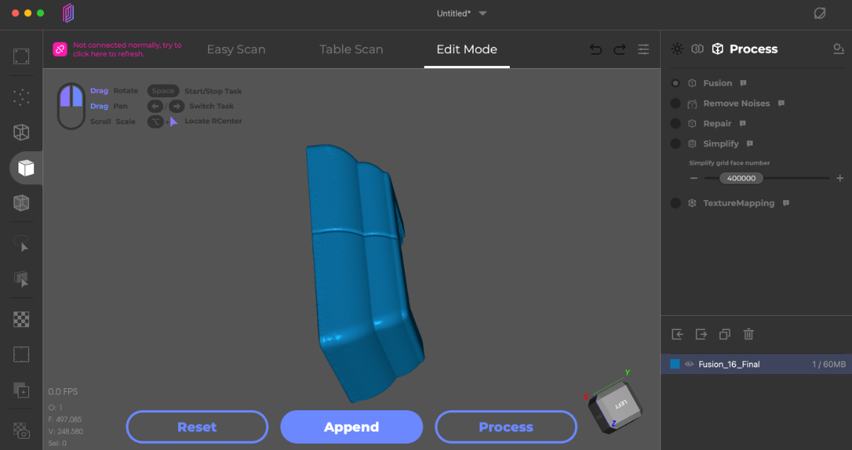

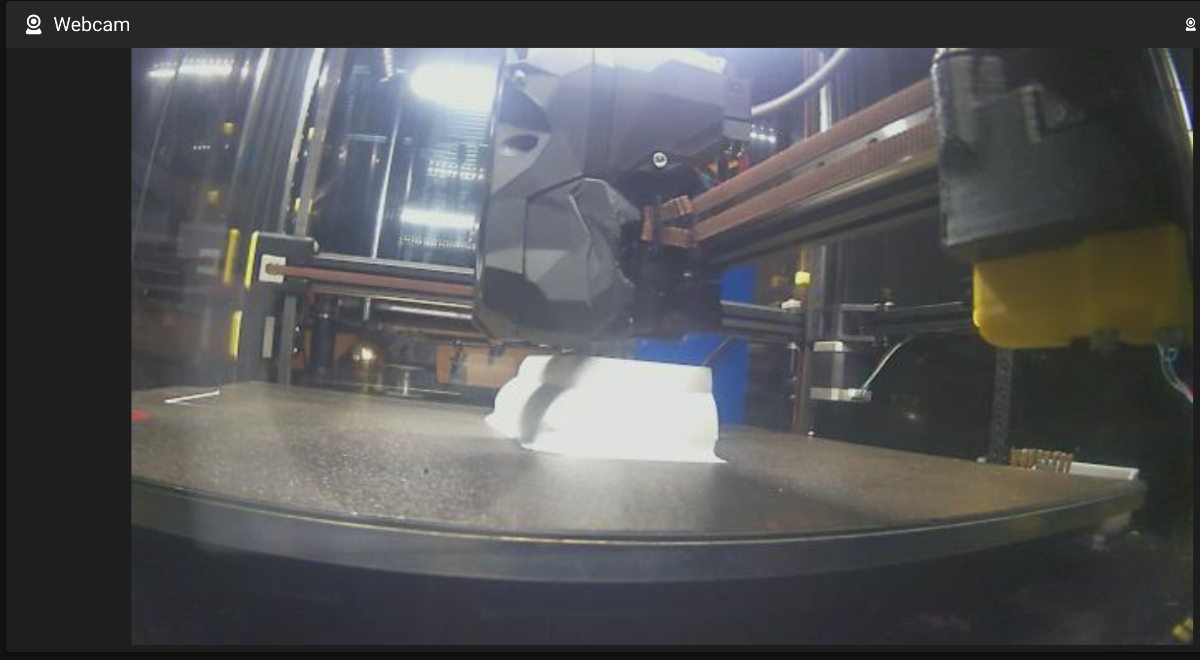

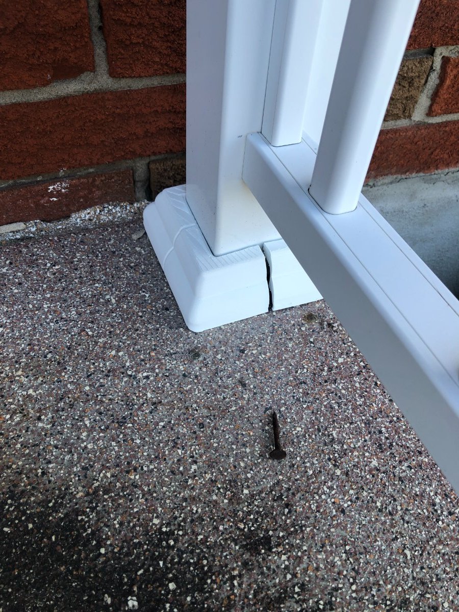

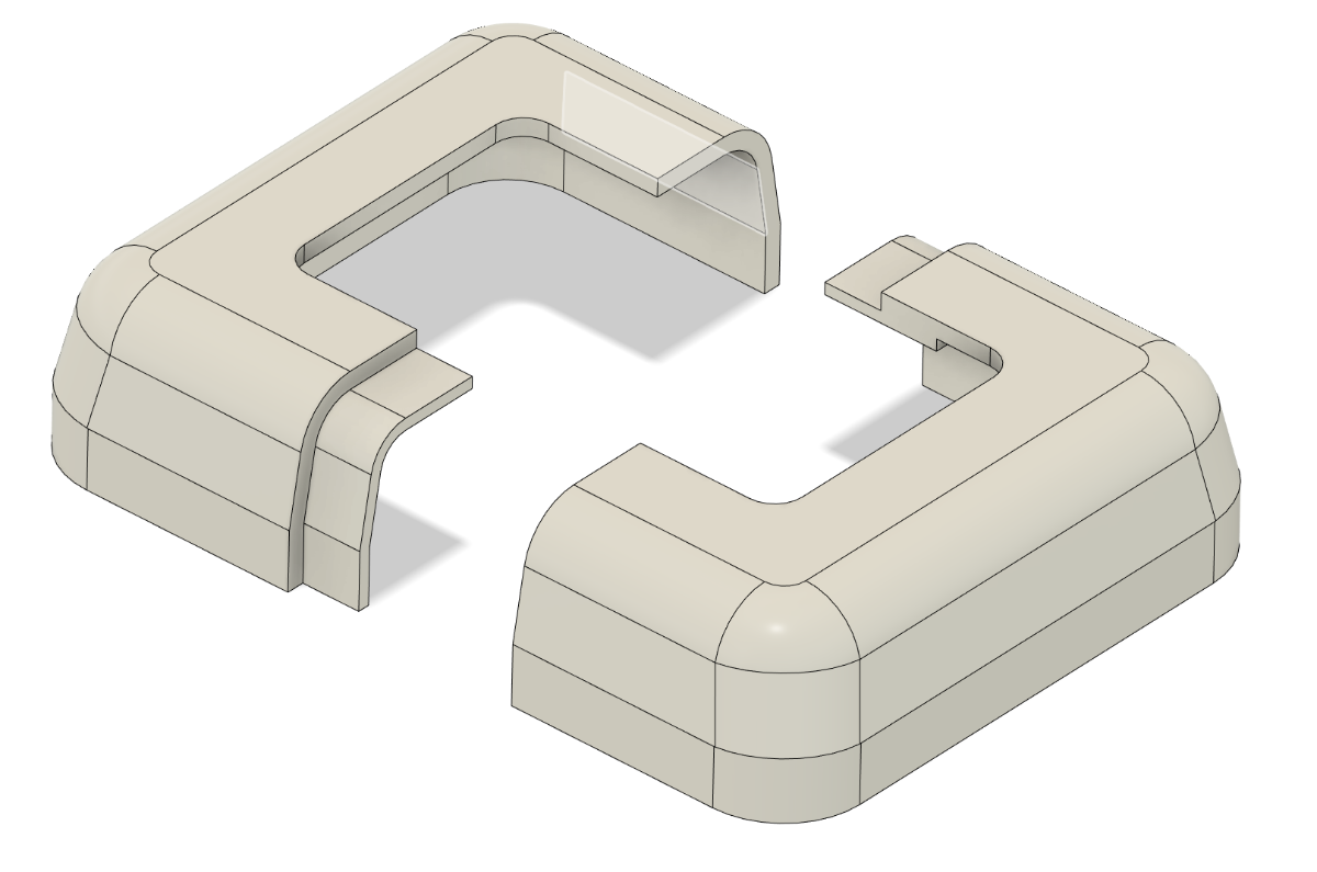

My aunt asked if I could print some new flange covers for her front entrance railing. The company is no longer in business she couldn't purchase new ones. The scanner is a 3DMakerpro Mole in the table scan method. The software is the 3DMakepro JMStudio, did multiple scans at different angles and the software did the alignment which worked out pretty well. You also have the ability to do manual alignment if required. Used Superslicer to scale the object to the correct dimensions. The filament is 3DXMAX Whire ASA pretty pleased with how it all turned out.
