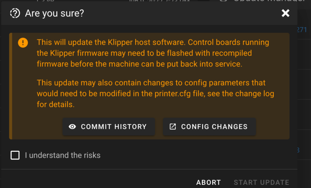

This update will require you to refresh your octopus board with the new bootloader firmware, now called katapult. (formerly known as Canboot)  From what I could gather, this is necessary to sync can2040 with the latest klipper update.
This update also requires you to refresh the firmware on the controller boards, both the Octopus v1.1 board and the canbus board. (In my case sb2040).
I updated klipper and got the error "cannot connect to mcu", due to firmware incompatibility. Meaning the mcc's on the octopus and SB2040 had to be refreshed with the latest klipper firmware. This happens about once a year - give or take.

These are the warnings, and I suspect that was the issue.
