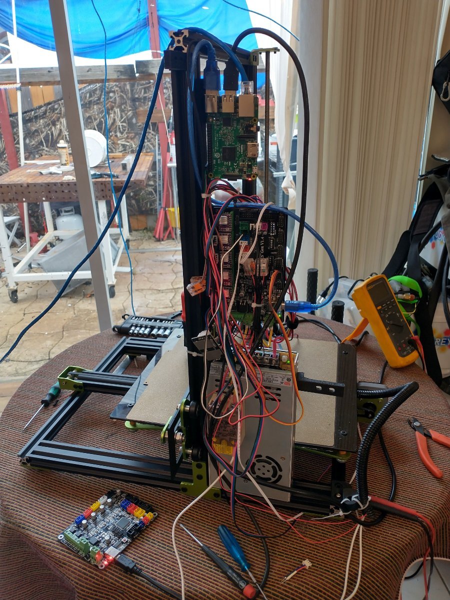

He gifted me his old Tevo Tornado after upgrading, I ran it until the extruder wore out and then he helped me upgrade it.
I introduce you to the Vornado Mk.I
Afterburner is running a Dragon HF and 65watt heater, upgraded to klipper, TMC2209s, upgraded PSU with a meanwell, replaced burned out heater pad with 750watt one.
Grabbed what I could find on the nets to remix into a standalone printer.

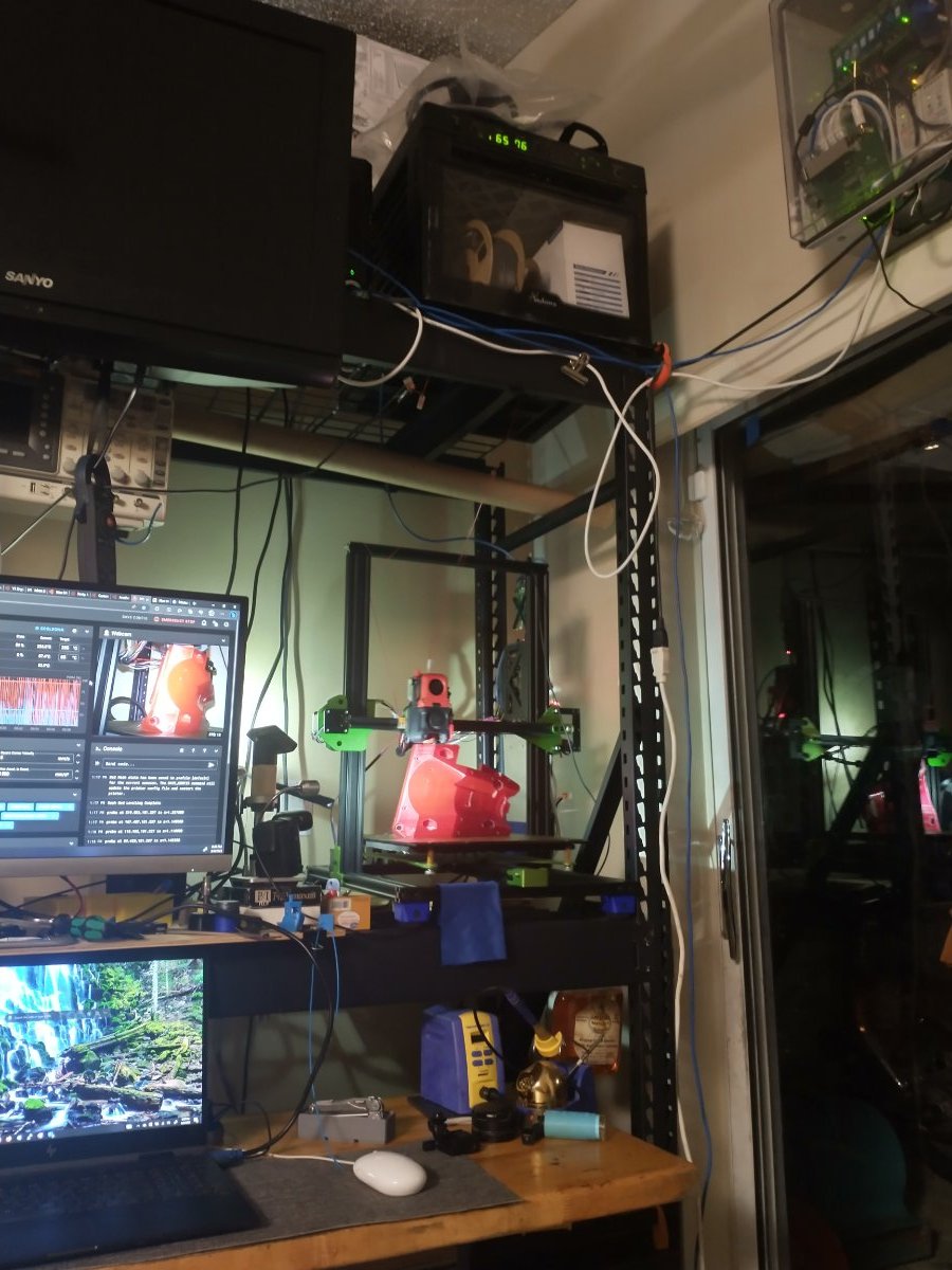

You can see my wrapping up the largest print i've done to date, at 485 grams it is the "Core" for my next build; MPCNC Lowrider v3.
