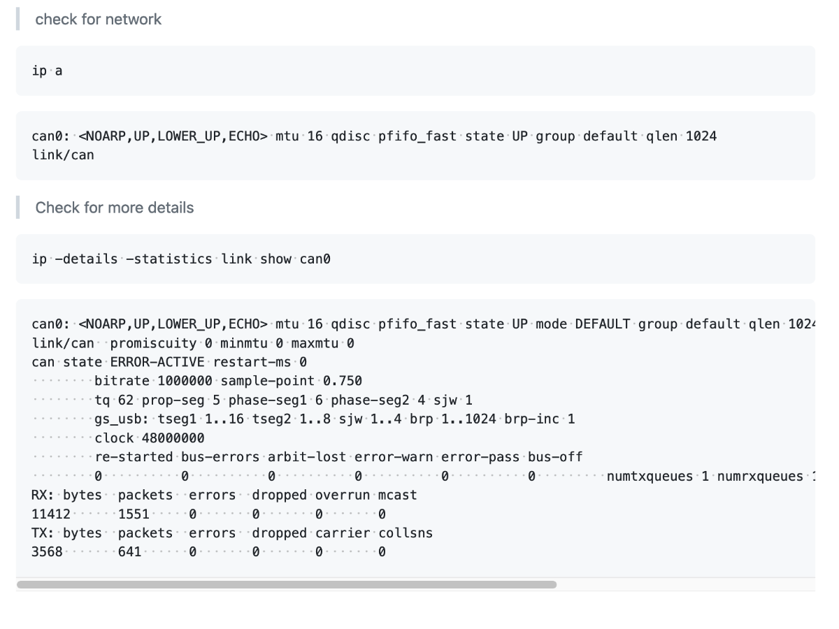

Is your can network up and running? If not you will not see any UUID's
You probably done this multiple times, but to recap:
