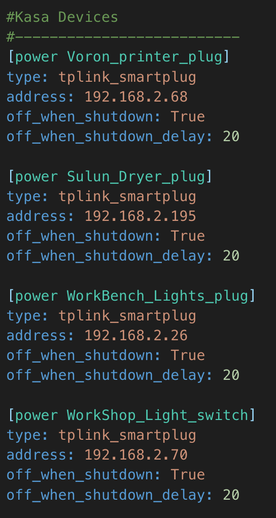

Moonraker can control the Kasa smart devices, enter info shown in the photo below

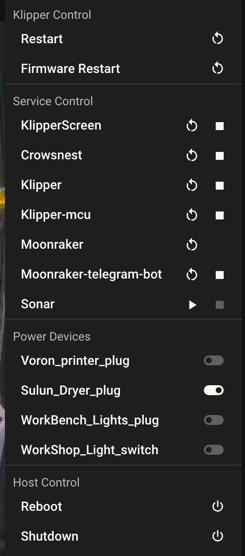

Devices will show up in the "Power Button" pull down menu
image.png.bfc8ee5bc743e7ec53f55ab4533544ee.pngimage.png.cabc4cea17fea6a54ad327a851d45a3e.png

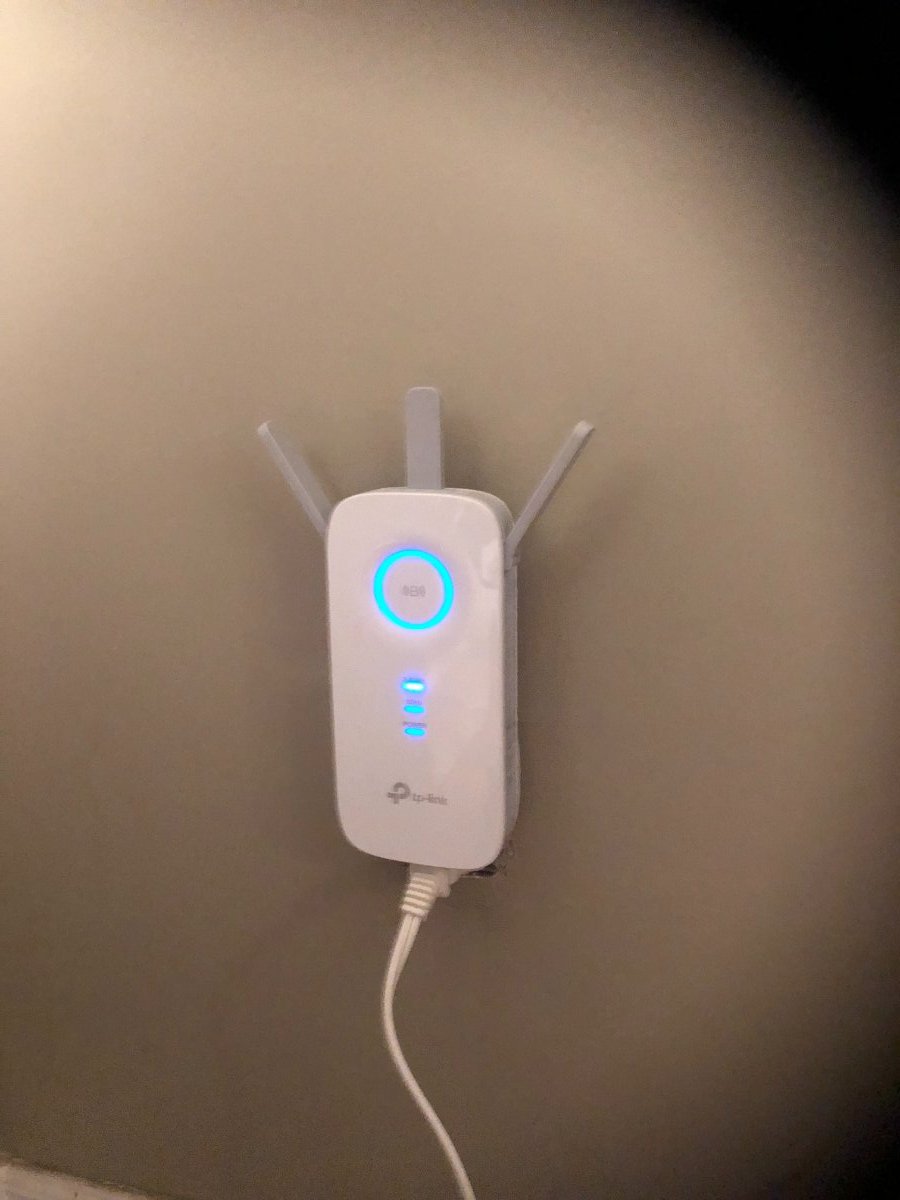

My workshop is about 60ft away from the house. I also use a TP-Link Extender to get wifi into the shop, the only drawback since devices are on the extended wifi connection they don't show up in my fibre-optic router so can set a static IP address.
