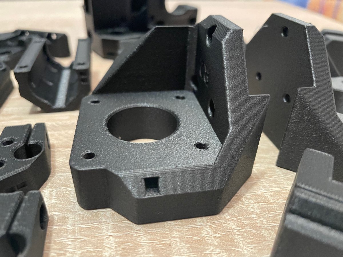

I usually only buy Esun filaments, since they are relatively cheap in Europe and usually good quality.
Esun PLA+
Esun ABS
Esun PA-CF
all print fine.
For ASA materials, I usually go with Extrudr Durapro ASA.
For really strong technical prints Polymaker PA6-CF.
