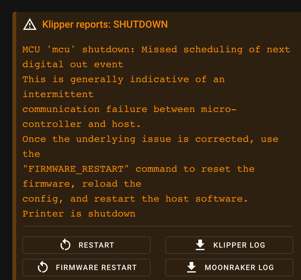

I was getting this error as well plus other ones. Turn out to be the /etc/network/interfaces.d/can0 file was set to auto Can0 and needed to be allow-hotplug Can0. My setup is a BTT Manta 8P V1.0 (no Canbus on the motherboard) connected to a BTT U2C Canbus adapter. No errors since I made the changes, the solution was suggested by Tom White on the BTT Official Facebook page. The printer was shutting down after every print plus a bunch of different communication errors. I know this is not your typical setup but if someone has a similar setup this may be a solution because the U2C documentation tells you to use Auto Can0.
