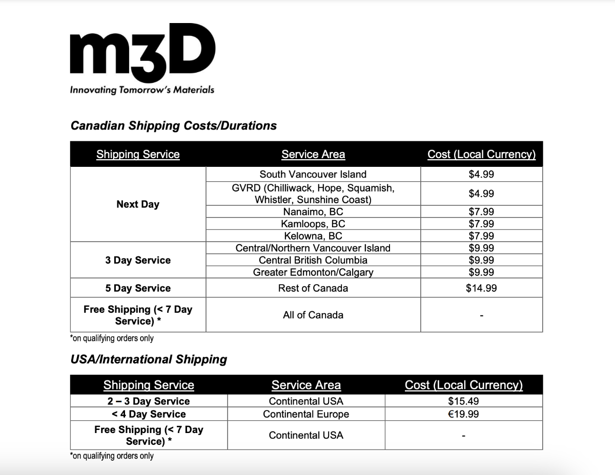

Heard a lot about these filaments and would love to try them BUT the postage to Australia is similar to the cost of the filament, which essentially doubles the price.
  • Sad 1
I like there stuff too, but there shipping sure does get out of hand.
I wish they would look for a distributor in the U.S. or offer bulk shipping like so many other
companies. Like free or reduced shipping over $50, $100, or $150 purchase.
I would use there product more often.
Yes, I was talking specifically about Sparta; I know Matter has much better shipping policies.

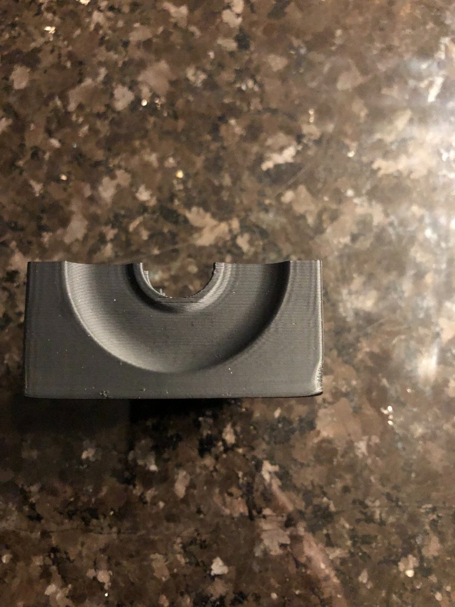

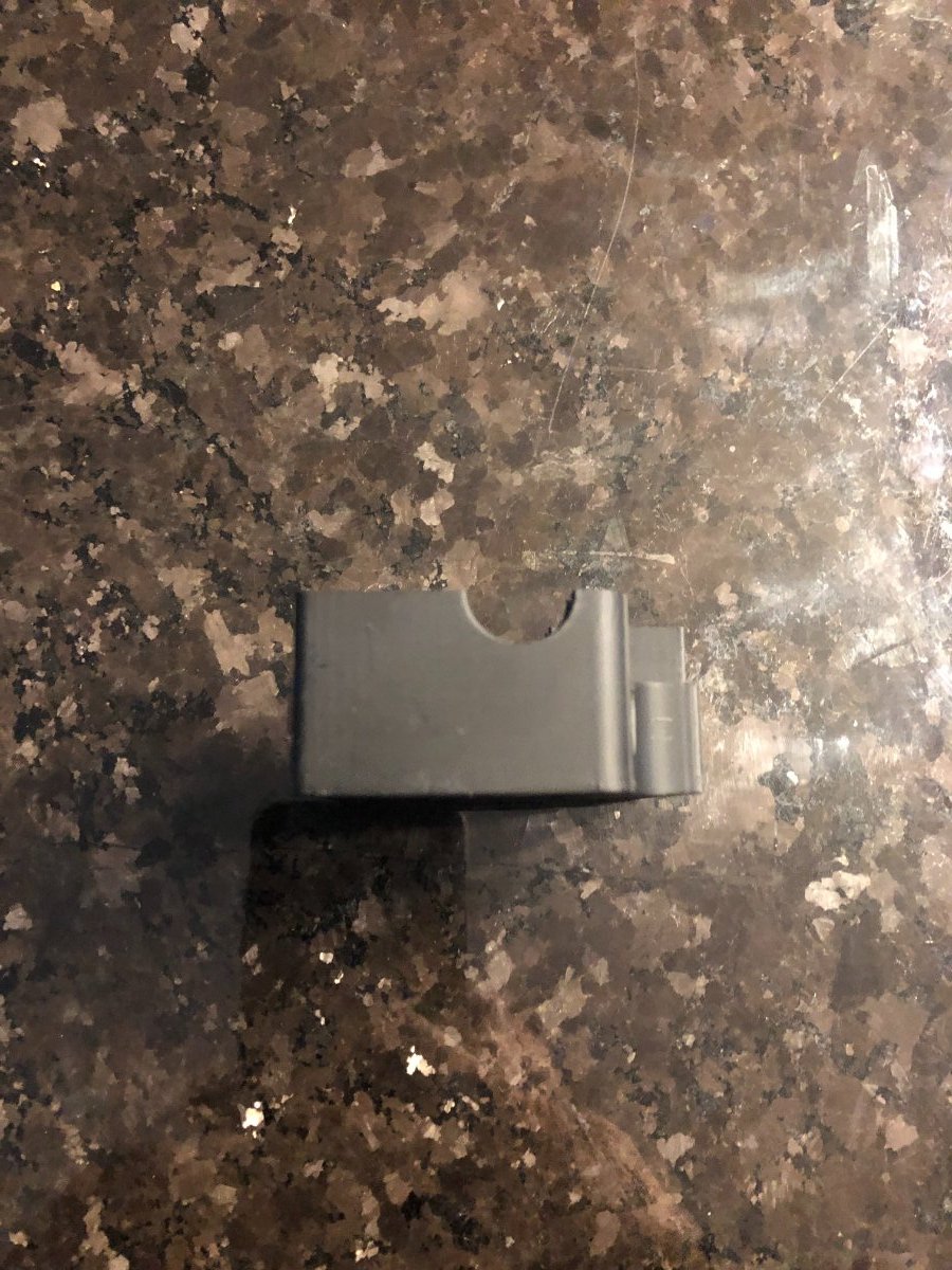

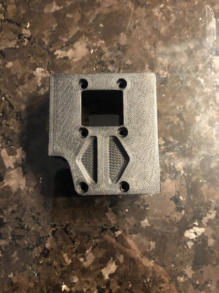

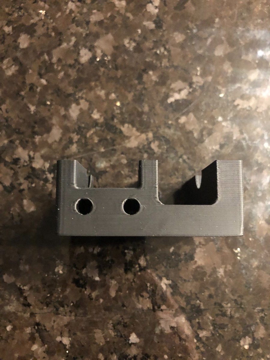

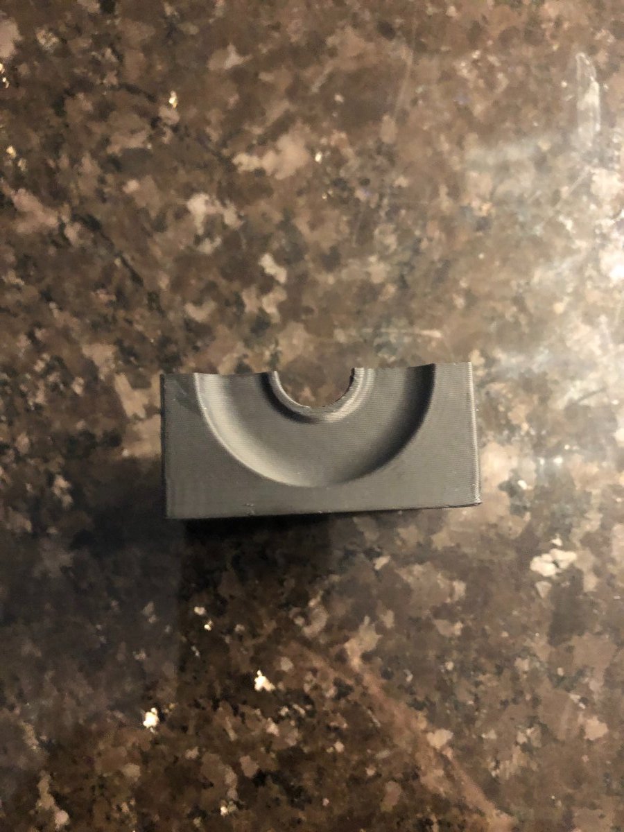

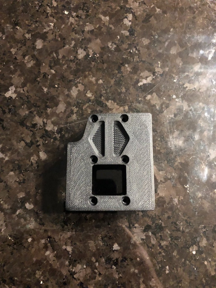

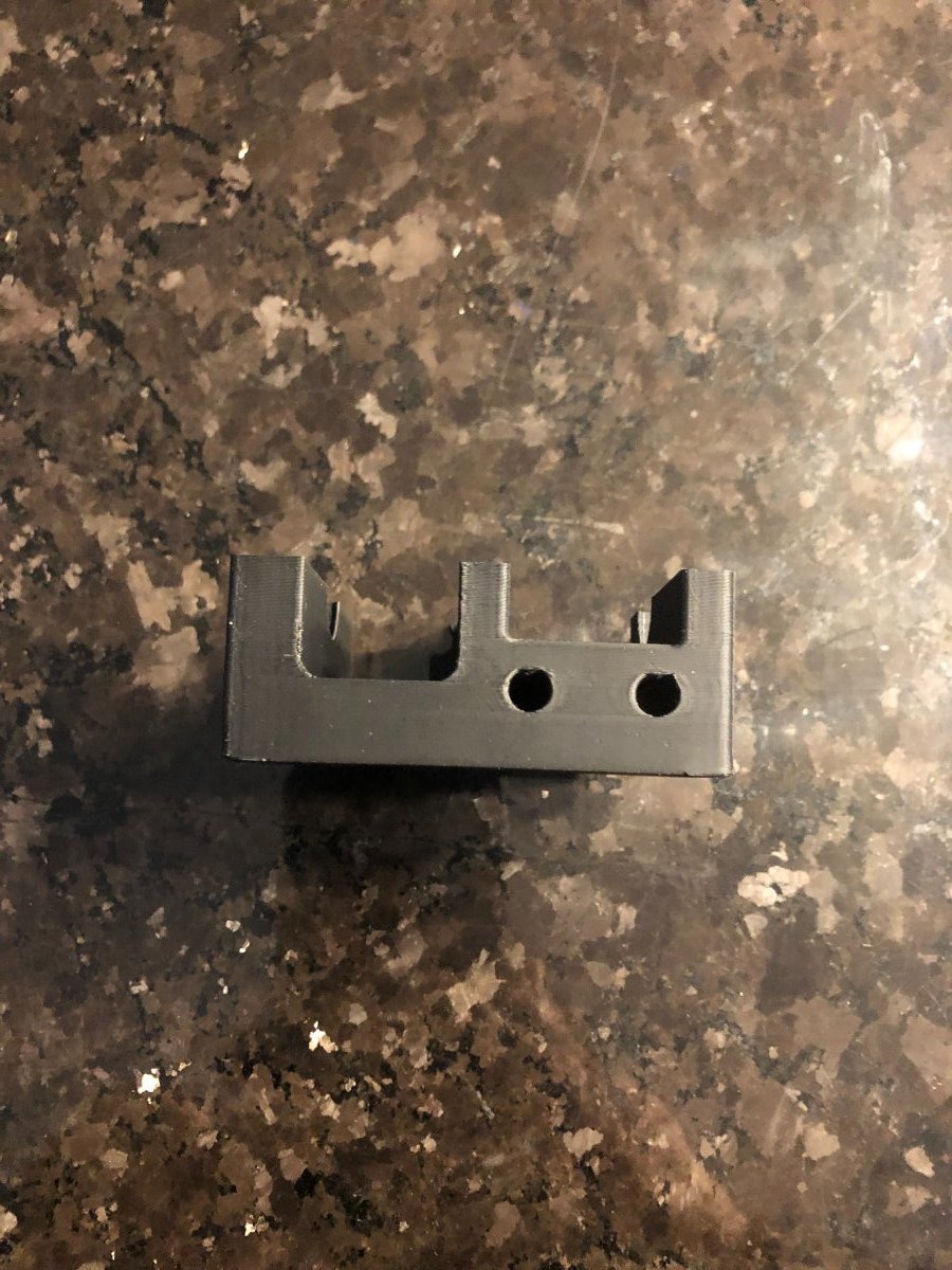

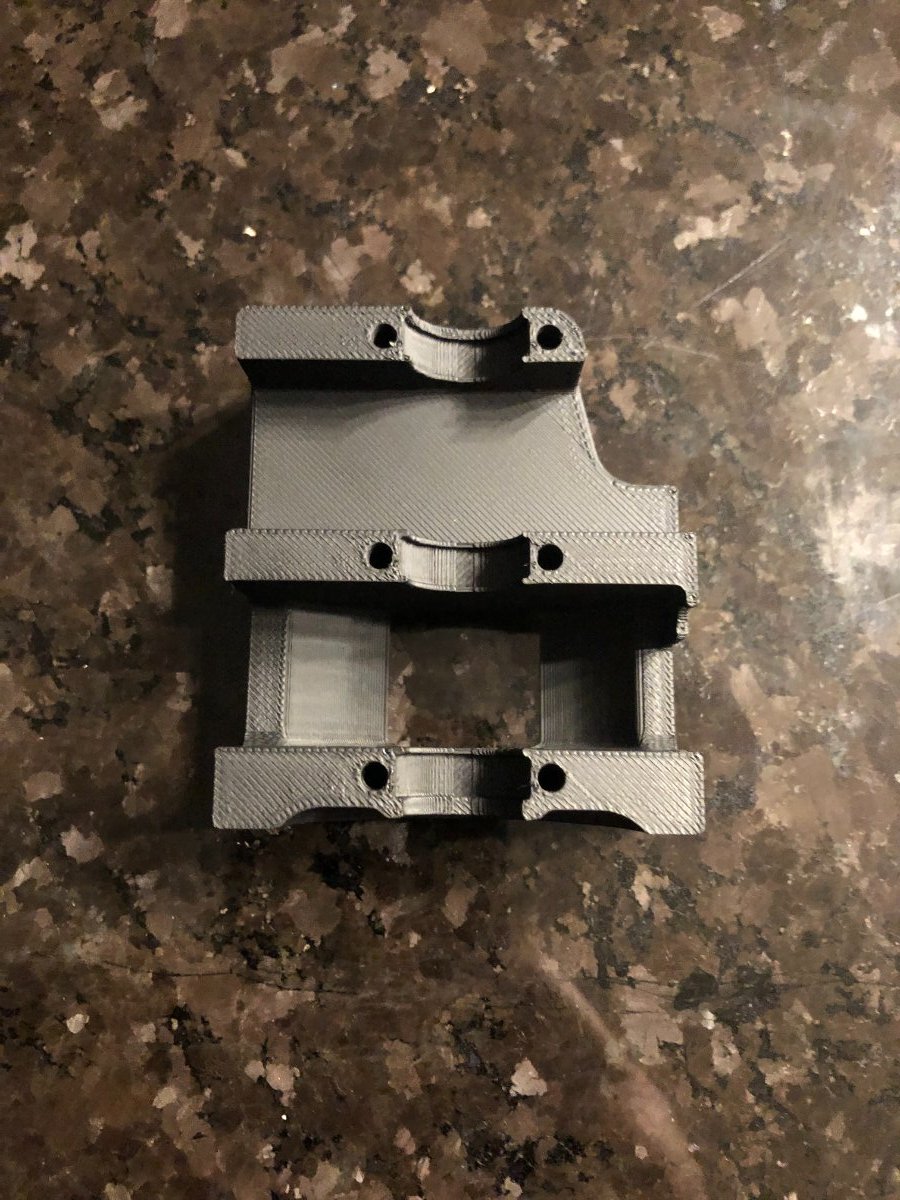

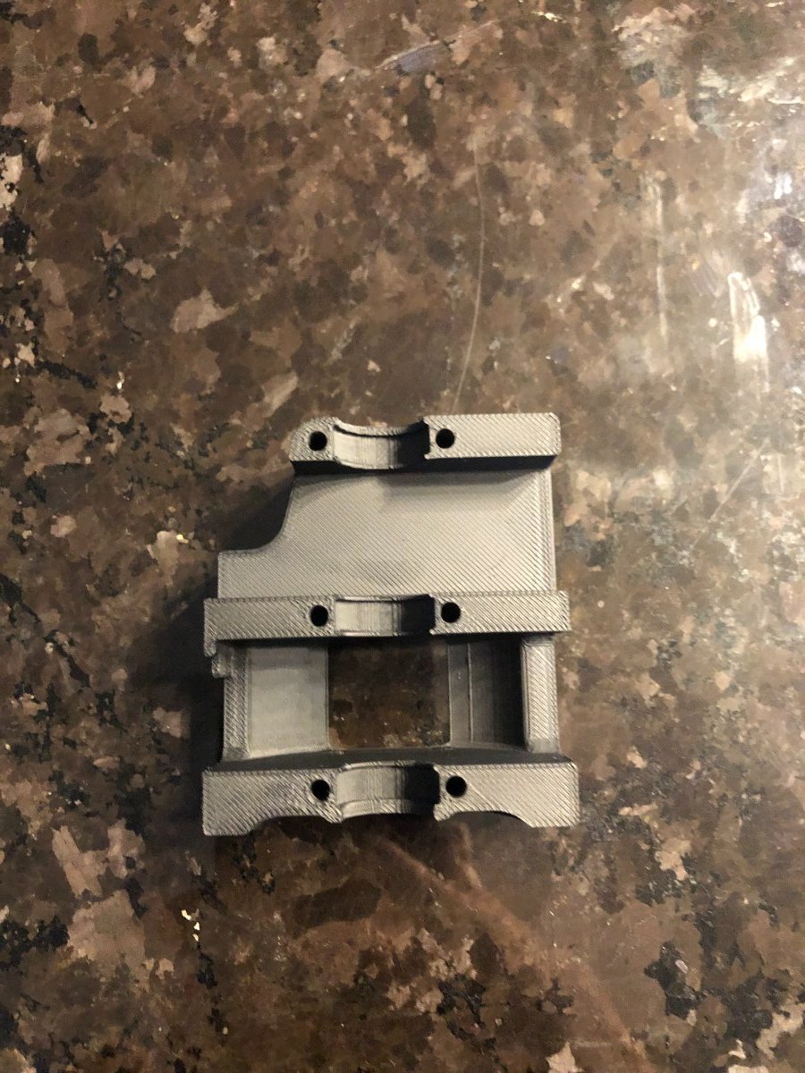

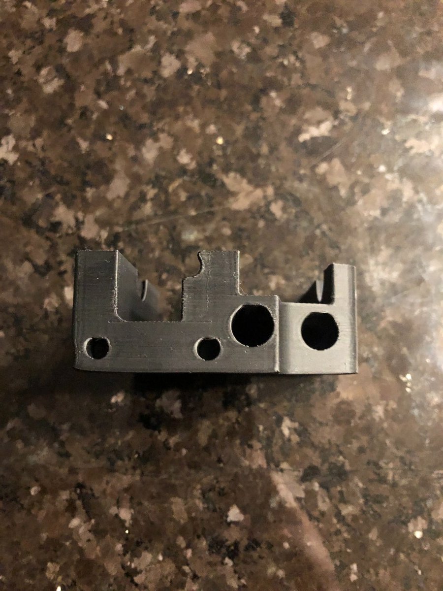

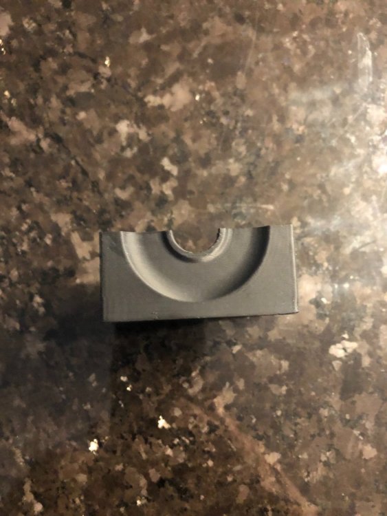

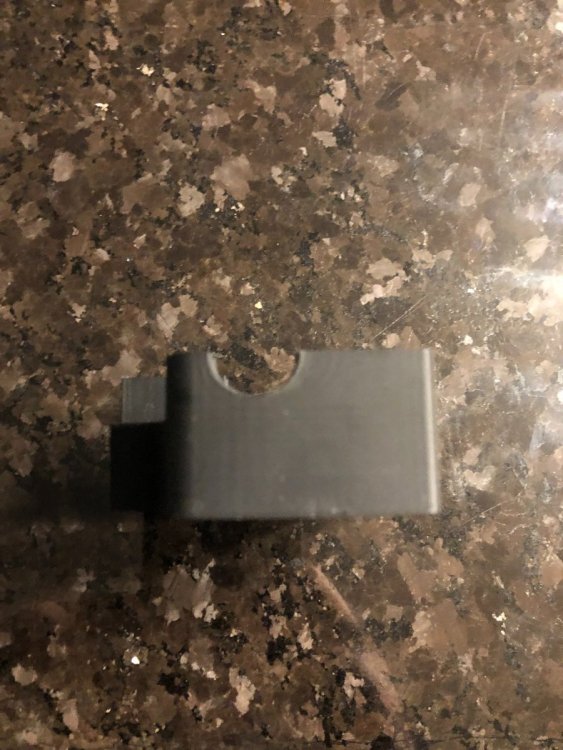

That too bad! I'm almost there dialling in the their filament. I just got some corners with some slight warpage but the rest looks pretty good. Sunlu S2 @ 60C, first layer 2.5, 245/110 fan ramps to 5%, chamber @60C bed fan @20%, QGL and Adaptive Bed Mesh. Next print will have brim ears and see if I can get rid of the warpage.
What do you think any suggestions?
Looks really fine indeed, like the color too, I love a good matt color.
Looks like small markings of being just a little to close to the bed on first layer..  (waving pattern) this could make the warping worse.
Looking at the photos again, maybe its a optical illusion, maybe not.. I see some waving, but the distance looks ok I think.
Thank you for the suggestion to look at my first layer. I want from 2.5 to 3.0 and it really helped with warping!
