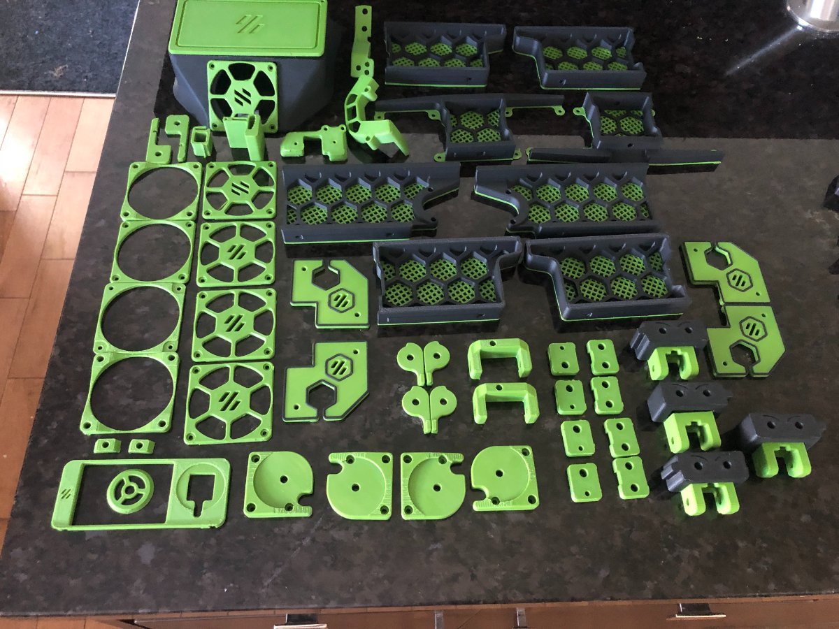

I'm not sure it's the same gap your talking about, but I recently had a request to create a 2.4r1 version of my mesh infill skirt mod.  The guy said there was an odd gap near the tail of the side skirts, and z pulley block.
If you go to the printables link below, click "makes and comments",  then click "view 10 more comments",   you can read through the whole discussion and see the conclusions.
https://www.printables.com/model/474406-voron-24-skirts-with-hex-infill-250-300-and-350mm-/comments
I believe we found the skirts for the 2.4r1, with the longer tail that fits those z pulley blocks,  here:
