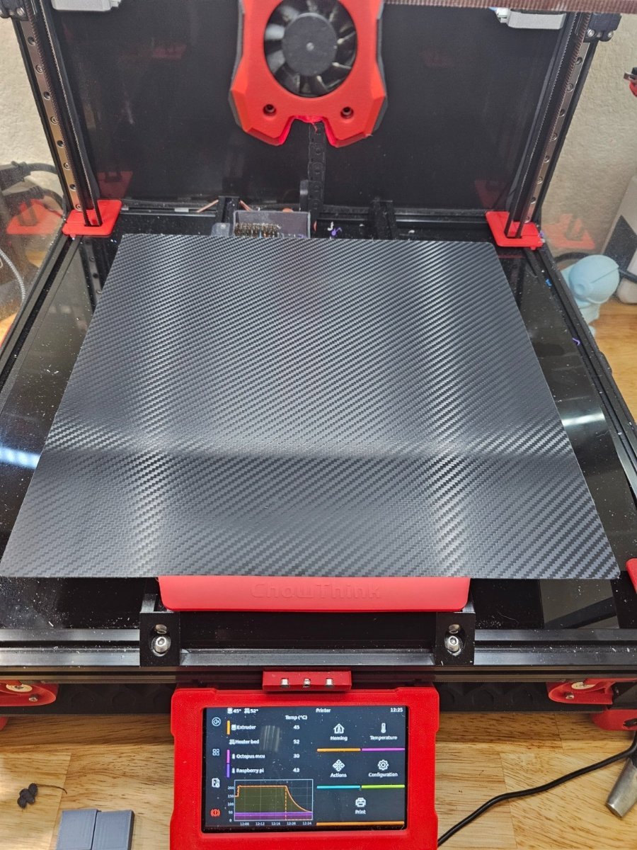

Here are my results and initial thoughts...
It looks really nice. @fanplastics The one I got from Amazon is a Chowthink as you had mentioned. I paid $30 on Amazon, it came with a self-adhesive magnet sheet, one double sided CF spring steel sheet and also one double sided textured spring steel sheet. So overall I'd say the Amazon purchase was a good value. It also came with a couple red silicone covers for the tab that you affix with supplied double sided tape.

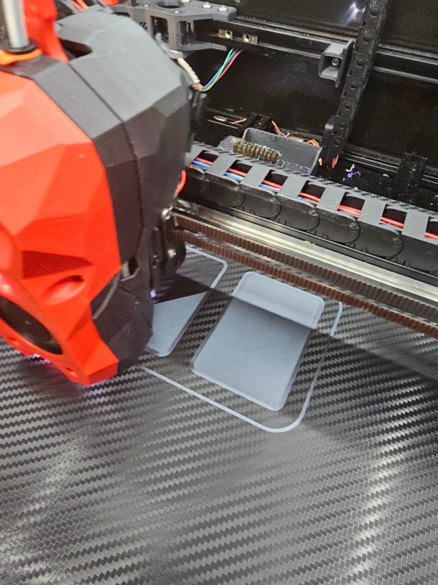

At first I had a few sticking problems but, a good wash with soap and water and a wipe with alcohol and after a couple prints and a little z-offset adjustments, I got good adhesion and an excellent 1st layer.

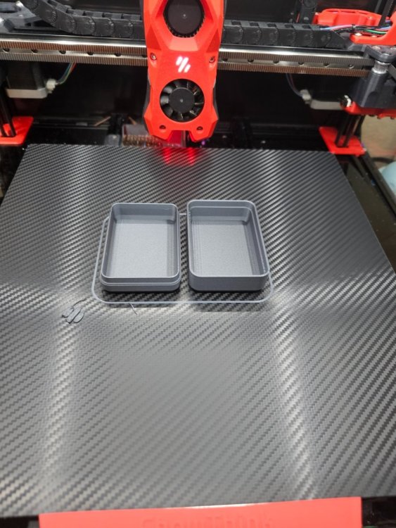

Finished print on the bed, I ran it a little bit hot 210 nozzle and 70 bed. 1st layer speed was 30mm/s, 150 inside and 100 outside.

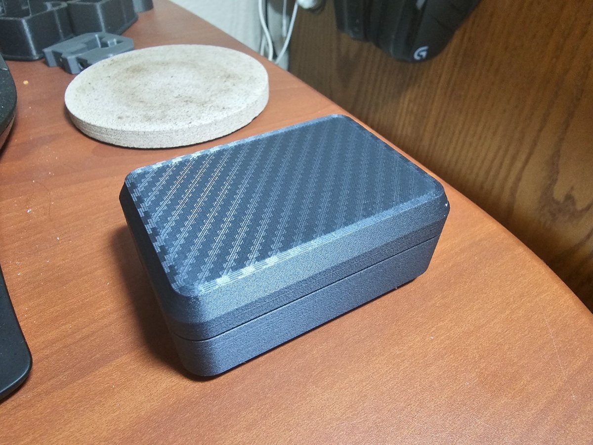

And here's the final result. Filament I used a CF filled PLA from Ziro filaments. Printed at .2mm layer height with a .4mm Diamondback nozzle.

Thanks, I'm very impressed. I think the takeaway, for me anyways, is... It's good to have options that go beyond just smooth and textured. With the box print, I think I hit a lucky combo with a CF texture on CF filament. From a practical standpoint, If I need something to have a smooth surface, I would go with the CF texture.
