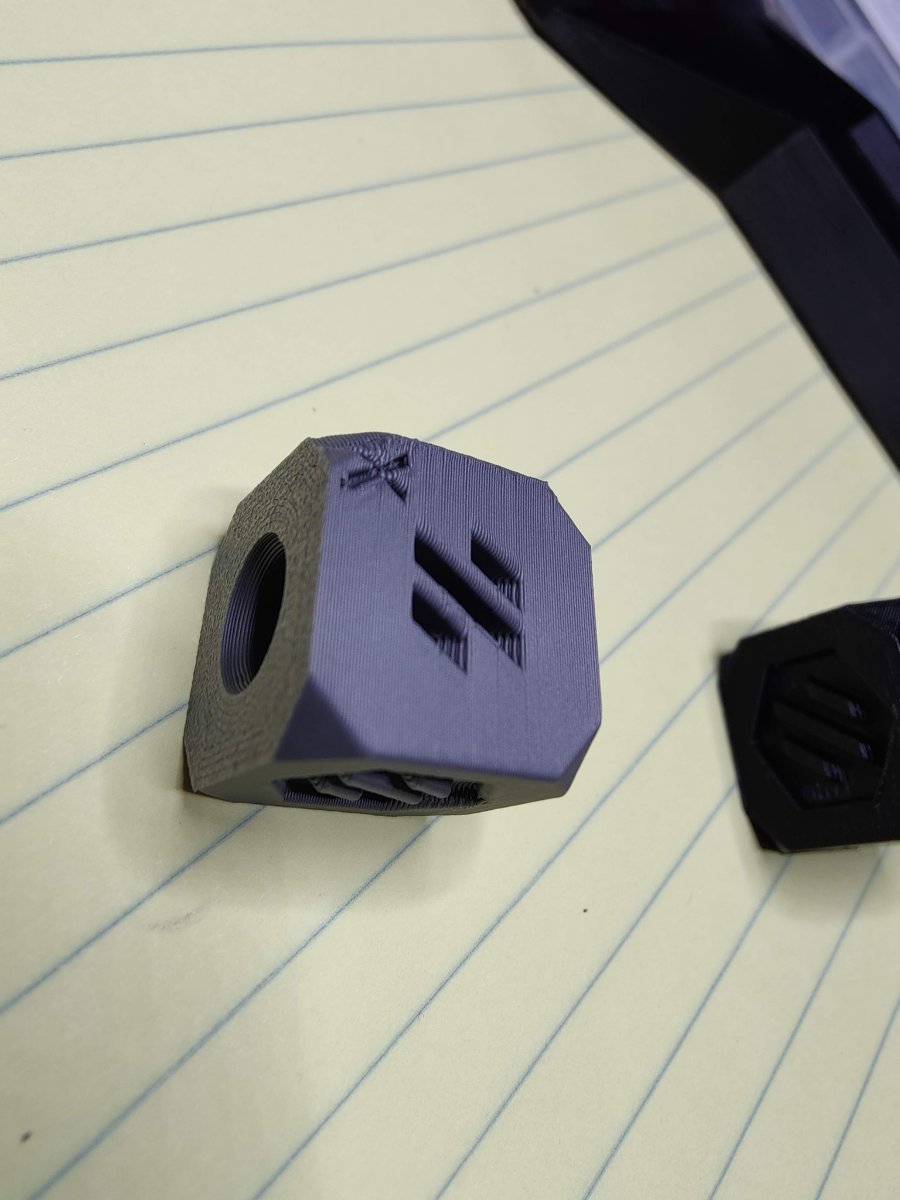

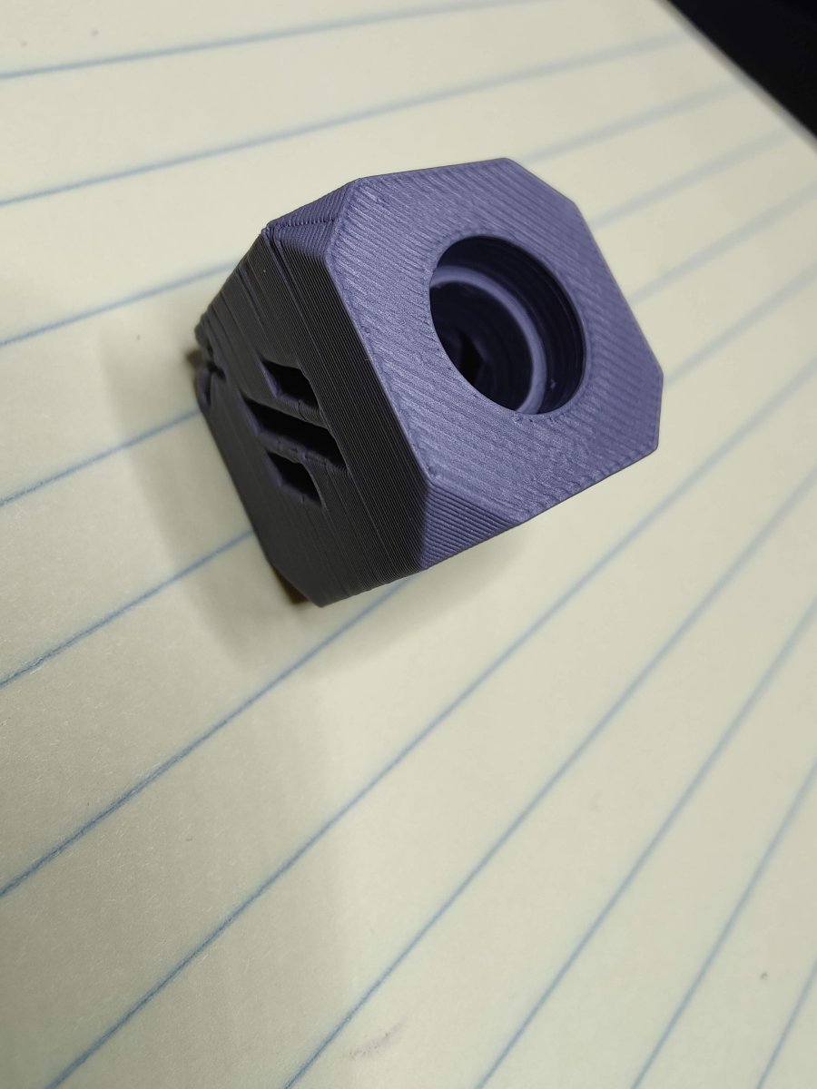

try 255.110 First layer then 250/100 I just did a cube on my Voron and it turn out all most perfect I have a little more trouble on my Ender5Pro Mod printer
my Extruder Multiplier is 0.924 my profile is pretty much based on Ellis Tunning Guide .
There a minor defect on that edge because the seam's there but the rest is perfect .
