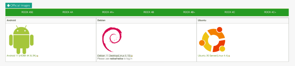

Got the Rock 4 C+ and I can state that it does not boot mainsailos. When I have time will play around to see if I can get klipper installed. According to the website there are only 3 "official" images to install. Installed Debian 11 desktop but could not ssh or FTP into the board "Connection refused"
Seems this won't a board to use as an alternative the Raspi or Manta boards. Will keep playing when I have more time.
