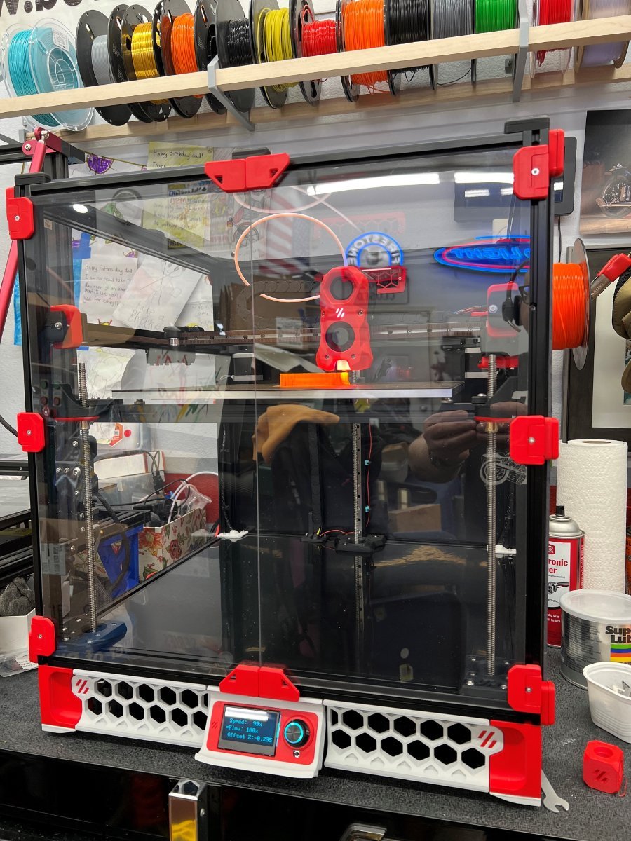

I ordered the Formbot kit for my Trident (350x350) on 1/11, and then while I was waiting for it to arrive, I immediately started printing all of the parts on my CR10S in FormFutura TitanX ABS. I also started reading everything I could about the build, while waiting for the kit....This is the first 3D printer that I have ever built.
The kit was delivered on 1/26, right as I was printing up the last few parts. I finished the build, and ran my first Benchy, on 2/4, so, ten days total to build it, working on it part time during the day as time allowed, and in the evenings.
I also incorporated the Clockwork2 Extruder, and Steathburner (still in Beta). I used a Phaetus Dragon High Flow hot end.
I should add, that I did spend the extra $ for the premade wiring harness, which IMHO, was definitely worth it, in terms of time saved. I had minimal connections to crimp (up at the toolhead) with MicroFit 3.0 connectors.
