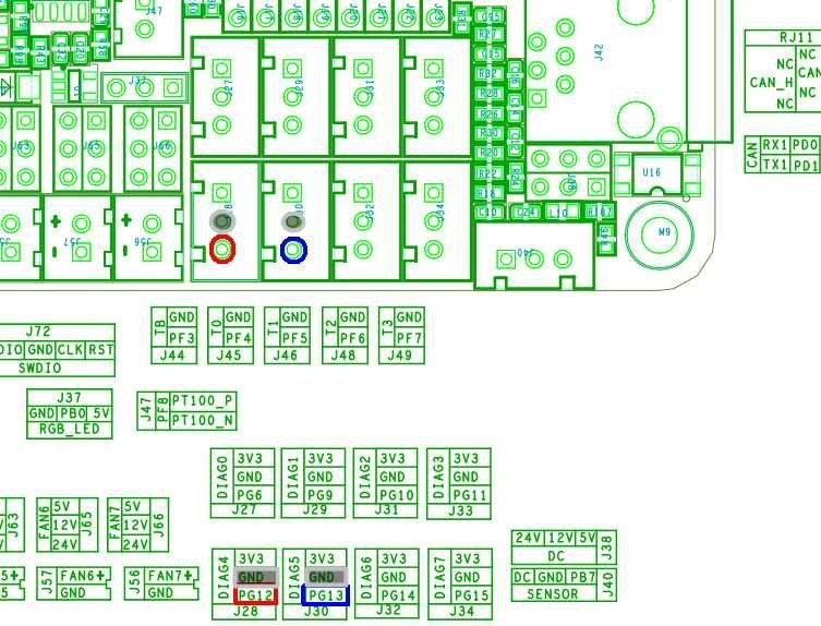

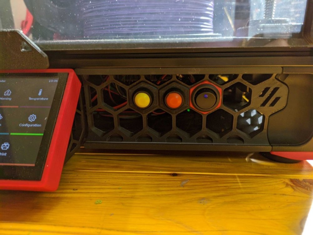

made me buttons for triggering unload and load filament as its fiddly to get there via Touchscreen for colour change
Buttons are triggering via my unused Octopus inputs PG12 and PG13 to ground and are only active if not currently printing or print is paused
