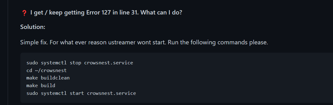

But, if I run the following command from the Crowsnest github, the cam will start working.  It works fine, with no problems until the next time I shut down the printer.  Then, after starting the printer again, no webcam unless I run this command again:
Any Idea how I can permanently fix this, without having to SSH into the Pi and rerun the script every time I want to use the printer?

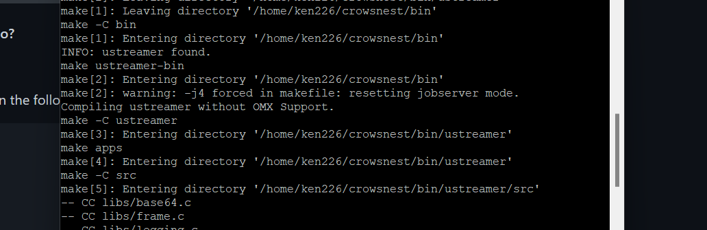

If it's any help, the closest thing I can find to an error when running that buildclean command, is this "warning: -j4 forced in makefile: resetting jobserver mode." :
