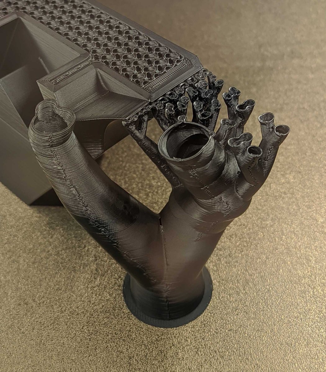

Conclusion: After 2 rolls of Filament having the part laying flat on the print bed doesn't seem to be the best solution, so get it up....hmm but then I need supports, not the best with Superslicer....so next logical Step is to use the current last PrusaSlicer 2.6.0-alpha 5 with organic supports. After transforming my settings from Superslicer to Prusaslicer and a lot of testprints I came up with inserting a few Support Blockers to the Part (otherwise the organic supports do unneccesary strange things (enthusiam now again 80 %):
and sliced it , looks great and interesting
so this is currently printing

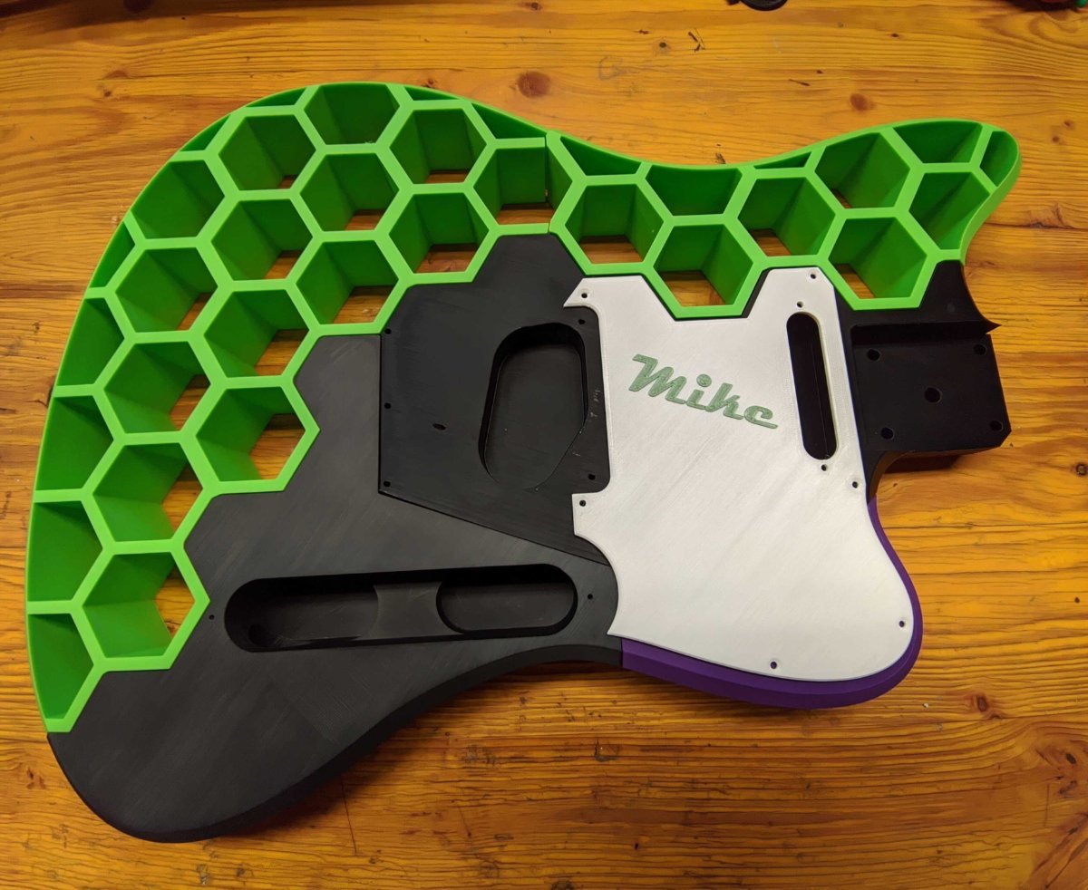

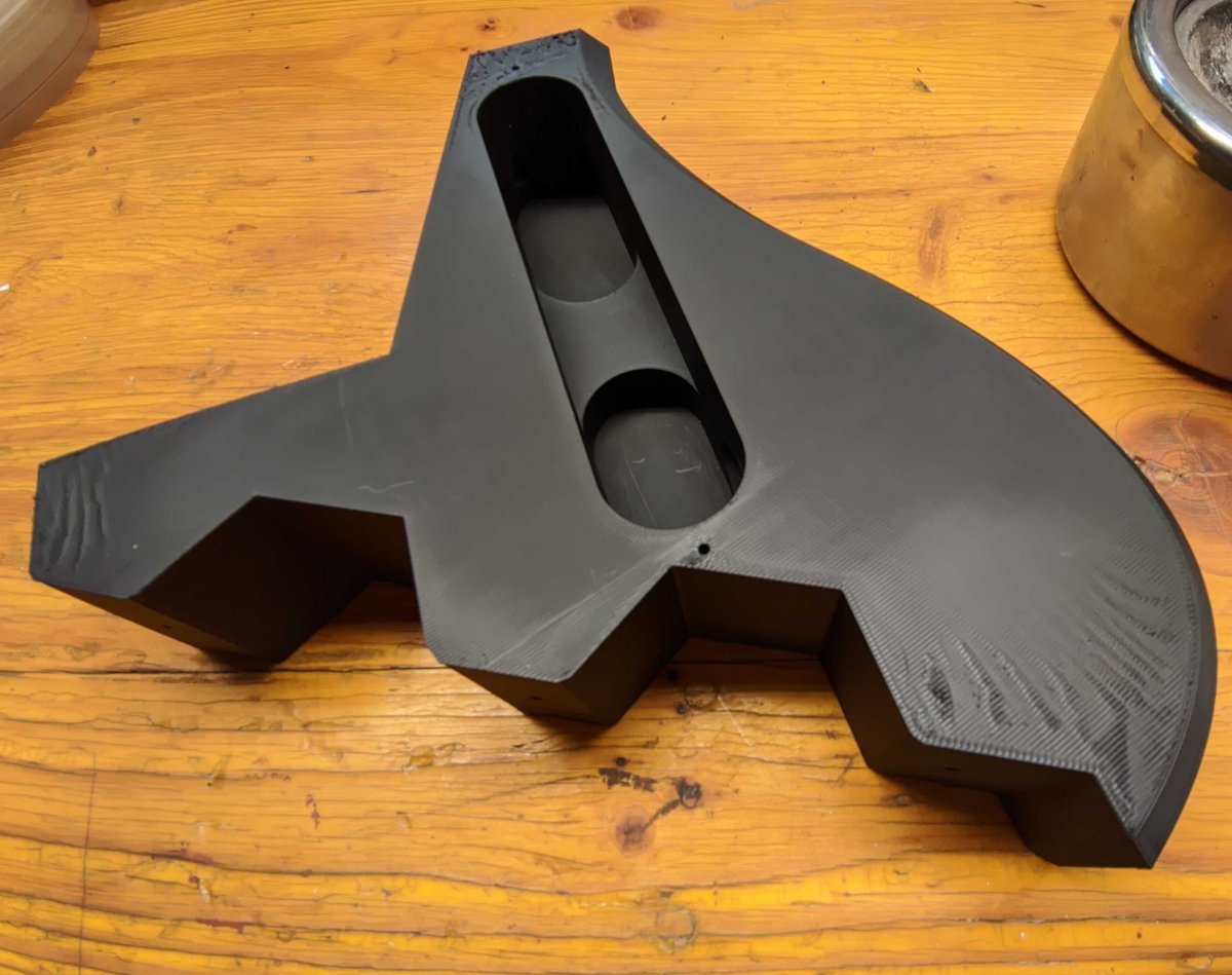

so it continues, finished printing all the parts
....and next problems occured.....

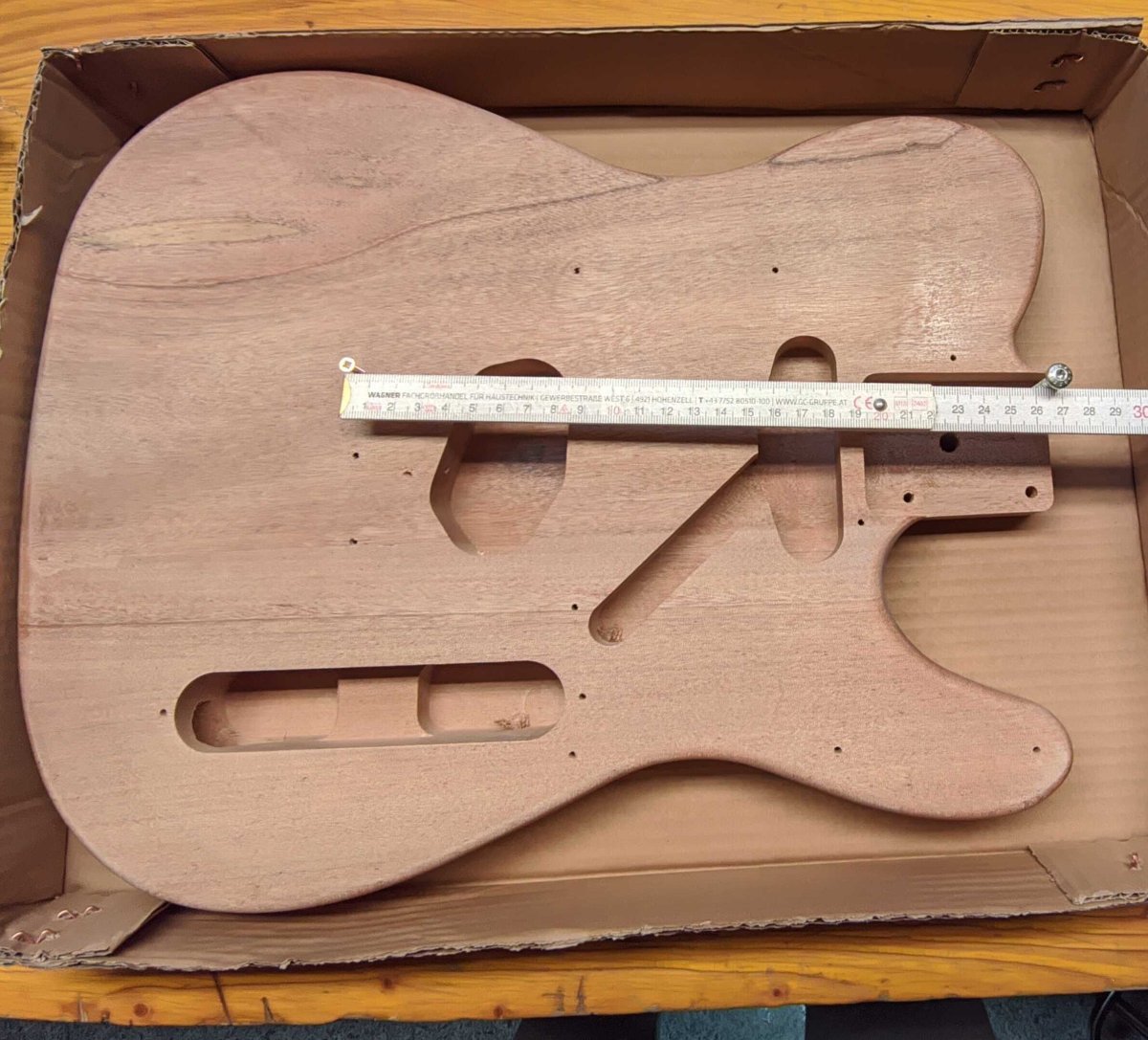

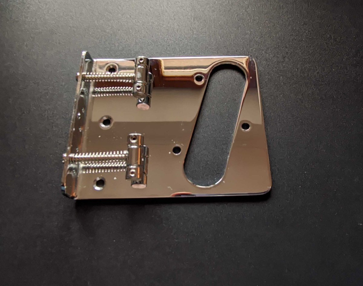

seems to be most important to order the guitar kit itself before!! printing any parts as it will be delivered with changing parts and of course I got a different version as stated in the original download package so it doesn't fit to the core part with the 5 Screw Bridge ( my kit has a3 Screw Bridge with different screw positions, deeper Pickup)

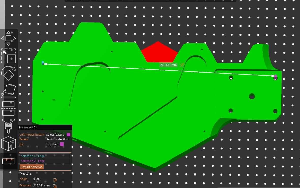

it's important to measure the distance of a Bridge Screw position  to  a mounting hole of the neck on the delivered wooden Body of the guitar kit
and compare it with lots of alternative cores from the remixes on printables. after comparing lots of cores with the new measurement tool in PrusaSlicer 2.6.0-alpha 5 i found the "Correct placement of American Thomann 3-screw hardware" of this alternative fits my hardware
this is essentially important for correct sound of the guitar to have the correct base length of the strings !!!

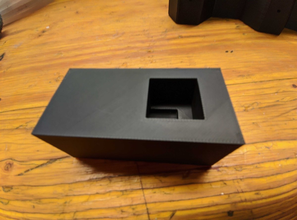

unforunately I still have problems with printing the top infills when printing big surfaces , as I get overextrusion and wavy surfaces there (in combination with a rumbling noise when the nozzle goes above...) strange is that I only get it at the top infills, when reducing the extrusion multiplier on the top infills  its ok. I also did some smaller testing bodies with bigger surfaces and cutout partitions and holes without problems even with 16 top fill layers.... has anyone an Idea as I'm running out of them (tried different cooling, temps, speed)
testcube with 16 top layers:

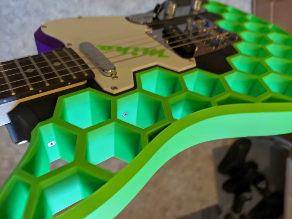

Well it's done now, and my son was very surprised and more than happy as I presented it to him today as he didn't knew about this project...

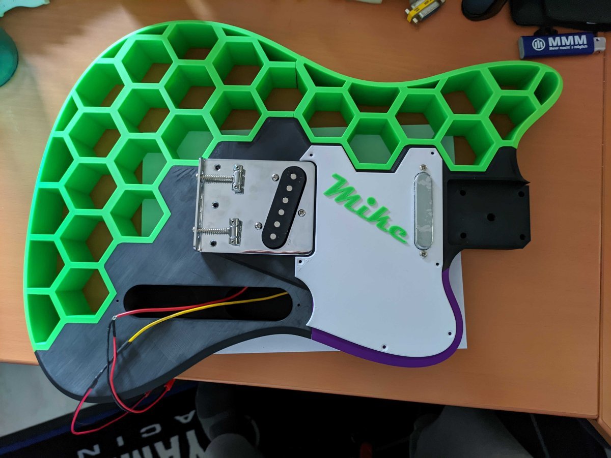

last building steps:

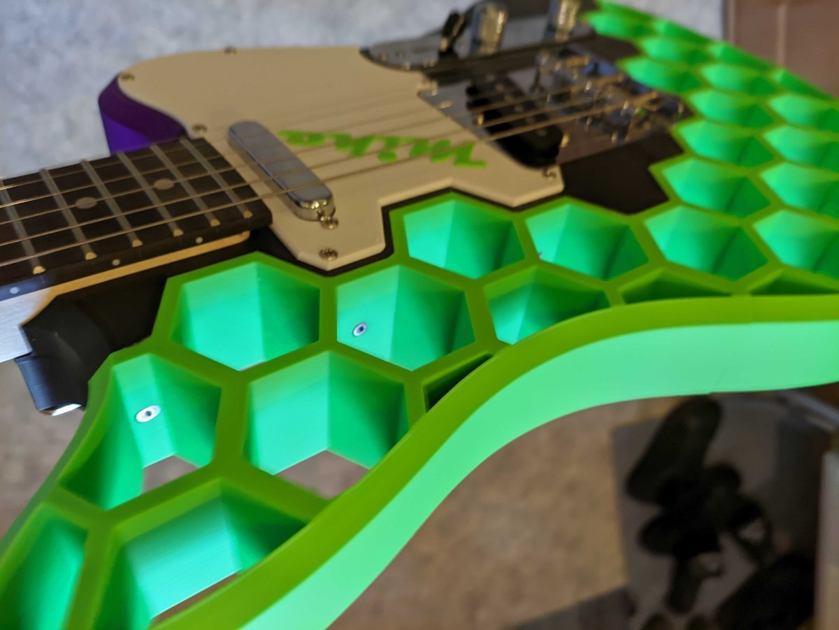

glueing all parts together with UHU Hart Kunststoff , as superglue (cyanacrylat) is not the best for ABS
most fiddling work was to insert the M3 screws inside the honeycombs, very time consuming job
after getting all screwed i inserted the strings and calibrated the ovtaves (harmonic vs pressed 12th fret) for all 6  strings, was pretty fast finished and worked good for one saddle modfies 2 strings.

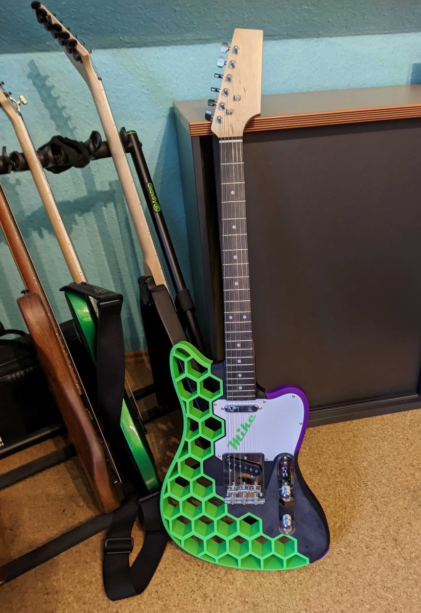

Well here's the final result
and a first soundcheck from my son, he was absolutely surprised as it sounds really good

Looks great!! And doesn't seems to have too bad of an action either.
Did you guys have any knowledge on adjusting/intonating instruments beforehand? I do ot, but i find it very fiddly.
Ps. Please cut the headstock to some sort of shape... hurts and ruins the aesthetics.😬

would say yes, I also played guitar for about 10 years in the past (also along with other instruments), so adjusting was done within 15mins, what surprised me alot. Seems it is important how you print the main body ( I used Esun ABS+ 7perimeters, 30% Gyroid Infill, 15 bottom / 16 top layers ), my printing Problem was that ABS seems to shrink and i had to reduce EM over the height, and the pei flex plate bent up, so I think it would be better to print it on a non flexible printbed..... Glass?
Next thing to mention is that the honeycomb parts are very sharp on the outside, so it scratches on the inner forearm, remixing these parts with rounded rims would be better
