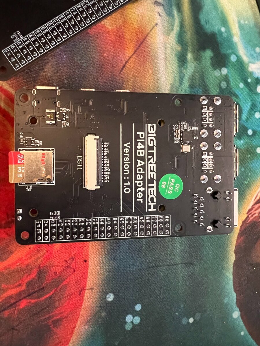

  1. BTT adapter for CM1/CM4 and tried the CM4 board (also not available anymore) but coudnt get it to boot.

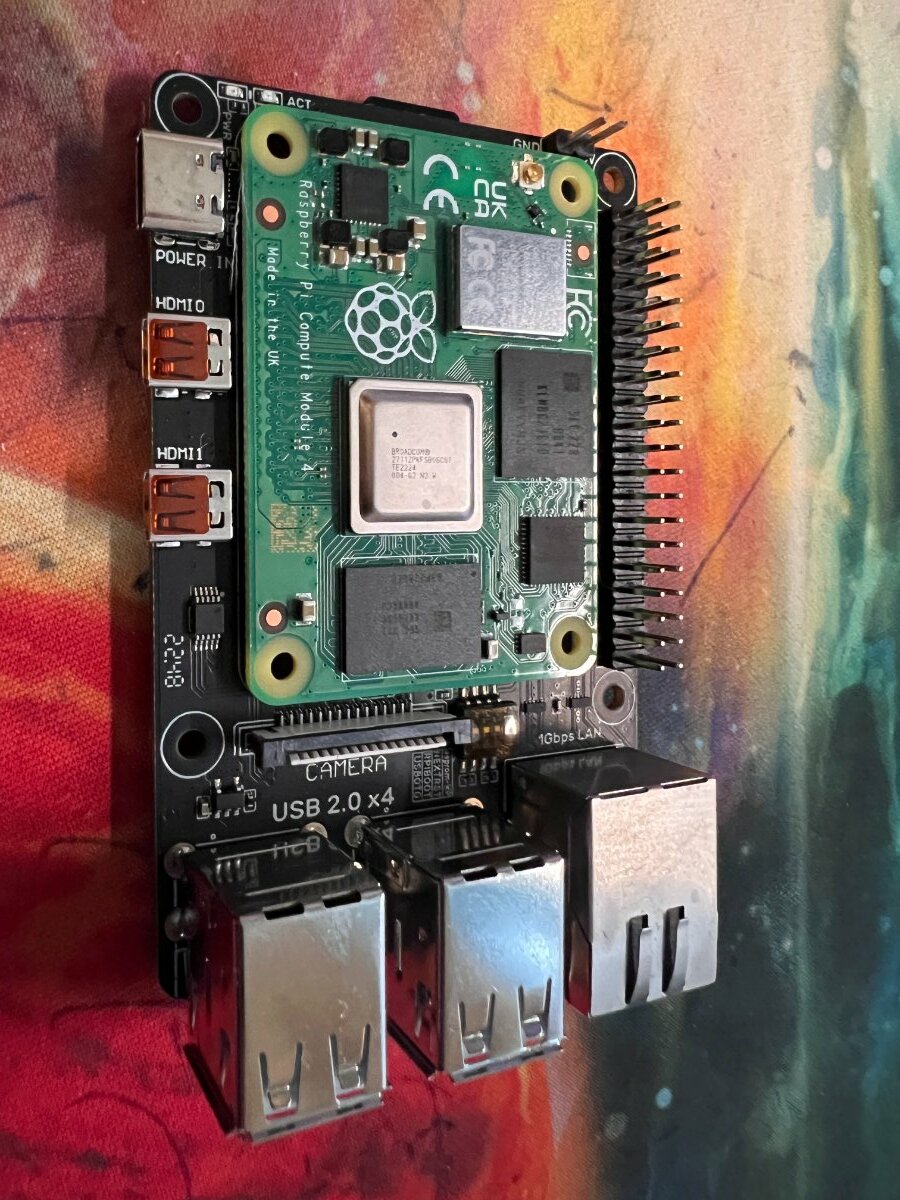

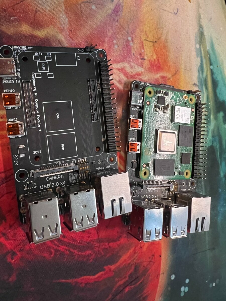

Yes, the manta board can hold a CB1 or CM4 onboard, but with the adapter, you can use it as a regular PI option.
No matter whats next to it.. I just coudnt get it to boot, maybe the CB4 is broken, I expect.. tried 2 adapters..
