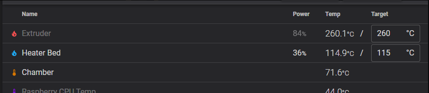

I own a 2.4 and nowdays a Trident 350.
I´m a bit surprised regarding the Chamber Temperature of the Trident.
I reach >72°C easy. Is that "normal" ? I use the hartk PCB V4 to measure.

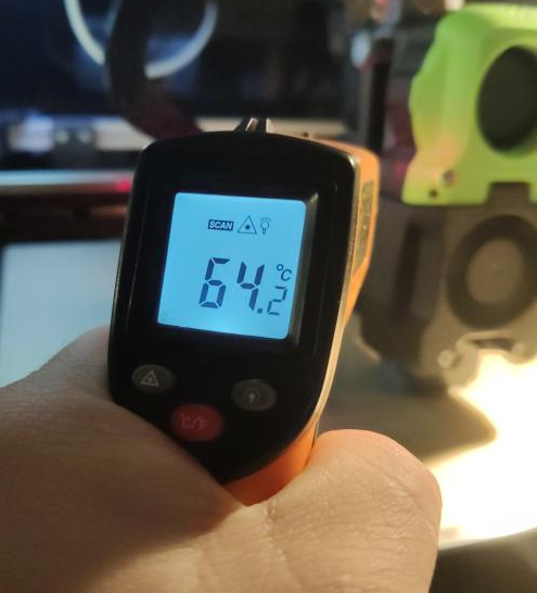

Temp of the X gantry after 30min ABS Print 260/115
