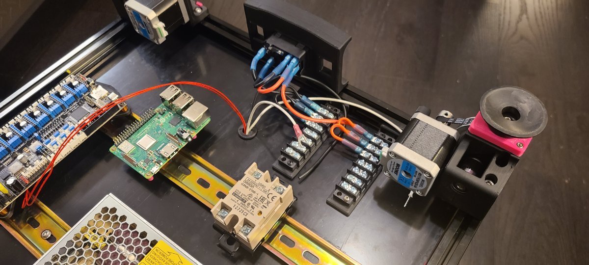

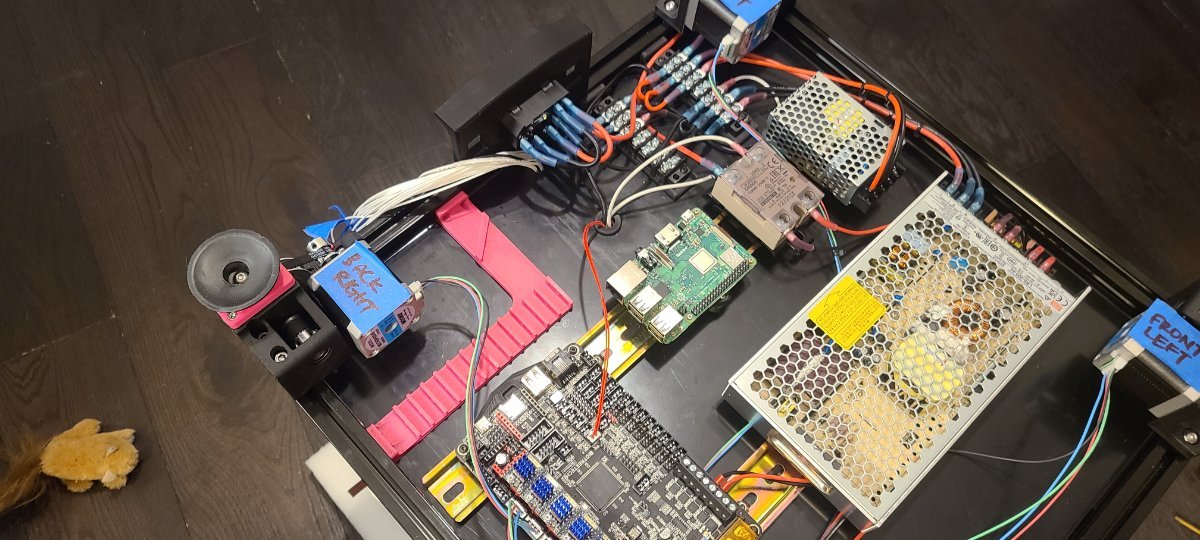

The video linked down below was amazing during my build. I was kinda building along with this guy, even though he was using the SKR boards instead of the octopus. I took a lot of the inspiration for my wiring from him. I attached 2 photos of my wiring as well.
