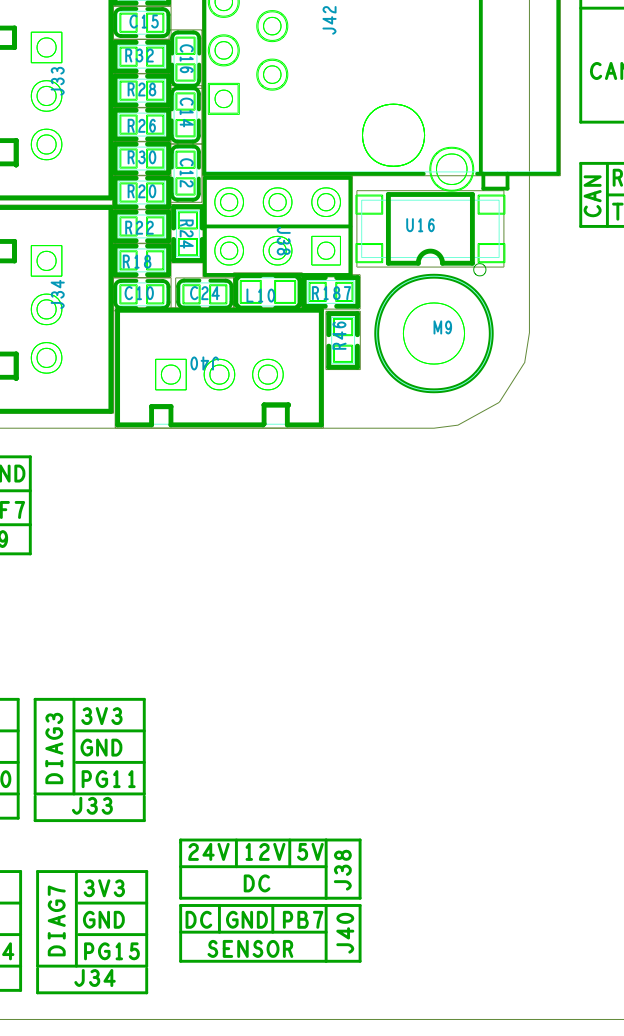

Yeah, I've been reading about those. I order the 5V OPB971N Sensor. Right now, I am in the process of wiring it up to my Octopus Board v1.0
I'm super cautious where to wire it up to. Still confused on where to exactly. If you have any advice let me know!

Wire it to the probe pin (J40), as you can set that to 5V through a jumper (J38).

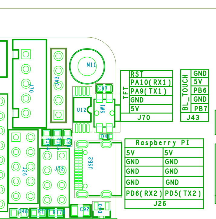

Or alternatively tot he BLTouch pin (J43)
Just make absolutely sure you have your wiring in the correct order
