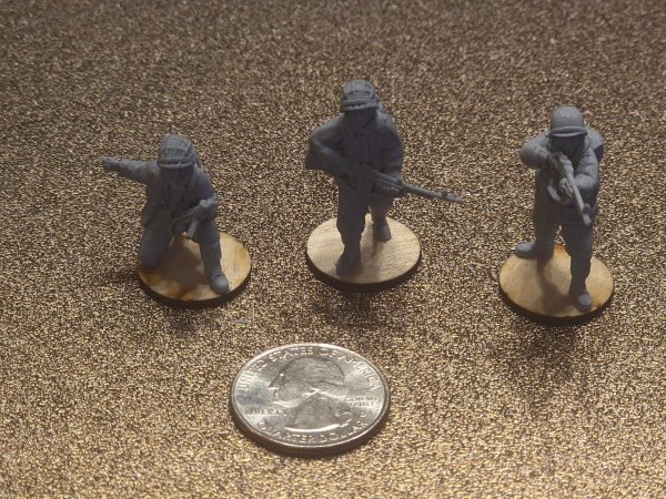

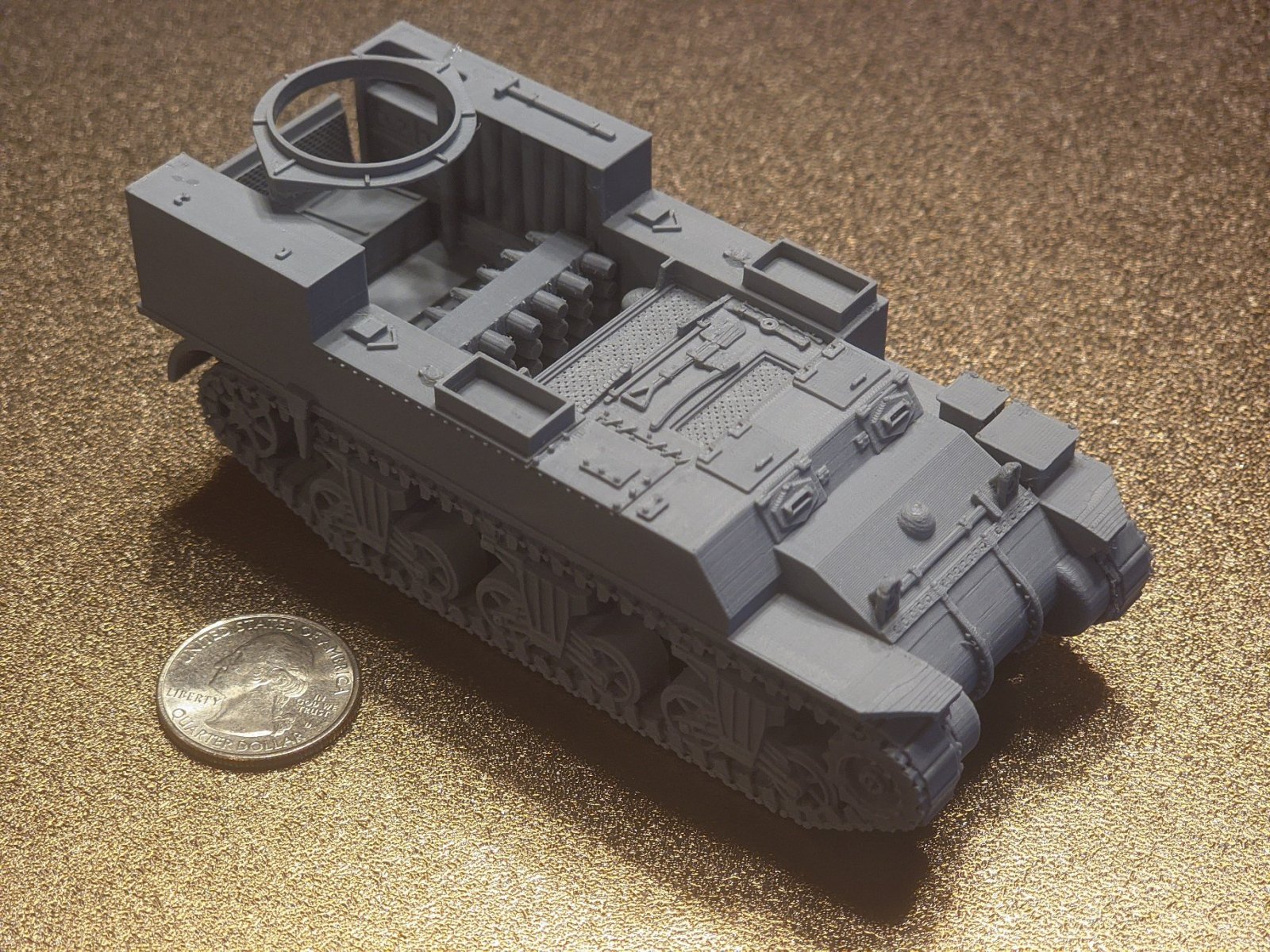

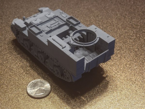

Demosth 1,530 Posted April 4, 2023 These are incredible quality! Out of curiosity, if you angle the print as they do for resin printing, work you get better results on the flat top surfaces? 1 Quote Link to comment
claudermilk 1,369 Posted April 5, 2023 Not really. Then you have layer lines and any Z wobble artifacts. My first tests before my settings got borked I tried with a pre-supported for SLA model. It eventually worked, but IMHO was not as good as this. The top surfaces after careful tuning are really good, and more than sufficient for the use case. These models would be placed on a 6x4 table top with terrain. You will normally be a couple of feet away from it. For this test I deliberately used the unsupported files and did paint-on supports. I saw Teaching Tech's recent video on supports and used some of that info. Well worth the watch--my supports are the best I've ever had them work. Quote Link to comment
