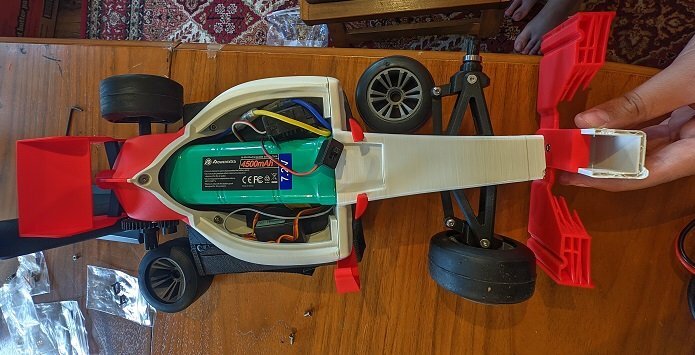

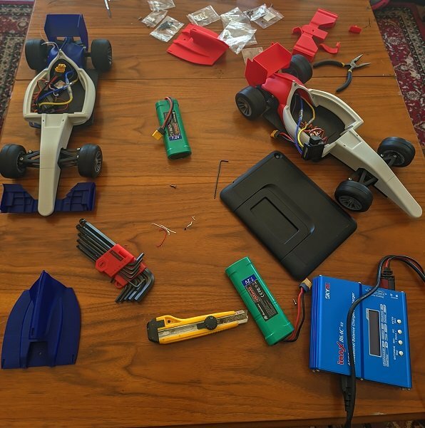

I threw some Google searches and found several others to try out. First up was the OpenRC F1 since it is the simplest one out there and I was also able to build with my son (yes, we built a pair of them).
So, the OpenRC F1
How it started:
How it went:

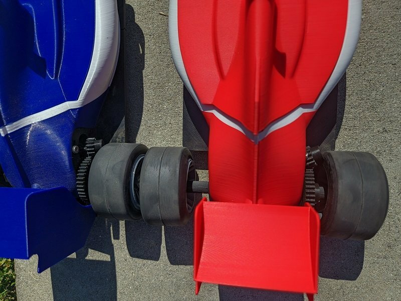

His first throttle hit was calibrated form the little kid RC cars. It went much faster than anticipated. Hopped off the curb and hit a tire. So the nose snapped and the wheels fell off. Since it is a printed project replacements were easily printed up and we both just laughed.

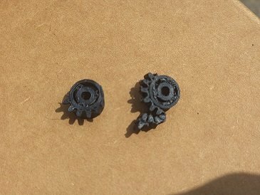

After the first real run we learned a couple of things. First, I had to glue to tires on the wheels as I suspected and PLA gears don't cut it, so they got replaced with ABS.
PXL_20220517_160722602.jpg.a8544c023ae875a0e90d067dffb09394.jpg PXL_20220528_143759314.jpg.d9b79741fe1c45f81f55087d982848fa.jpg
The cars have been running well since the initial problems.

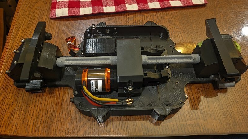

The new project is a Tarmo4. This is more complex with 4WD, a gearbox and two differentials along with a full suspension.
First day's build:
Second day's build:

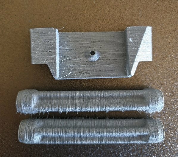

This also made me (well, gave me an excuse for) learning to print TPU.
The part aren't pretty, so I have more slicer tuning to do. But they will do the job. The use of TPU here is kind of genius. The driveshafts will twist on a sudden torque hit from the motor so things don't break. The lower front control arm mount will flex on an impact, also preventing things from breaking.
I'm just waiting on some electronics I forgot to order, then I can get it running.
