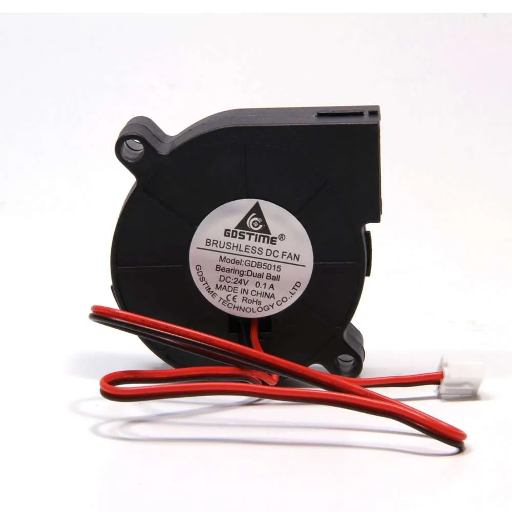

I use these 5015 fans under my V2 350 bed. I've set them up to run a 10% until the bed temperature is reached, then at 35%. I installed the open side facing the bed, at the front of the bed, and they exhaust towards the back of the printer.

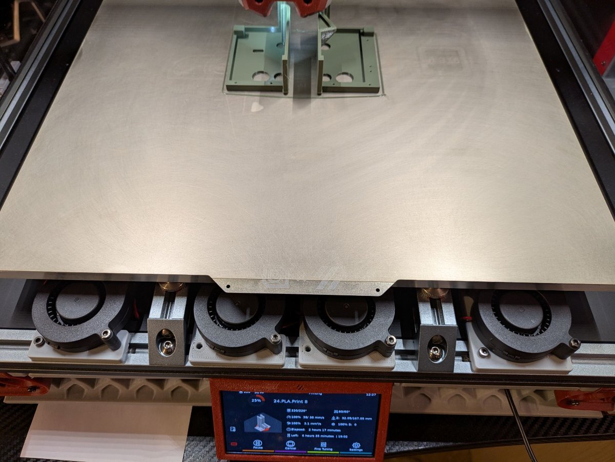

I am not sure how the bed frame works on that one moving and all that a look at the Ellis fan mod as is a simple fan mount for the 50 15 fans and make some mount near one edge if possible the 2.4 had them mounted just below the bed on the lower rail so was about the thickness of your finger below the bed and using ellis fan setup only came on when bed hit x temp and the percentages like pfarm said but like I said not sure how the switch wire works

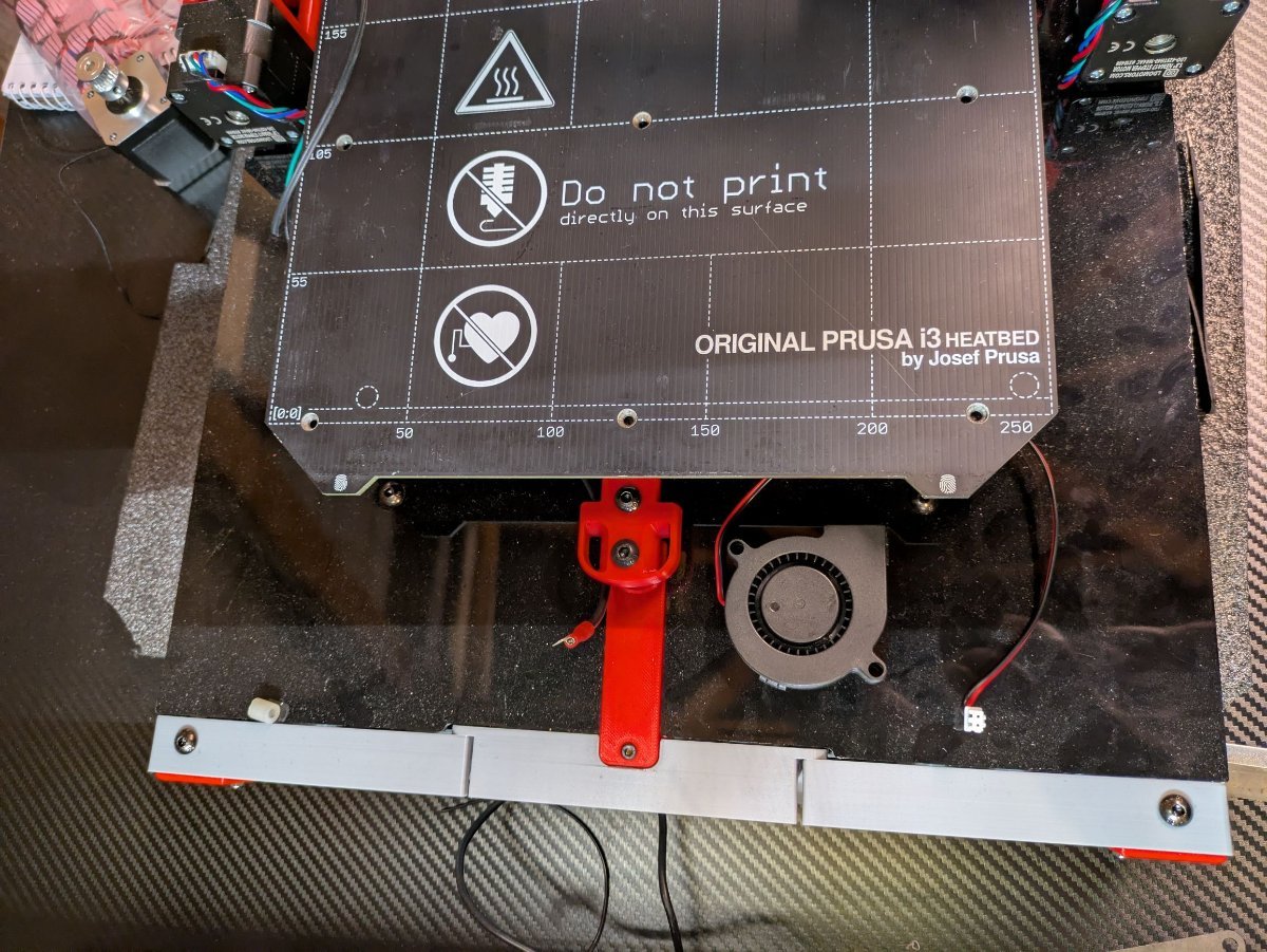

Ignoring the fact my SW is in bits - a 5015 blower fan to the left and right at the front should not have any clearance issues - bed frame is higher.
To test you could use double sided tape initially to see if it works well enough. For pre-heat after homing you could bring the bed forward to just cover the fan intake. Fan speed would have to be moderated to not overwhelm the 200w bed.PXL_20250509_112835067R.thumb.jpg.a130f2833425ad6fd25a1580d3624622.jpg
I have dropped in a picture of my 2.4 as an example of where those fans are located for airflow.
