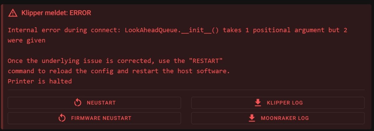

I'm having another error and can't find the file where I can change or check it. If anyone knows what the error is, I'd appreciate some tips. I'd also like to add that the error occurred after updating Happy Hare and Klipper.

This looks like its due to the latest klipper update and changes to the mmu_machine.py part of happyhare.
https://github.com/moggieuk/Happy-Hare/commit/9061cae96e15d3b91d2cf24649091cd2c71e4d53
You might need to reflash klipper firmware to your mainboard and MMB board.
Really whenever you get errors after an update you should try firmware reflashing all your boards.
