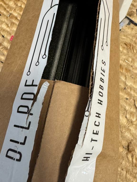

Frame - x545 x y545 x z760
Build volume - 300x300x300
2020, 2040 and 4040 extrusions machined by dllpdf mfg and powder coated in ground up fairie wings.
The extrusions  took quite awhile to receive due to high demand on a small company , they make really nice stuff so it was worth the wait.
